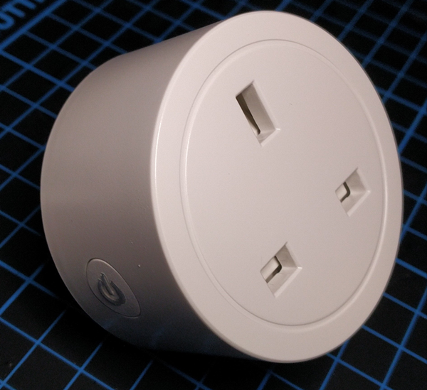

  • Tear down a BSD48 CB2S BK7231N UK smart plug with two button LEDs and a BL0937 energy monitoring chip.
  • Flashing required direct 3.3V/GND connection to the BL0937 chip, while TX/RX pads on the daughter board faced inward.
  • Soldering the inward-facing TX/RX wires was difficult, so a molten solder blob on the wire end was used for a quick attach.
  • The first opening was rough, and the re-closed plug looked horrible, though the CEN pad faced outward and caused no problem.
BSD48 CB2S BK7231N Sumart plug UK Tear Down
Contains two LEDs at the button (RED/BLUE) and has BL0937 Energy Monitoring Chip
My first attempt to open a such device was rough!
Flashing Setup:
1. 3.3V/GND direct to BL0937 chip
2. Since the TX/RX connections were facing inwards on the daughter board, getting two wires soldered was tough! What I did was hold a molten solder blob at the end of the wire and quickly place it as there was hardly any space for a soldering iron to do soldering.
This is how it looked through the small gap:
CEN was facing outside so no problem there,
Re-closed product looked horrible (not bad for my first attempt I suppose).
Configuration:

p.kaczmarek2 20 Dec 2022 20:43
Remember to do a voltage/current/power calibration later. Just like in Tasmota, with "VoltageSet", "CurrentSet", "PowerSet" commands. Can you provide the IO configuration for relay, button and maybe... [Read more]

ferbulous 21 Dec 2022 07:47
Hi, you could try applying some heat around the seal with a heat gun and gently lift it up with a thin knife. Might help with minimal damage teardown https://obrazki.elektroda.pl/7503813200_16... [Read more]
jkwim 21 Dec 2022 07:56
Thanks for the idea. Above was my first try :-) For a different plug I also tried a C-Clamp to gently push and loosen around the edges similar to what others have done using bench vise. After some... [Read more]
