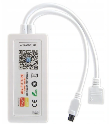

I will show here the interior, the firmware change procedure and the configuration of the Tuya AIP-Future TY-02-3CH RGB LED strip. I'll flash it with OpenBeken and then I'll also show you how to configure it to work with any supported IR remote. I will use IR receiver support and event handling system for this. This means that even an old TV remote control can be used to control it - anything with the more popular RC5, RC6 IR protocols will work.
I recommend reading the description of a related product:
[BK7231T] TY-02-1CH AIP-FUTURE WiFi single color WiFi LED strip WB3S
Buying an LED strip
I got the LED strip from one of the readers to upload the firmware and send it back to the reader (not everyone can and likes to solder well), but as far as I know, the strip is one of the most popular products in our country:
The controller costs PLN 45. This is the RGB version. In turn, the version for one color costs PLN 40.
NOTE: The set does not include the LED strip! The kit is quite cheap, but it's just the controller with the remote control, even without the adhesive tape to attach it.

The case is held on with a latch. It's easy to look inside.
And most importantly - the list of connections:
We have here:
- PWM5 - Blue
- PWM4 - Green
- PWM3 - Red
- PWM2 - Cool (not used here)
- PWM0 - Warm (not used here)
- RXD2 - first button
- P14 - second button
- ADC3 - microphone
We have two buttons here. One can be from power on/off, i.e. the usual role of Button in OpenBeken, and the other can be assigned the role of Button_NextColor (to switch colors) or Button_NextDimmer (to control brightness). We can also assign Button_NextDimmer to one and Button_NextColor to the other, and then additionally script one of them so that a double click switches the bar's power supply. The possibilities are great. How to add a button handler event? An example will be in the next paragraph.
