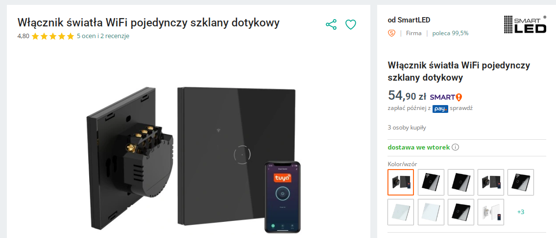

    Product purchase
    The product was bought in several pieces by one of our forum members, for whom I only changed the firmware in this switch (actually: in the switches, because I got some to rework) the firmware, so that he could connect them locally with HA. Thank you for sharing your play equipment. Below is a screenshot of the auction:
    WiFi light switch SmartLED 8044 with smartphone app shown, including price and online store availability details.

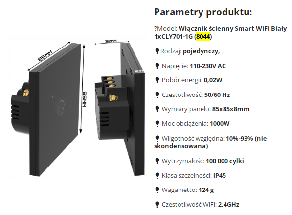

    PLN 54 is a good price for a product that we can get with free shipping (in the right package) within 2 days, even at a parcel locker. We also have a choice of color here, as well as a similar version with 2 or 3 buttons.
    The model name is 1xCLY701-1G or 8044.
    parameters:
    Visualization and technical specifications of the Smart WiFi wall switch model 8044 with dimensions and a list of features.

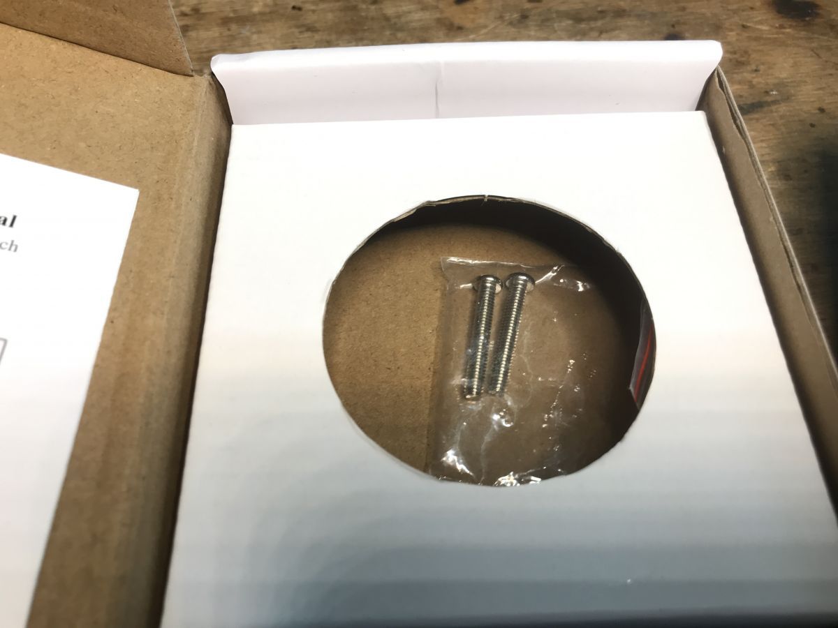

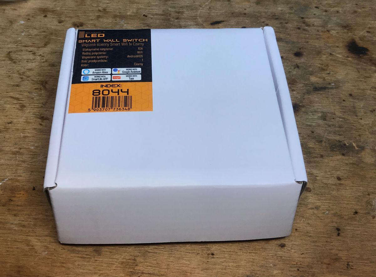

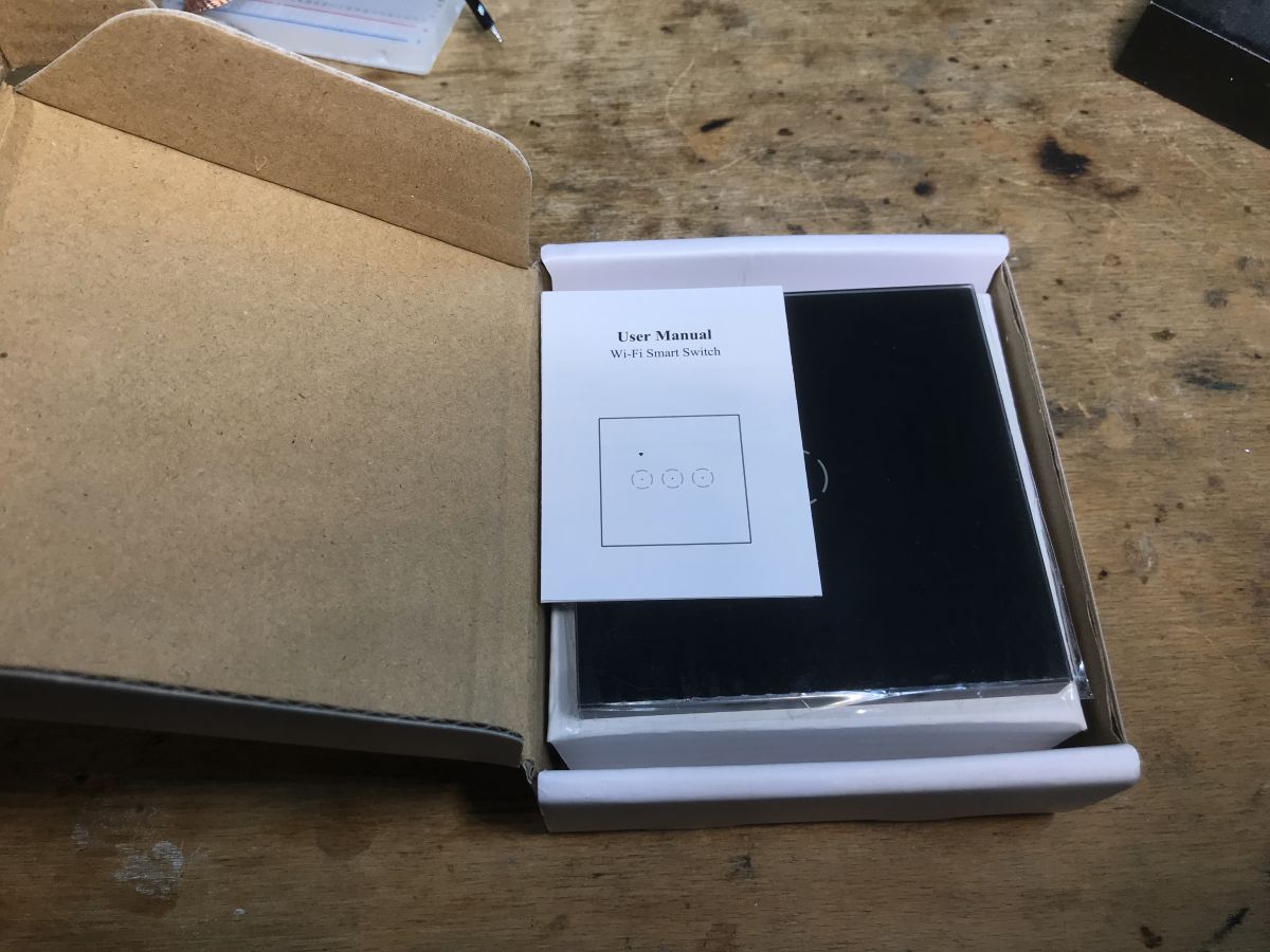

    Let's see what we get in the kit:

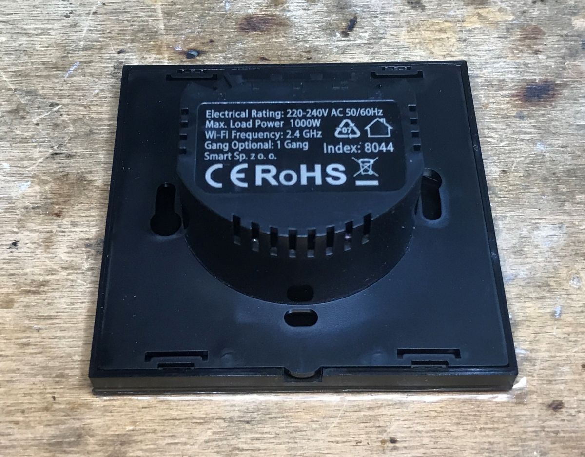

    Two mounting screws in a plastic bag placed in a cut-out section of a cardboard product box. A white box with a label for the Smart LED wall switch model 8044 sits on a wooden surface. An open box with a user manual and a glass WiFi Smart Switch panel inside.
    there are screws for mounting - and the switch:
    Black back side of the SmartLED 8044 WiFi light switch with technical specifications visible.

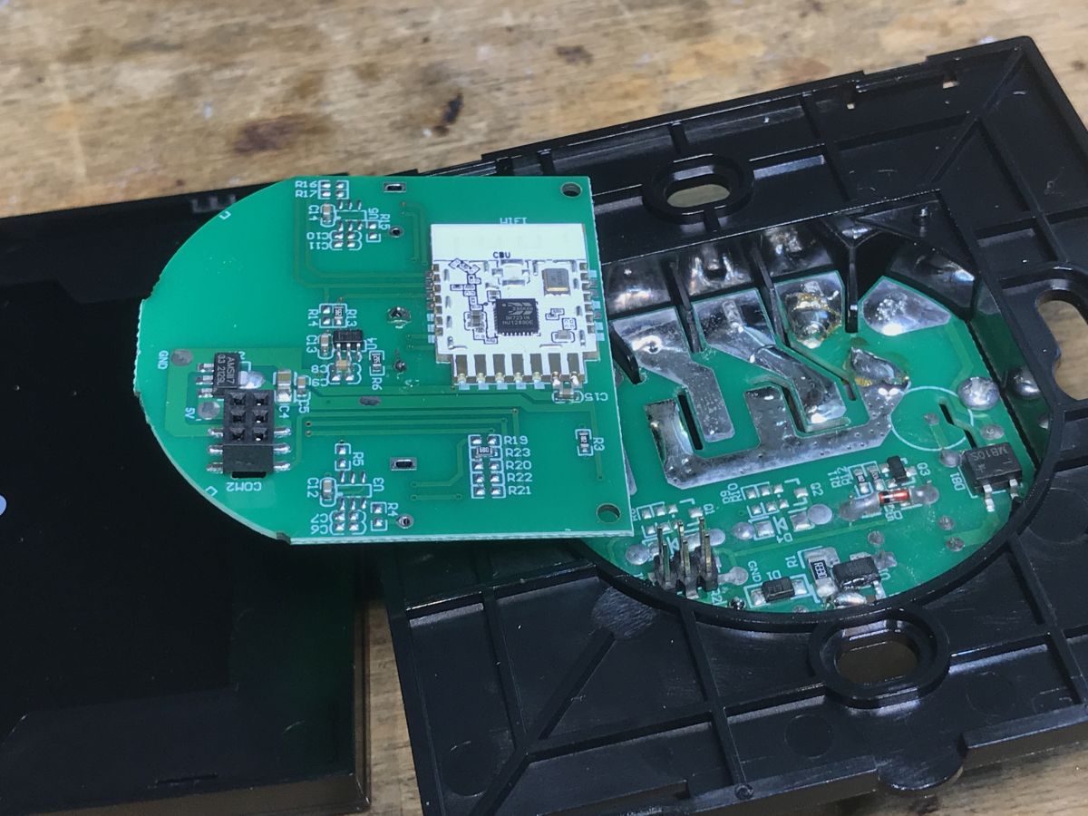

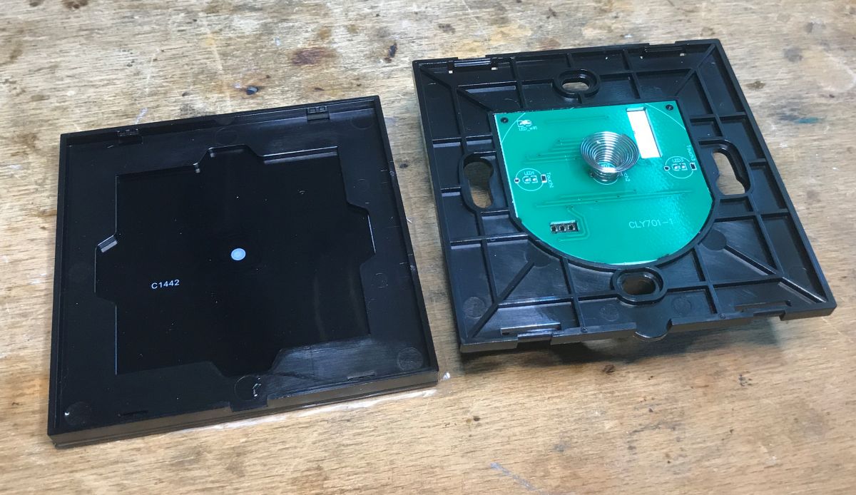

    We undermine the front:
    Open SmartLED 8044 light switch case with PCB and touch coil visible inside.
    Printed circuit board of the SmartLED 8044 WiFi switch module with visible electronic components.

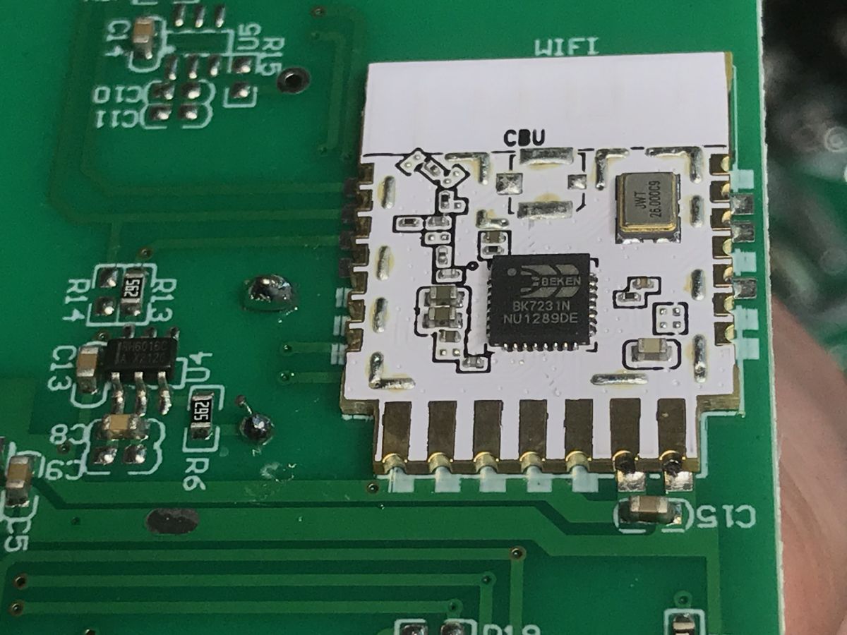

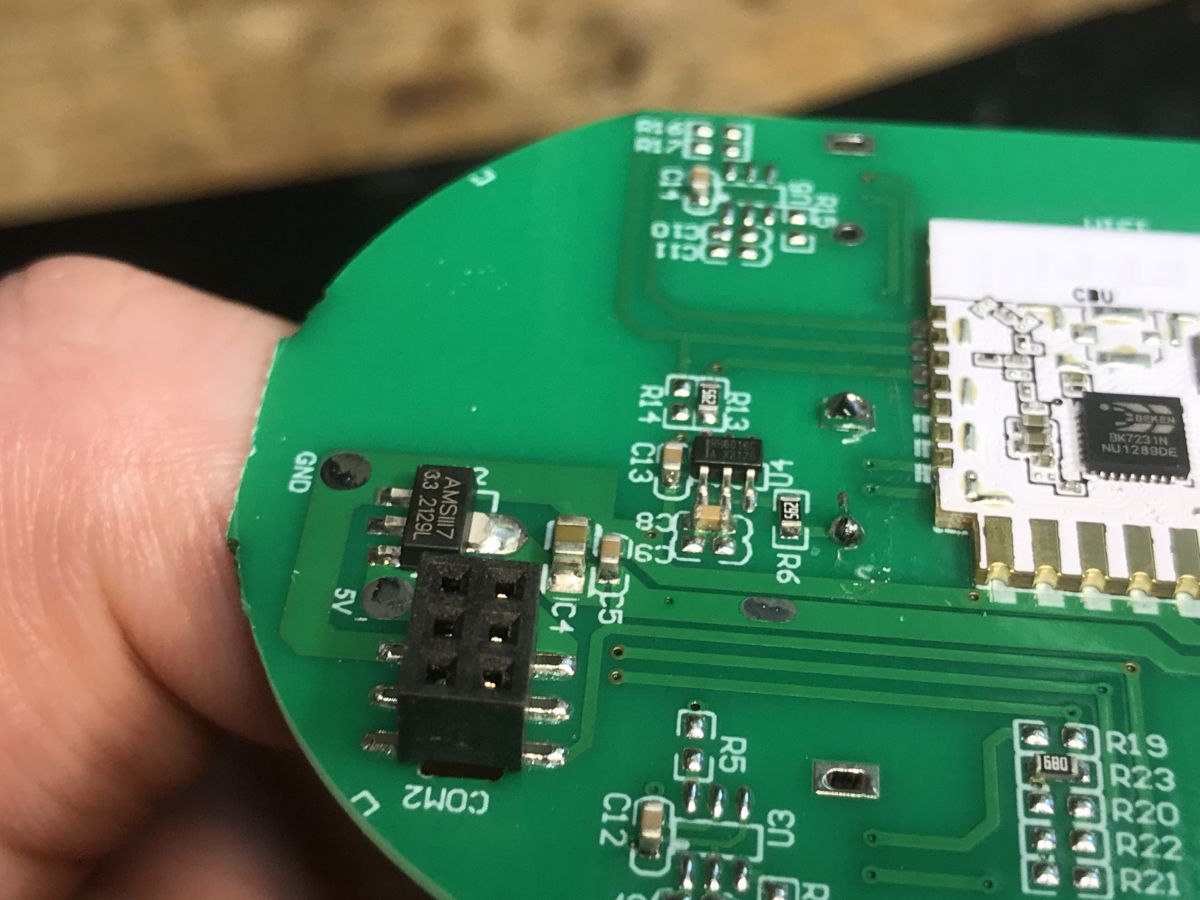

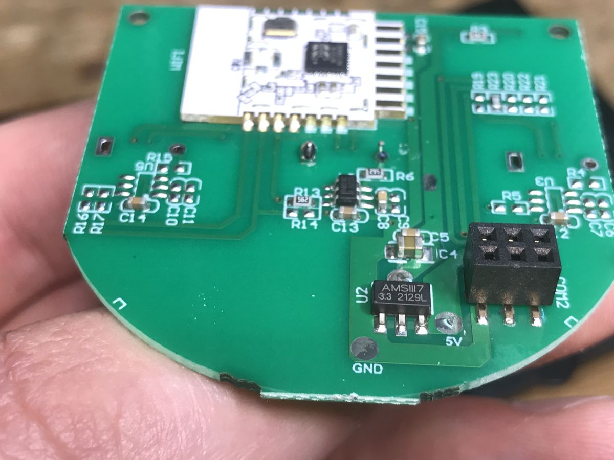

    Inside there is a CBU - a module based on the BT/WiFi BK7231N chip:
    Here is its specification:
    https://developer.tuya.com/en/docs/iot/cbu-module-datasheet?id=Ka07pykl5dk4u

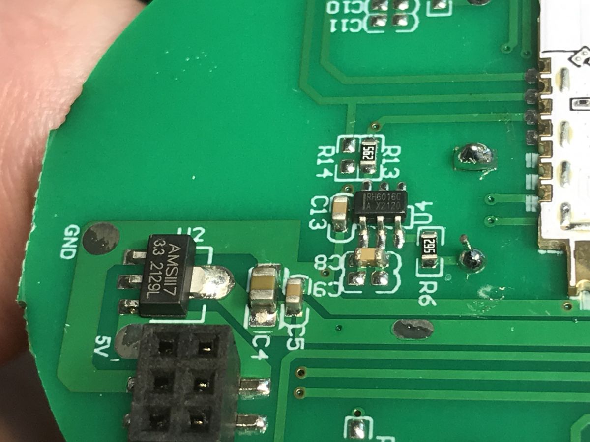

    Close-up of a green PCB section with AMS1117 3.3V voltage regulator, pin header, and RH6016C chip visible. Close-up of a PCB with AMS1117-3.3V voltage regulator and a pin header, detailed view. Close-up of the SmartLED 8044 light switch PCB with visible connector, AMS1117 voltage regulator, and CBU module with BK7231N chip.
    On the board I also see AMS1117-3.3V, which converts 5V to 3.3V for the WiFi module, and a touch button controller, RH6016C.
    Connection diagram of the RH6016 touch sensor circuit with S8050 transistor and LED.
    You can also see places for two more circuits for the other two touch buttons.

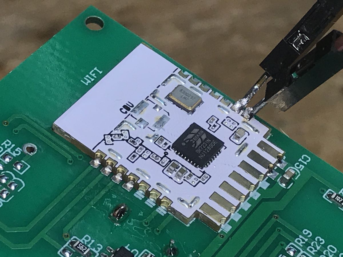

    Here is the CBU itself, even without looking at the Tuya documentation, you can guess where the power is, you can see the 100nF SMD decoupling capacitor:
    CBU module with BK7231N chip on the SmartLED 8044 switch PCB.

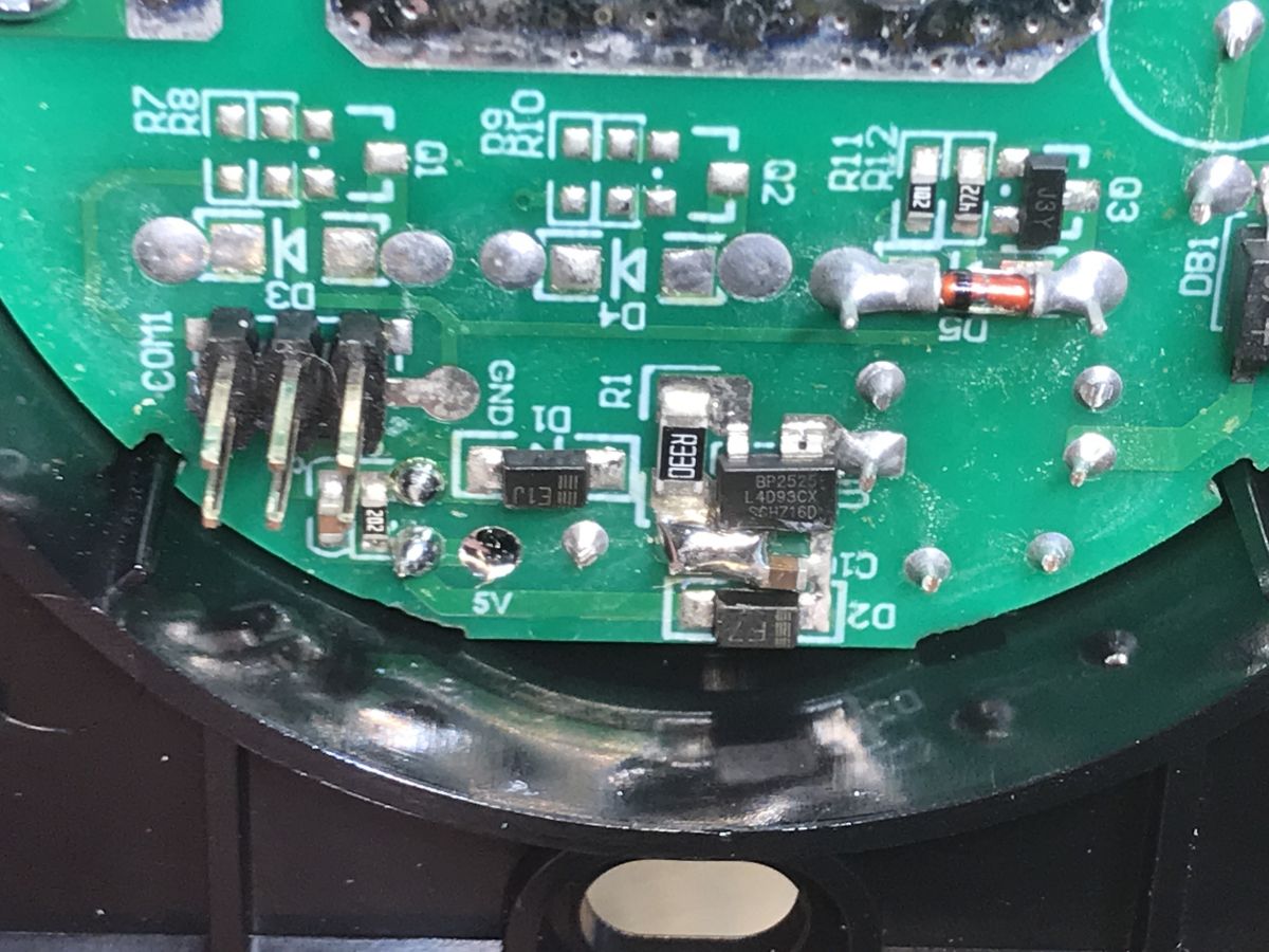

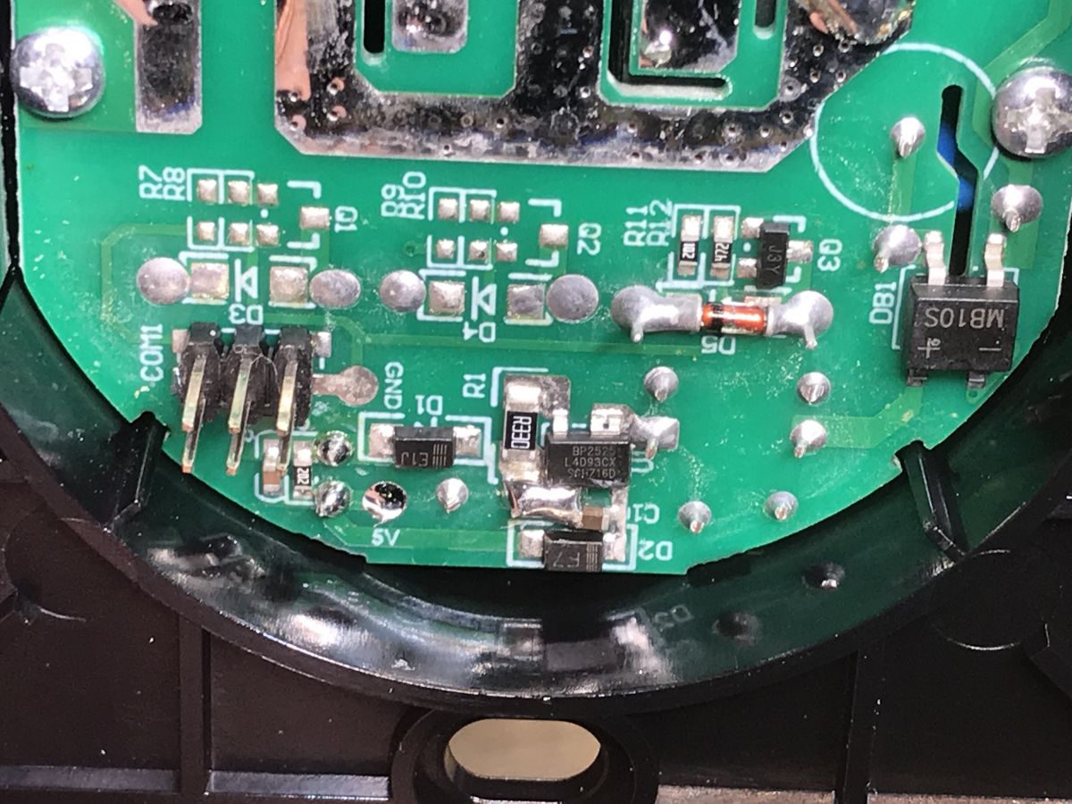

    And a glance at the power supply - we have a BP2525 power supply here again. The photo also shows one of the three relay transistors, SMD code J3Y.
    Close-up of a PCB segment in the SmartLED 8044 switch, showing pins, SMD components, and labeled connections. Close-up of the SmartLED 8044 light switch PCB, showing connectors, SMD components, and pin labels.

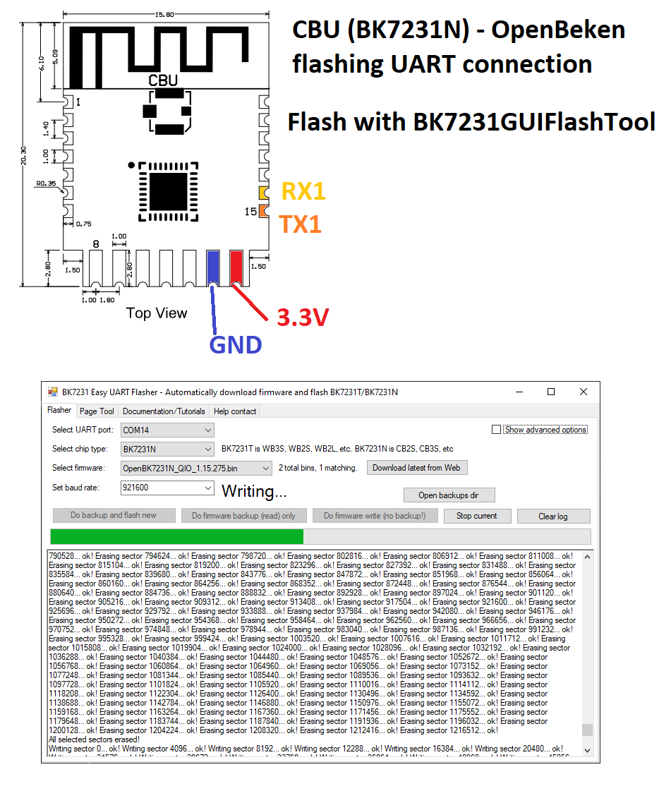

    Firmware change
    We're playing OpenBeken , it will provide us with a Tasmota-style experience and compatibility with its ecosystem (to some extent), compatibility with its JSON format, some commands, and with the Tasmota Device Groups system. We flash with the flasher, through the converter to USB and UART, according to the readme:
    CBU pinout we have here:
    In addition, I made a graphic showing what and how to connect:
    Diagram showing CBU BK7231N UART pin connections and a screenshot of firmware flashing with BK7231GUIFlashTool.

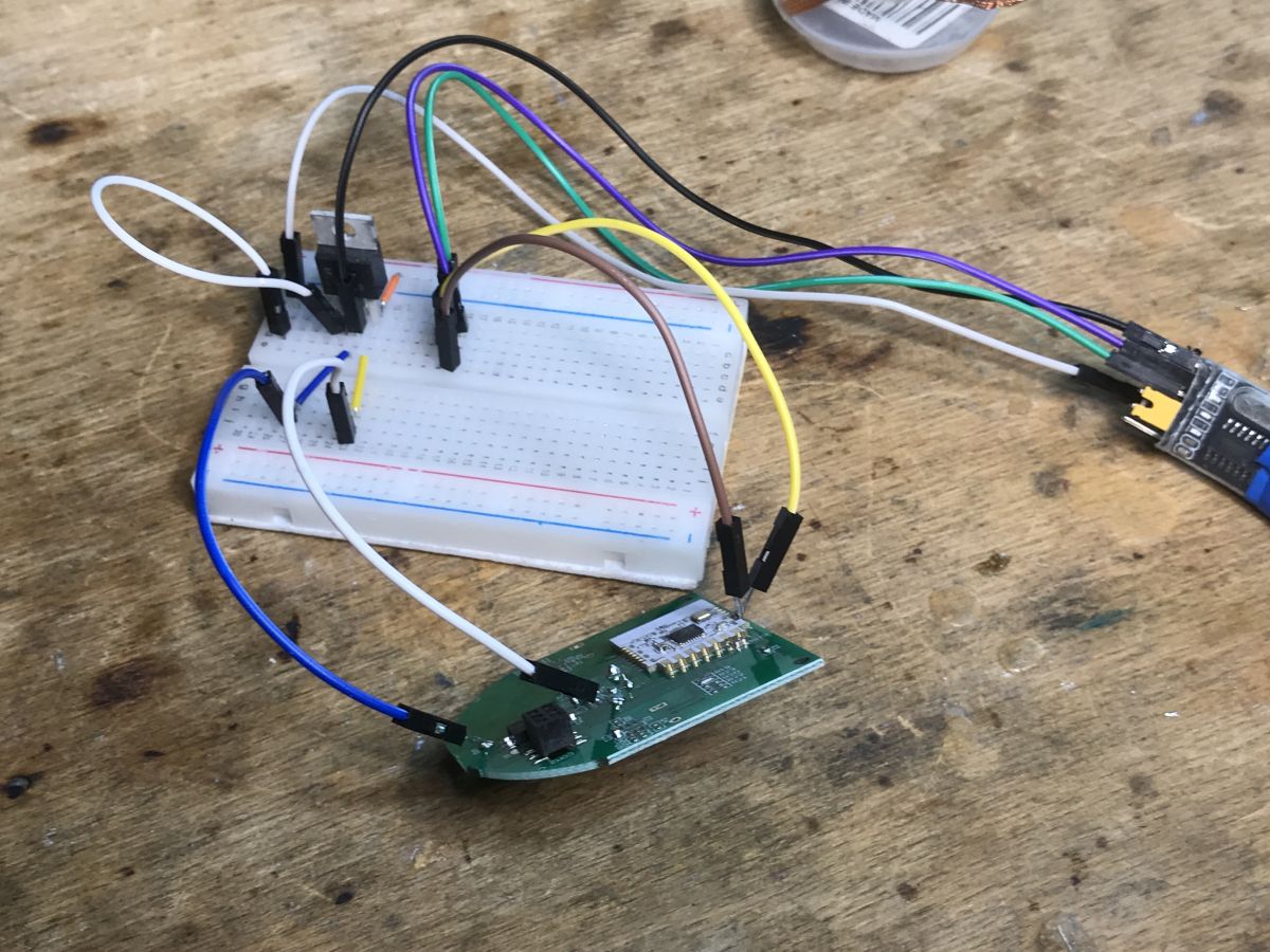

    This flasher can download the latest OBK release by itself. We just solder 3.3V, GND, RX and TX, perform a power cycle and wait for the end of the upload.
    Close-up of a CBU WiFi module with BK7231N chip soldered to a PCB and wires connected for programming. SmartLED 8044 relay board connected to a breadboard and programmer via jumper wires.
    There is no philosophy here, no blocked RX/TX line, no TuyaMCU, no need to desolder anything, no problems.
