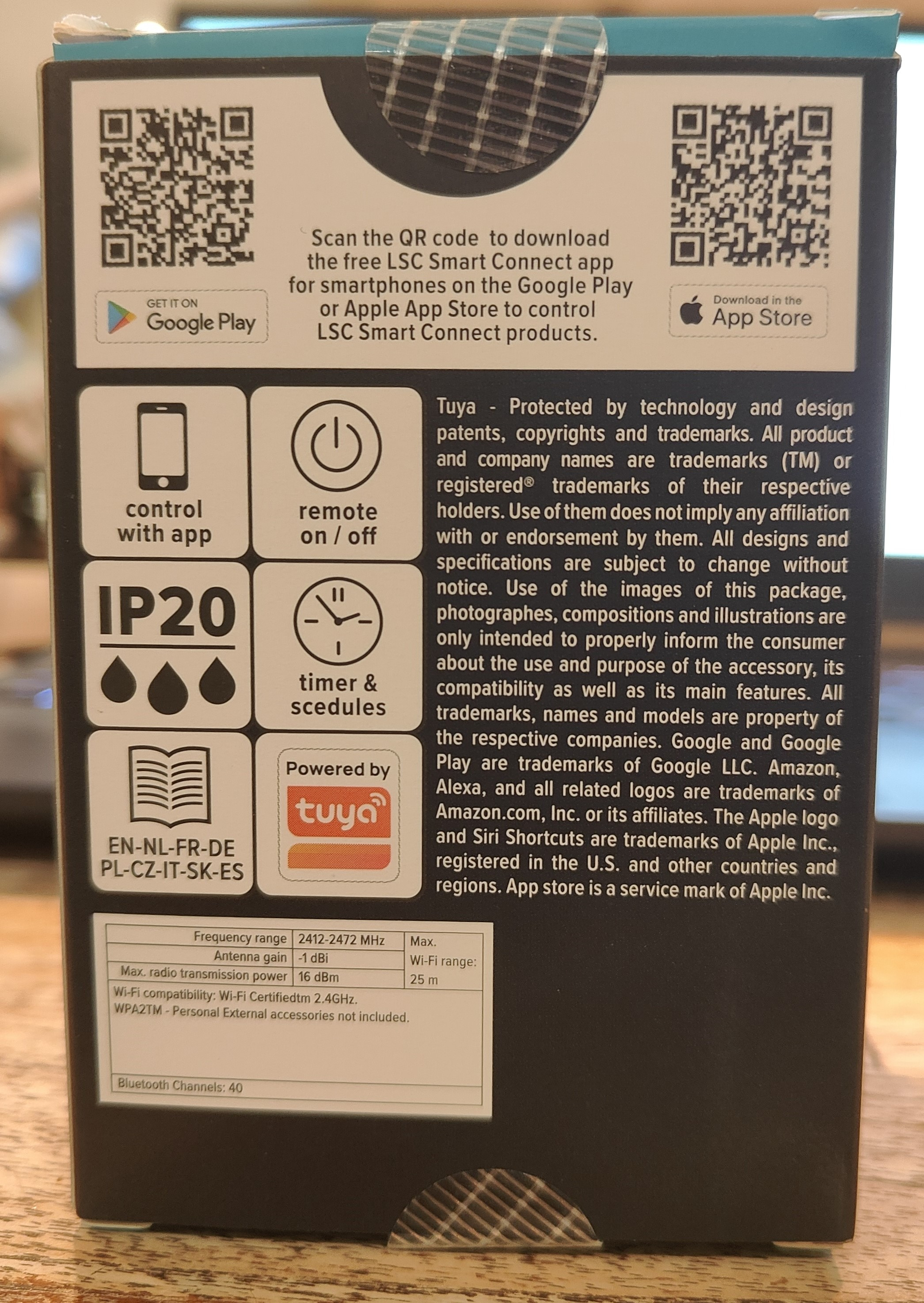

This is the LCS Smart Power Plug Article number: 2578685.
I got acquainted with ELEKTRODA as I bought this plug, hoping it contained an ESP82xx. Well, I got disappointed (again); this unit doesn't have an ESP82xx. As this was the 6th unit I ordered not contain an ESP82xx, I figured. Is there a replacement? And yes, there was. @p.kaczmarek2 has been a great help, and I am pretty happy with the updates and changes he committed to the code.
Well, let us start again;
Unpacking:
The unit comes in a little square box
