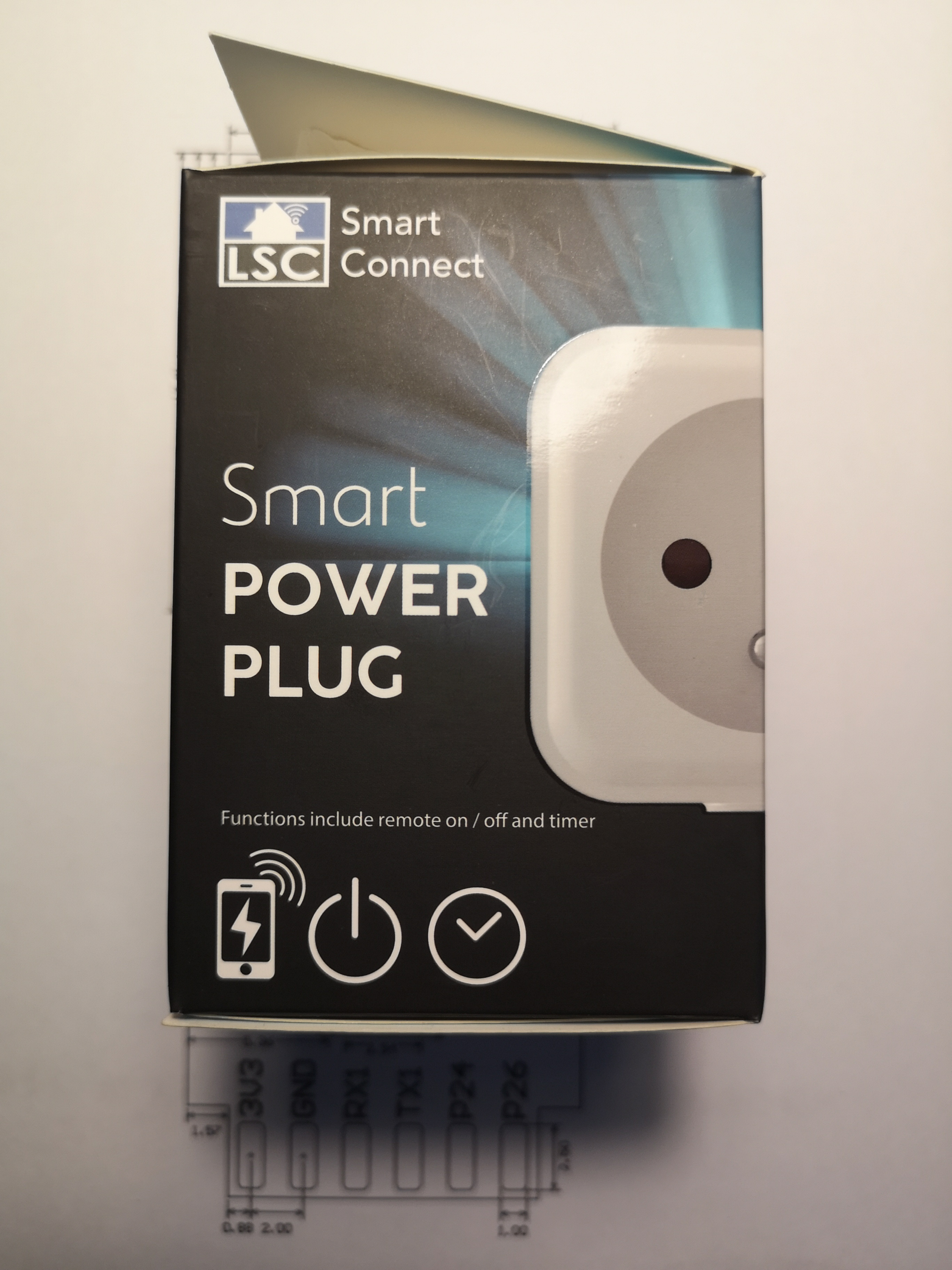

Last summer I bought a socket in the action store:
Now is the time to disconnect from the cloud. It took a while, but I found descriptions of how to do it without disassembling the device and soldering the wires.
I took advantage of https://github.com/tuya-cloudcutter/tuya-cloudcutter and https://github.com/openshwprojects/OpenBK7231T_App
I used the existing configuration for the LSC Smart Connect Plug and the socket works without internet connection.
Unfortunately, not everything was as in the original. I had only one blue LED for this, which should indicate the WiFi connection and indicated the activation of the relay.
