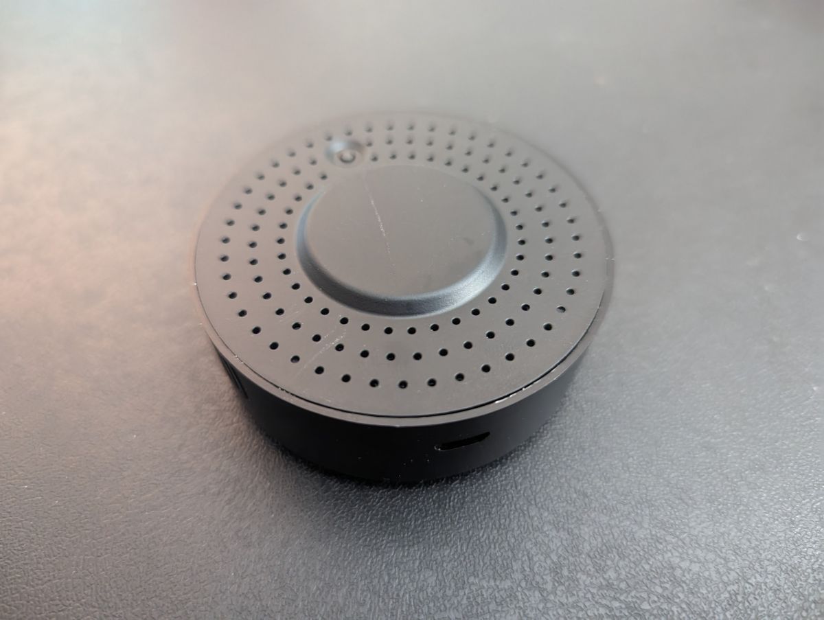

  • Opened a Temu generic Wi‑Fi IR remote control sold as IRC02, with a box manual for SRW-001 and a chassis similar to the Aubess WiFi Smart IR Controller.
  • Found a CB3S module with a BK7231N inside; the TXD, RXD, GND, and 3V3 pins were easy to access for flashing.
  • Flashed OpenBK7231N_QIO_1.15.384.bin using an ESP-12E development board and direct serial wiring, with TXD-to-TXD and RXD-to-RXD.
  • Used pin settings 6, 7, 24, and 26 for Btn, LEN/WifiLED, IRRecv, and IRSend; the IR worked only after saving settings and rebooting.
Photos:
Bought the device from Temu.

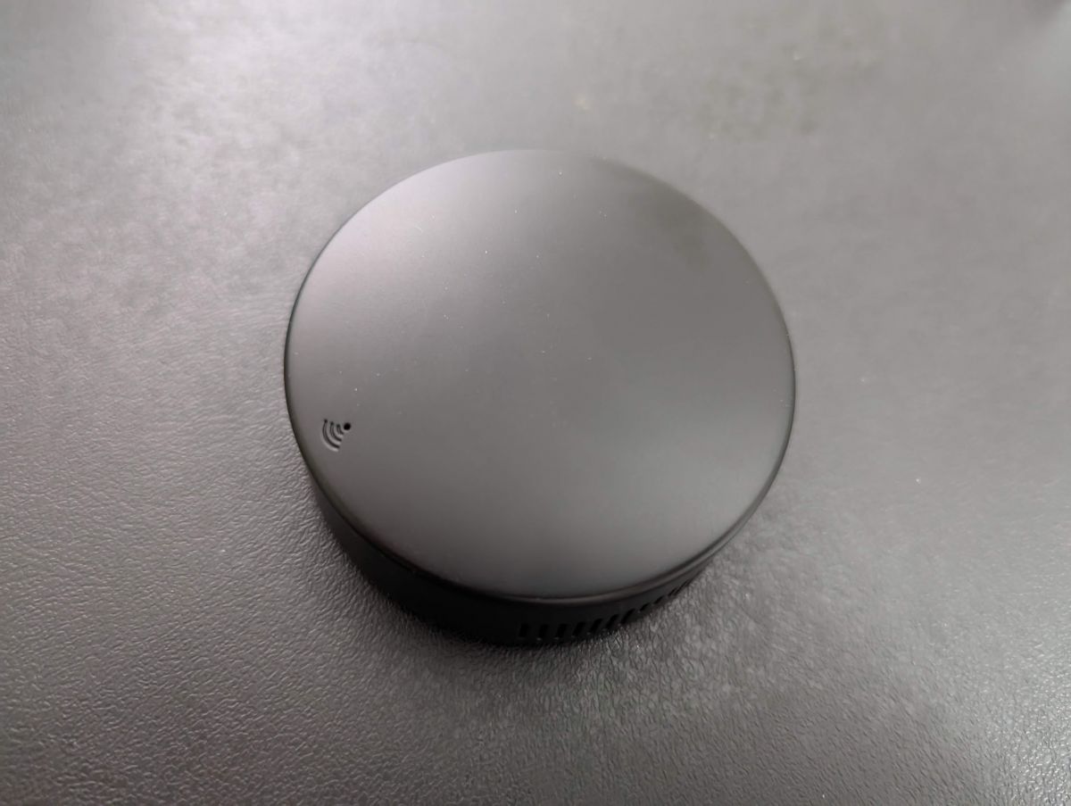

The product image shows a model number of IRC02. The manual in box was for SRW-001, but the schematic looks like a different product. Although the chassis seems to be the same as Aubess WiFi Smart IR Controller, the internals are quite different.
There are four tabs holding the two pieces of outer shell together. Once opened, the board can be taken out directly. The chip used is CB3S which is a BK7231N. The TXD, RXD, GND, and 3V3 pins are easily accessible.
For the flashing, I repurposed a ESP-12E development board by grounding the EN pin and then connecting TXD, RXD, GND, and 3V3 directly to the testpins on the IR remote board (Note: TXD to TXD and RXD to RXD. Not the other way around). The onboard USB to TTL chip was a CP2102 and requires drivers from Silicon Labs to work. The firmware used is OpenBK7231N_QIO_1.15.384.bin
