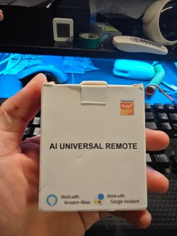

  • #10 20800260
    thanhli113
    Yes, I have a raspberry 4 with homebridge and homepod mini installed. Photo of AI Universal Remote packaging with Tuya logo, works with Amazon Alexa and Google Assistant.
    This is my device.
    I flashed the latest version of Openbk but don't know how to add it to Homekit, pls help me
