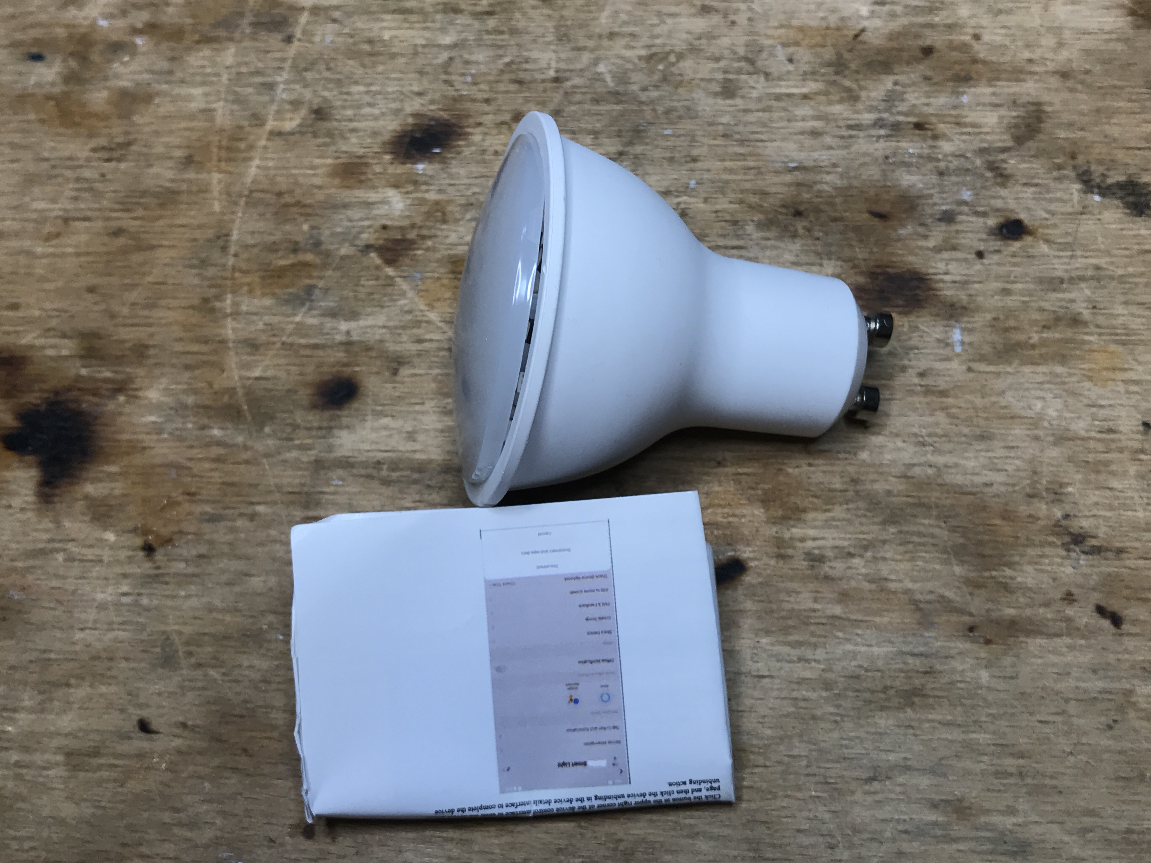

Hello, I will present here the inside of the product known on the web as based on ESP8266, but in newer versions based on the BK7231T module, more precisely on WB2L. The lamp this time with a GU10 standard connector. It will also show here the procedure for changing its firmware. This time the programming pads from the WiFi module will be exposed, so you can change the batch without desoldering the entire module. Attention - I suggest all readers to read the first topic in the series:

Purchase of the Fcmila smart spotlight

This is what the packaging looks like:
Kit Contents:
The product had a broken lid right out of the package. Didn't the manufacturer shut it down?
Instruction:
Fcmil interior
The milky cover is enough to pry with a knife and we have access to the LEDs:
