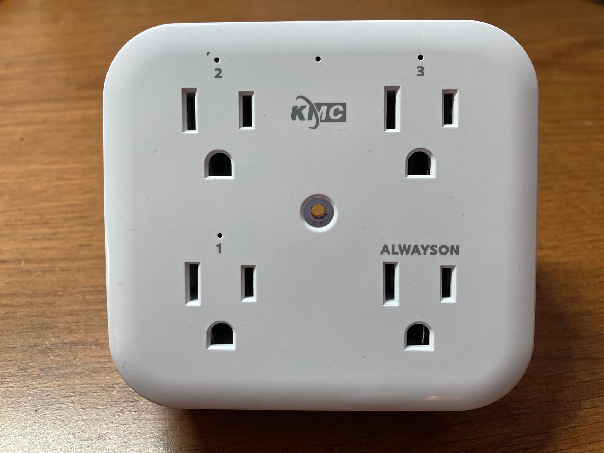

  • KMC Smart Tap Mini is torn down and its CB2S module is prepared for BK7231N-style flashing.
  • Remove 4 rear screws, pry off the friction-fit plate, take out 2 board screws, then desolder the CB2S chip for serial access.
  • The chip connects with 3.3 GND TX and RX, and the pin map lists P6 (PWM0) for Rel 5, P24 (PWM4) for Rel 0, and P26 (PWM5) for Rel 2.
  • The onboard circuit interferes with chip flashing, and careless removal can damage the pads; a capacitor or other part might also need removal.
Remove 4 screws from back.
plate appears to be clipped in place but its not. only friction holds it on.
use something to gently pry along the edge and lift over the plug.
remove the 2 screws from the circuit board and take it out of the case.
remove the CB2S chip from the board with a soldering iron, and solder wick or a heat gun.
careful not to damage the pads as shown in the photo
circuit interferes with chip flashing.
it might be possible to remove a capacitor or other component for same affect
Pins on CB2S chip are clearly labeled.
attach serial programmer to 3.3 GND TX and RX as usual.
Flash chip and reassemble.
Pin configuration
P6 (PWM0) Rel 5
P11 (TXD1) WifiLED_n
P24 (PWM4) Rel 0
P26 (PWM5) Rel 2

p.kaczmarek2 17 Feb 2023 23:21
Hello, your configuration specifies 3 relays and WiFi led, but the device seem to have 4 relays. Is your configuration complete? It is also worth to note the device marking: - Model 30407 - FCC ID... [Read more]

p.kaczmarek2 07 Nov 2023 23:18
Tuya-cloudcutter works per device build and profile may not match if Tuya has changed something or updated to newer version. What's your device version according to Tuya app? I did SWP86 teardown and... [Read more]

omniron 28 Nov 2023 03:14
I was unable to flash OTA! Tried all options. So I opened the unit and was finally able to get the flash. Attached is the 2MB flash. I made a schematic of the logic part, to see if the stupid CB2S... [Read more]
p.kaczmarek2 28 Nov 2023 17:51
Thank you, this schematic is very informative. I'll see what I can do about OTA for that device and reply here again. If I don't reply, please remind me. Added after 7 [hours] 9 [minutes]: The... [Read more]
