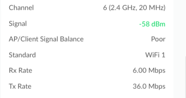

  • FEIT Smart WiFi Light Strip FETAPE/RGBW/CNTRSC on BK7231N was torn down and mapped for OpenBK/CloudCutter.
  • RGBW mode needs flag 24 in the native interface; the web app misreports status, and the BLE wireless remote still does not work.
  • The working pin map is 6=PWM;4, 7=PWM;2, 8=PWM;1, 9=PWM;0, plus 26=Btn_SmartLED;0, with no signal on pin 24.
  • Flashing through RX1, TX1, GND, and CEN worked without desoldering, and the 1.0.9 OpenBK update notably improved Wi‑Fi performance across five devices.
This teardown is complete.

As a note, this firmware significantly improves the WiFi performance of these light strips. This is consistent across all 5 of the devices I have updated so far - and the comparison is striking. The performance of the updated devices versus their historical performance and the current performance of the 4 remaining devices I have not yet flashed tells an interesting story. This is not anecdotal improvement - I have the historical performance data to prove it. (I have Unifi APs and a UDM Pro, which keeps device performance history.) The FEIT stock firmware is definitely nerfing the WiFi transmit strength. With the stock firmware, a device that's only 4 meters from a Unifi U6LR (Long Range model) shows fair performance, and a AP/Client Signal Balance of 'poor.' After flashing OpenBK, that same device now shows excellent performance and the AP/Client Signal Balance is 'good.' Here is a comparison of one Tuya Stock device and one OpenBK device - right next to each other:
This is consistent across every one of these devices I have flashed. They have all switched to WiFi 4, good signal balance, and higher speed connection. (Note that I have only seen this improvement on this 7231N device. I also have some FEIT 7231T smart plugs and A19 bulbs that did not improve like this.)
