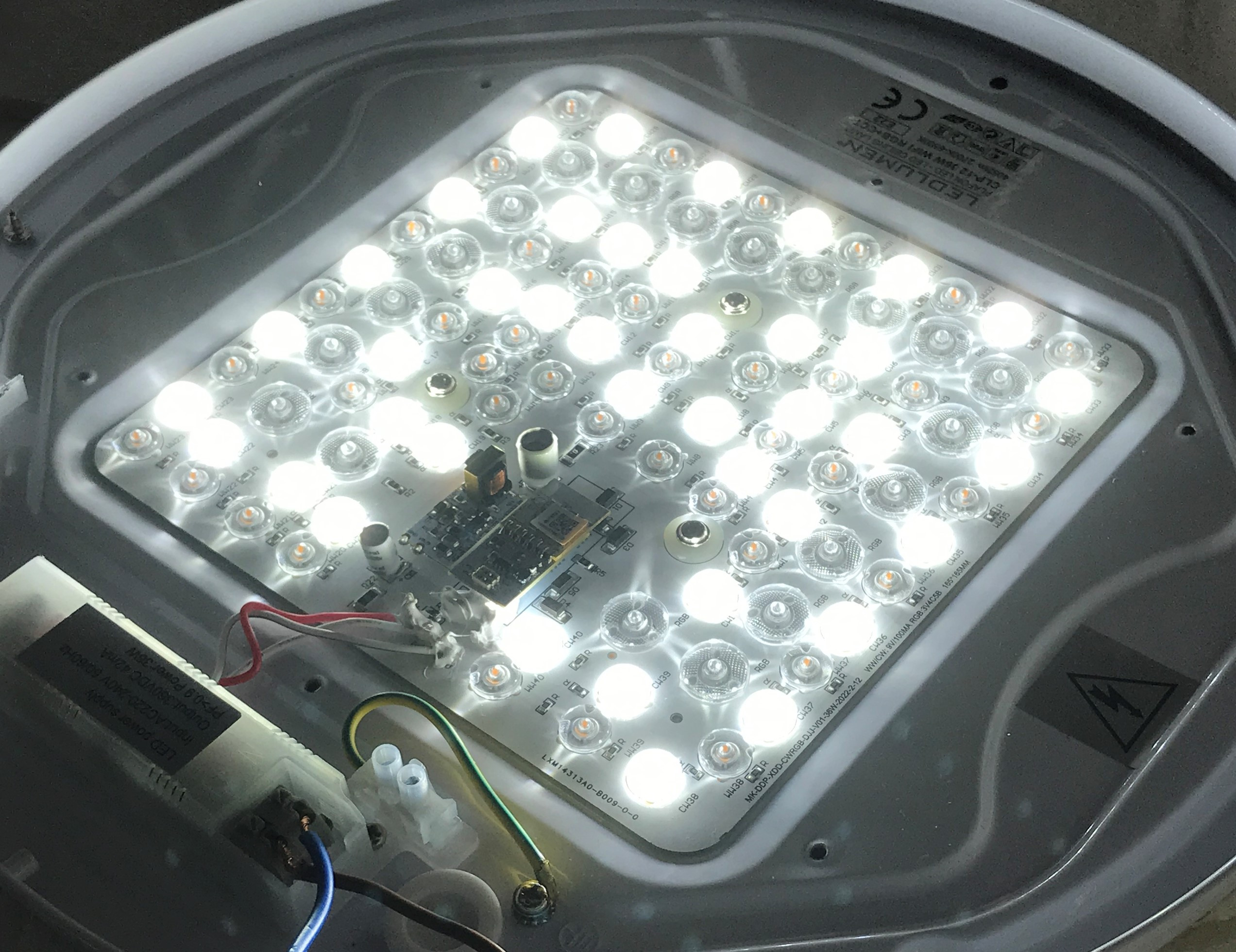

The interior of the plafond There are indeed a bit more LEDs, Or at least those in shades of white:
The LED power supply itself is separate (230VDC 42mA, 36W, PF>0.9), and their WiFi controller separately:

Under the WiFi module we can already see what controls the LEDs:
Two pieces of BP5758! The multimeter indicates that their SDA and SCL pins are connected together, but I don't think they have different addresses, their protocol probably doesn't even support that. Just used two because of the large number of white LEDs - warm and cold.
