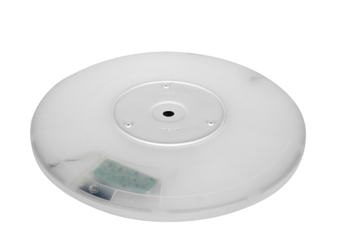

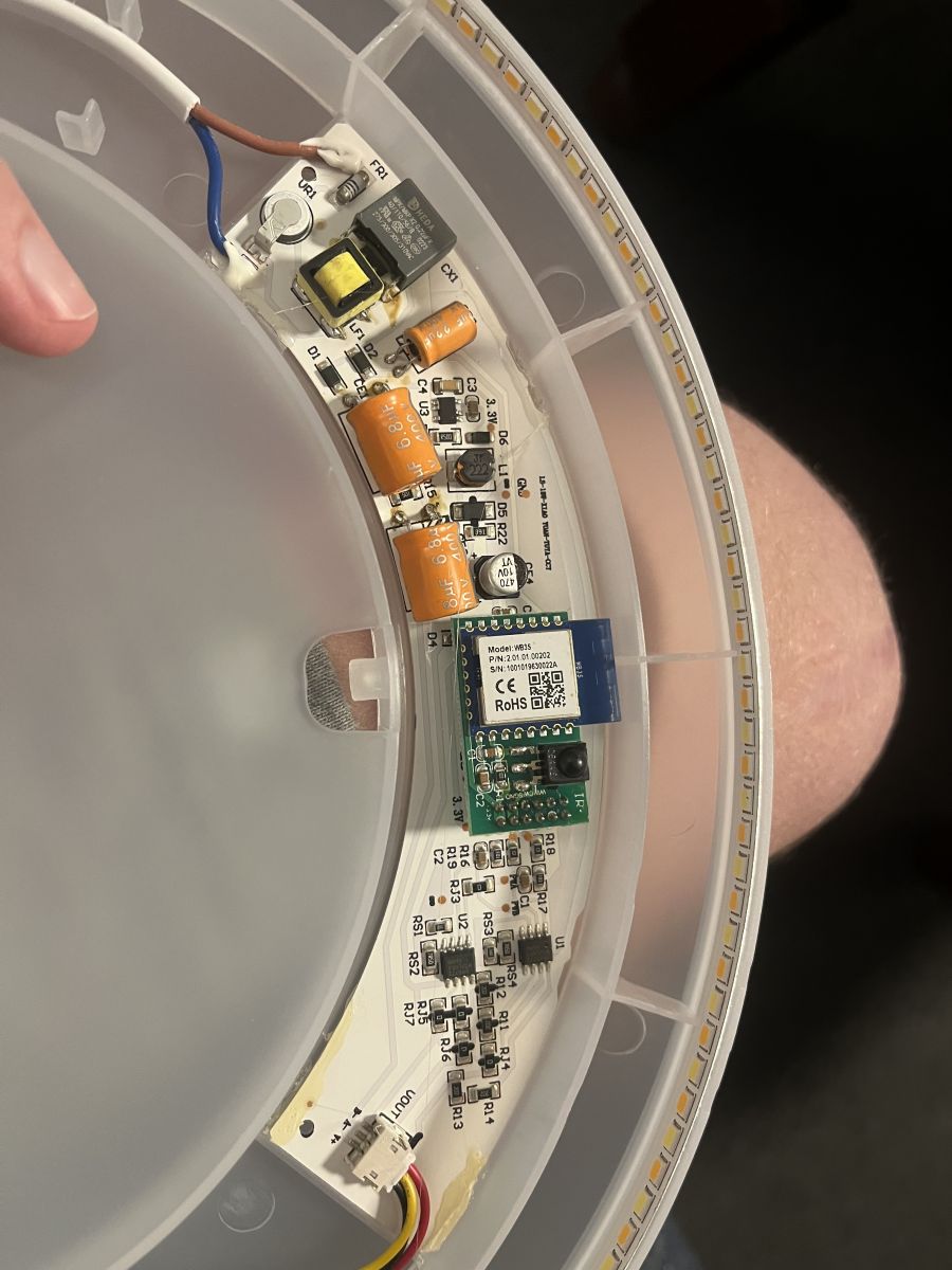

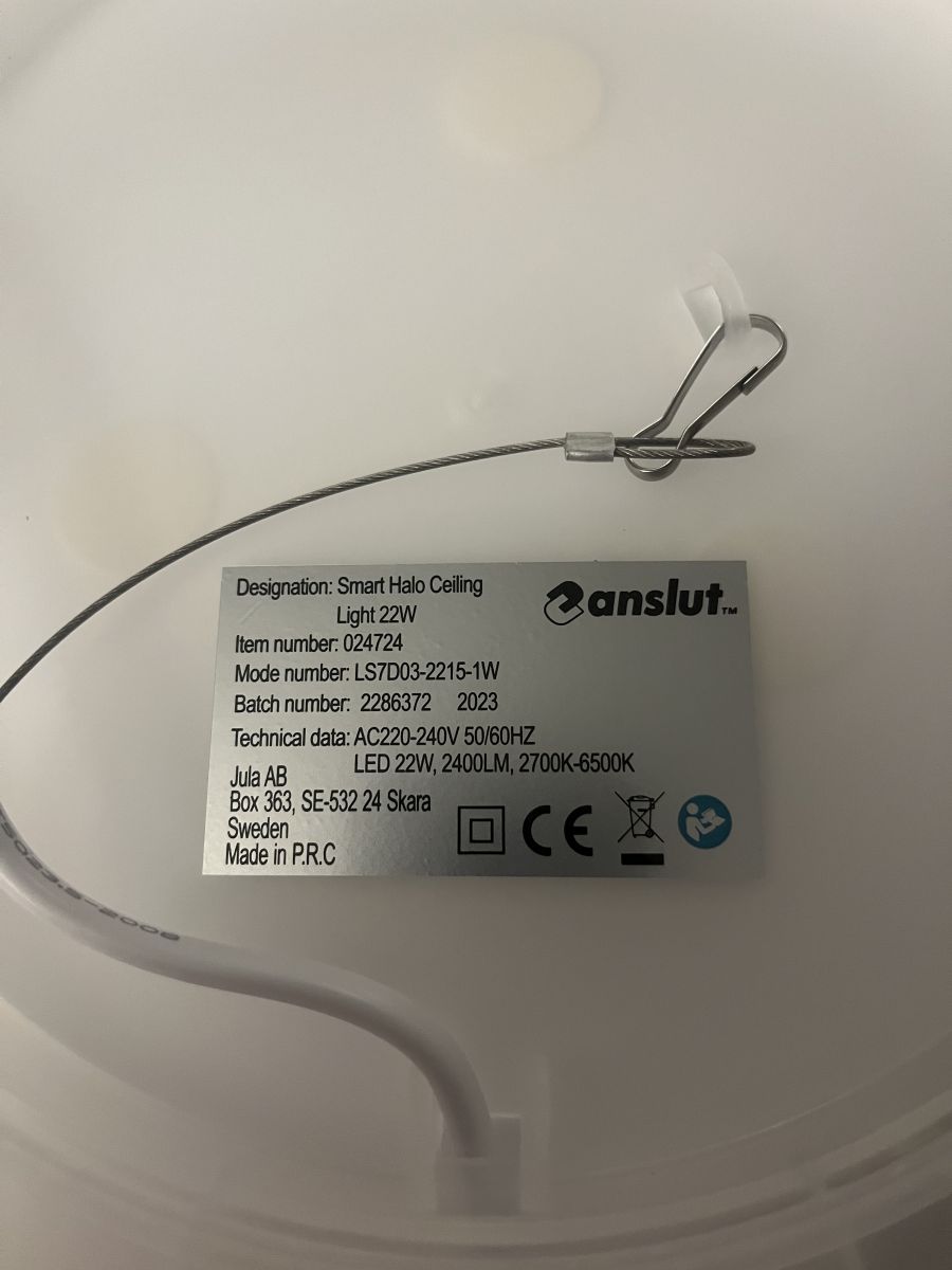

  • Anslut halo LED light teardown covers the 42 cm 22 W model and also applies to the 29 cm 14 W version.
  • The fixture uses a BK7231T chipset and was flashed over UART with OpenBK.
  • OpenBK version 1.17.398 was used successfully for the flashing process.

TL;DR: For Anslut Halo LED owners, the 42 cm / 22 W teardown shows a BK7231T on a WB3S board, and the published template says "also applies" to the 29 cm / 14 W model. Flash OpenBK 1.17.398 over UART, then use pin 6 = PWM;5 and pin 8 = PWM;4 for the shared setup. [#20907082]

  • The published device identity is Anslut Halo LED (42cm/22w, 29cm/14w), which directly ties one template to two lamp sizes and power ratings. [#20907082]
  • The controller section is identified as BK7231T on a WB3S board, which is the core hardware pairing the template targets. [#20907082]
  • The OpenBK pin map assigns pin 6 → PWM;5 and pin 8 → PWM;4, giving two explicit PWM outputs to match lamp channels. [#20907082]
  • The lamp was flashed over UART using OpenBK version 1.17.398, so the post documents a wired flashing path, not an OTA workflow. [#20907082]
