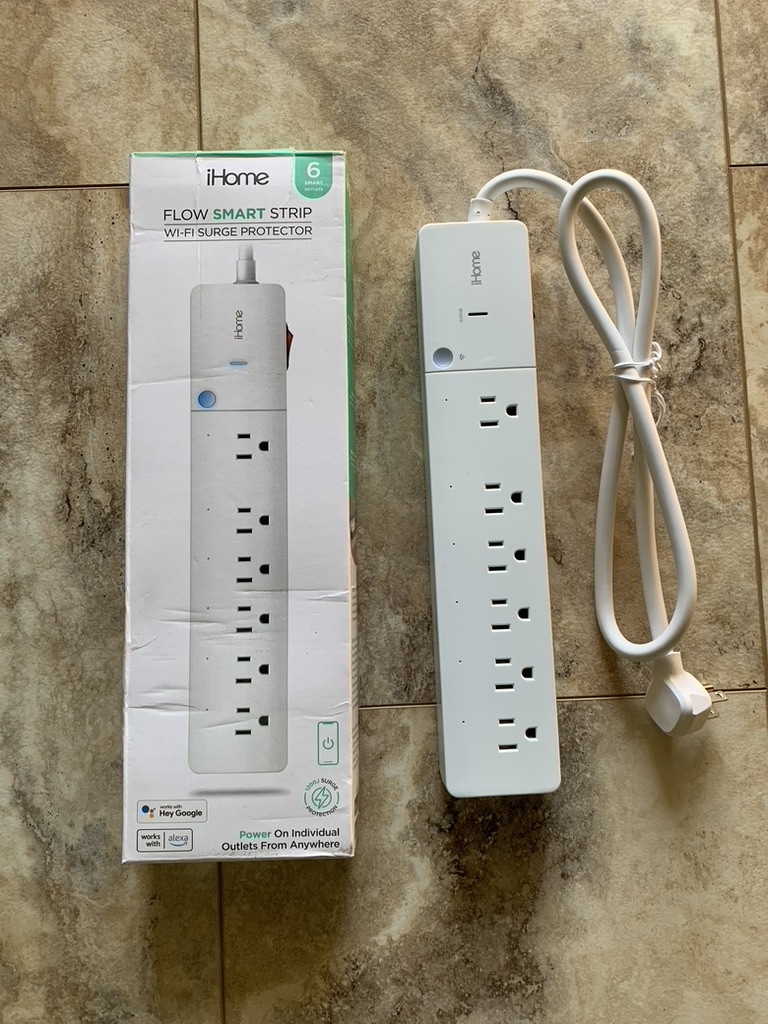

  • Teardown of a Geeni iHome Smart Surge Protector IH-SW007 reveals a Tuya WB3S module with a BK7231T chip and six independently controlled outlets.
  • Flashing required soldering leads directly to the Wi‑Fi module because the board exposed no pads, and power cycling started the download without special procedures.
  • The board mapping lists pins 1, 6, 7, 8, 9, 10, 24, and 26 for WifiLED_n, six relays, and dInput_n; channel 7 reads the Wi‑Fi button.
  • OBK controls all outlets and the Wi‑Fi light, but the button itself does nothing except produce a "1" when pressed.
I would like to submit the below teardown. The device uses a Tuya WB3S module and I was able to flash it with OBK. There did not appear to be any pads on the board to attach the flashing leads so they were soldered directly to the Wifi module. The power needed to be cycled to initiate the download. No special download procedures were required. All outlets can be controlled separately and the Wifi light works. The Wifi light has button but it does not do anything with OBK. I did map it to channel 7 and it will produce a "1" when pushed.

p.kaczmarek2 22 Mar 2023 19:15
Hello, the button can be much better utilized. For example, you can script it to toggle first relay on single click, second relay on double, etc... please see our autoexec.bat examples: https://github.com/openshwprojects/OpenBK7231T_App/blob/main/docs/autoexecExamples.md ... [Read more]
chri5k 23 Mar 2023 14:08
I can see where using the wifi button might be useful since each outlet doe not have an individual button to turn it on or off. Though one would need to be careful when trying to turn say outlet 6 on or... [Read more]
chri5k 26 Mar 2023 13:43
New device added to database. Button script tested and working. [Read more]
