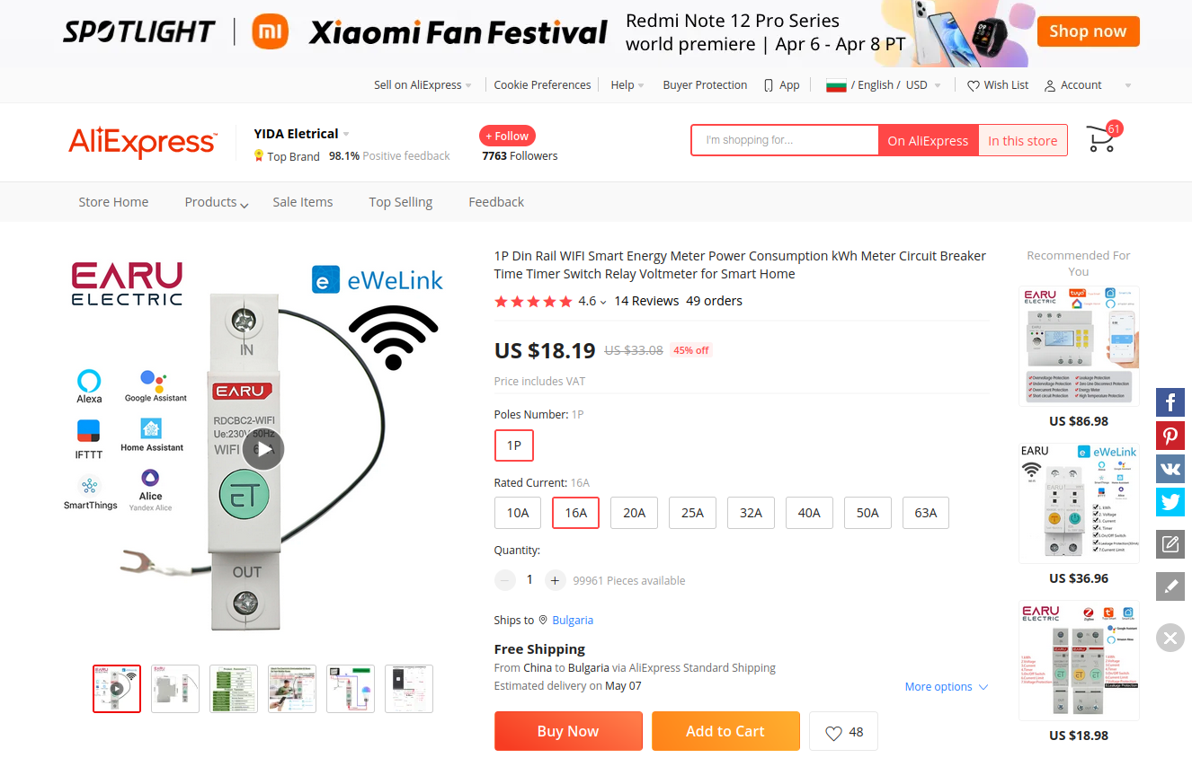

Bought from here:
Link
Page screenshot:
Package contains strange circuit breaker, without automatic magnetic field coil trip mechanics. It seems to explore 8 bit MCU + bistable relay for trip. Main module is PFS-B containing ESP8285 CPU. Although there is powerfull 32 bit CPU there is additional 8 bit micro controller SC92F7351. I think this is to provide high reliability.
Energy meter is CSE7759. All this is packed in 1 unit 19 mm DIN package.
