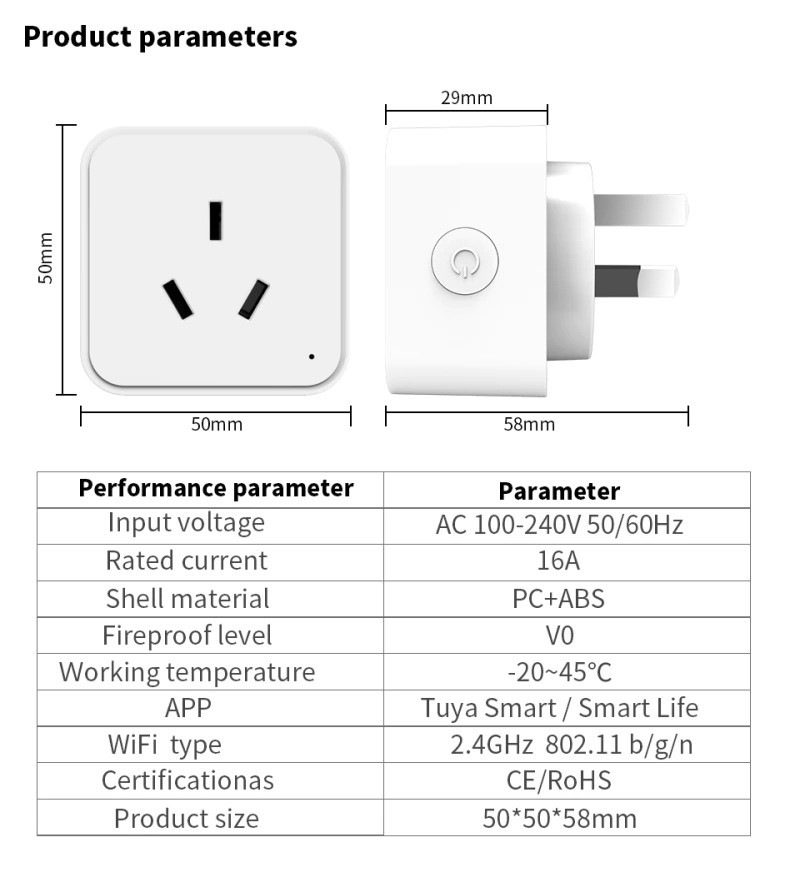

  • An unbranded Tuya LSPA9 Australian smart socket with energy monitoring was inspected, including two units on firmware 1.1.8.
  • The teardown identified the BK7231N/CB2S pinout: P6 BL0937CF1, P7 BL0937CF, P8 WiFi LED, P11 button, P24 BL0939SEL, and P26 relay.
  • One unit had an unsoldered earth pin that still made contact, while the other did not.
  • The socket is slightly wider than Arlec/Connect models and does not fit double GPOs.
Another unbranded Tuya LSPA9. This is an Australian model.
I had 2 with 1.1.8 firmware but the download seemed slightly different?
Note: the earth pin is unsoldered. One was making contact, one wasn't!
These are slightly wider than the Arlec/Connect models and don't work in double GPOs.
P6 is the BL0937CF1 pin
P7 is the BL0937CF pin
P8 is the Wifi LED
P11 is the Button
P24 is the BL0939SEL pin
P26 is the Relay

Why does the Tuya AU LSPA9 smart socket not fit properly in double Australian GPO outlets?
It does not fit properly because this unbranded Tuya LSPA9 is wider than the compared Arlec/Connect models. The author states these wider units “don’t work in double GPOs.” That is a physical spacing issue, not a firmware 1.1.8 or BK7231N issue. [#20586316]
How does the unbranded Tuya AU LSPA9 compare with Arlec or Connect smart plugs for Australian double GPO spacing?
The unbranded Tuya AU LSPA9 is wider than the Arlec/Connect models. That extra width prevents it from working in double Australian GPO outlets. The thread gives no millimetre measurement, but it gives a clear pass/fail comparison for double-GPO use. [#20586316]
