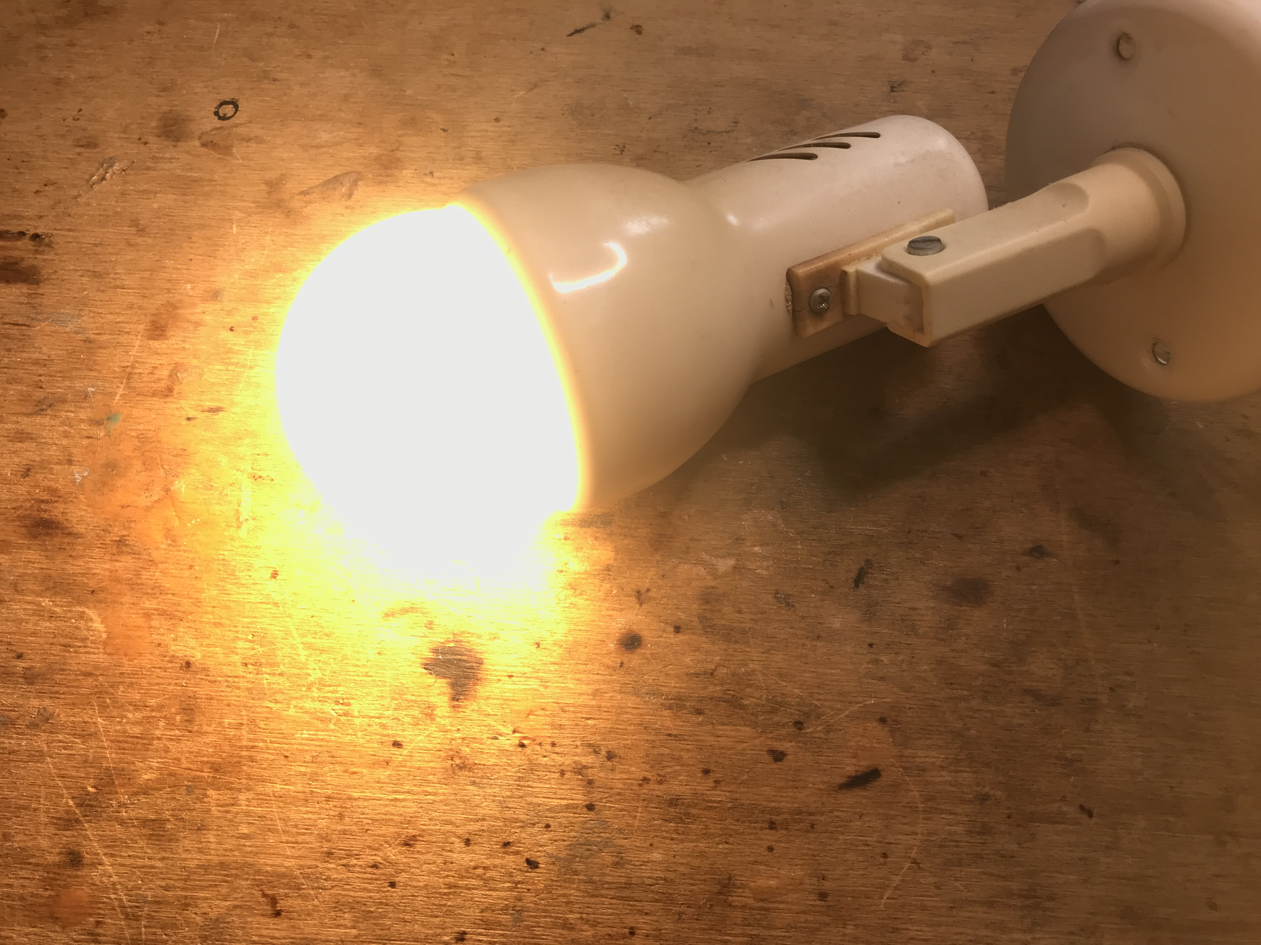

After that, we can enjoy a fully local LED lamp without the manufacturer's cloud:
