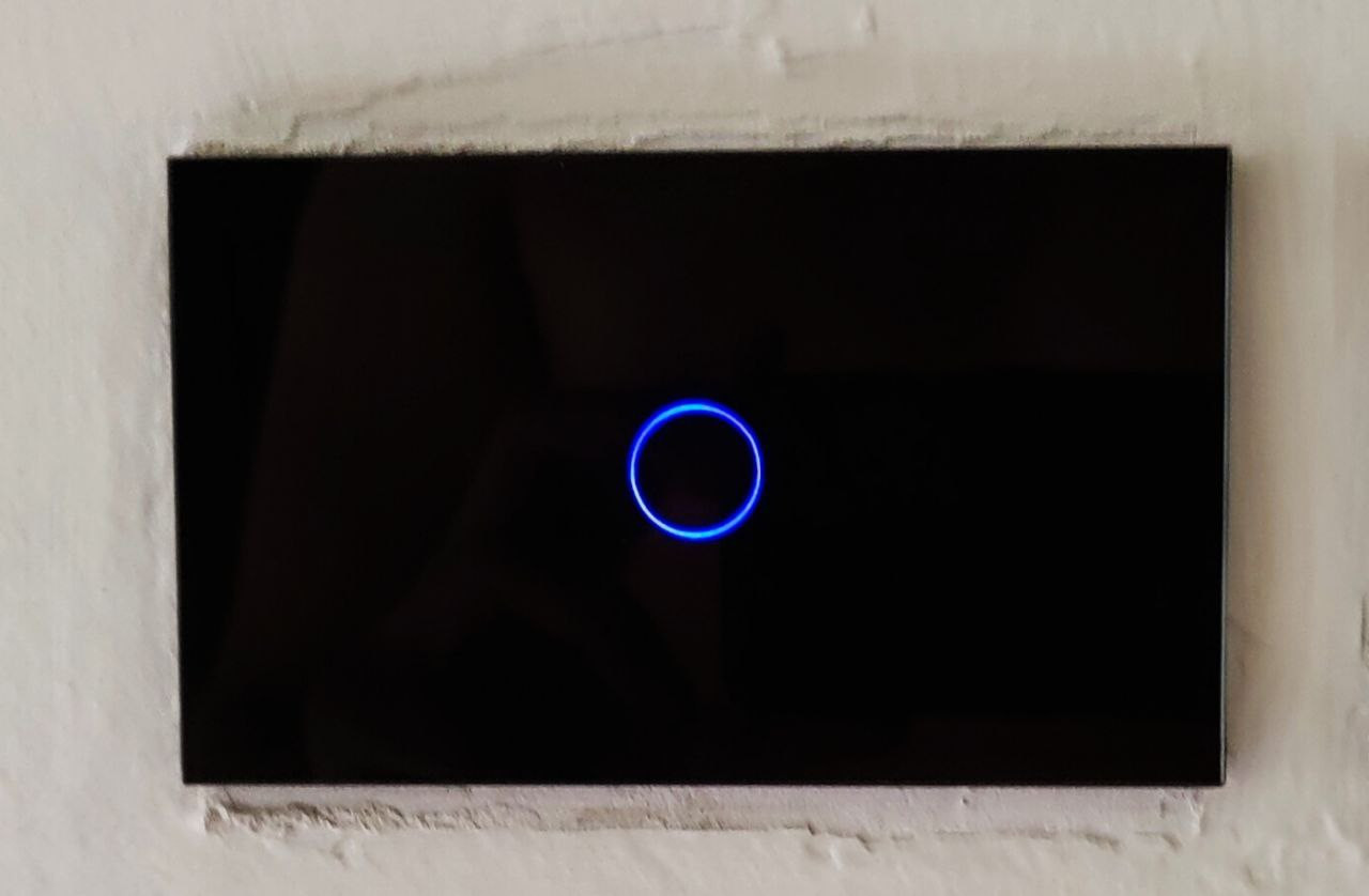

  • AVATTO US-TS02 1-gang Tuya Wi-Fi wall switch uses a BK7231N [CB3S] module and a local AliExpress vendor link is listed.
  • UART wiring maps TXD1 to UART RX, RXD1 to UART TX, 3.3 to UART 3.3V, and GND to UART GND.
  • GPIO mapping includes P7 for Btn 1, P9 for LED 1, P23 for WifiLED 0, and P26 for Rel 1.
  • To flash the BK7231N, either remove the 16-pin chip and solder it back, or cut and later repair the RXD1/TXD1 trace, then use BK7231GUIFlashTool.

p.kaczmarek2 14 Jun 2023 09:04
It looks like the issue that we had with a switch on our YouTube channel. We also had to break the RXD connection temporarily. https://www.youtube.com/watch?v=Yb3zXtBdSnE&t=1s&ab_channel=Elektrodacom Can... [Read more]
Jomsha 14 Jun 2023 09:42
Of course, I edited the post. Yes, this thing with the RX pin is a known "complicator". I met this situation even 3-4 years ago with the ESP8266 Tuya switches... [Read more]
p.kaczmarek2 14 Jun 2023 09:49
At least your device wasn't TuyaMCU. There are also TuyaMCU switches where you have to configure it in TuyaMCU mode, which complicates things even more. [Read more]
