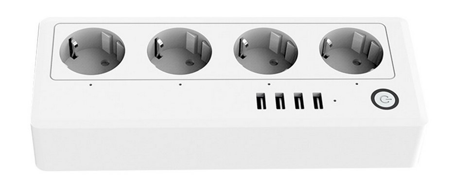

  • A Tuya Wi‑Fi smart power strip from AliExpress with 4 AC outlets and 4 USB ports was opened and tested for local flashing.

Hi,
I'd like to share the results of this device from AliExpress.
I took elements from similar topics, as it has the same housing as this one, and a chip very similar to this one.
For dissassembing, the 6 pads on the back can be easily removed, giving access to 6 triangle screws:
The chip is a BK7231N on a small PCB with indication YX-B3S1-VER00
