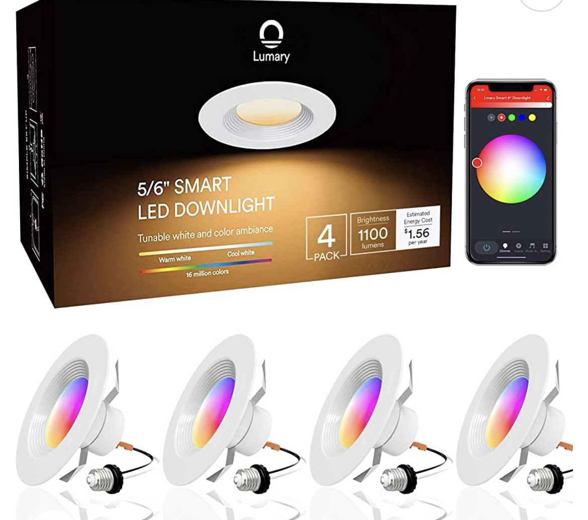

[BK7231N/CB2L] Lumary 5/6 Inch Downlight - OpenBeken driver for KP18058esp LED controller
swpharis  42 6435 Cool? (+2)
  • Lumary 5/6 Inch Downlight uses a BK7231N/CB2L module and a KP18058esp LED controller for an OpenBeken driver setup.
  • Accessing the internals requires removing the diffusing filter, undoing 3 screws, unplugging the ribbon cable, and gently prying off the back cover.
  • The CB2L module is soldered to the power board, and the plastic housing is very soft and brittle.
Remove diffusing filter.
Undo 3 screws.
Unplug ribbon cable from LED board.
Gently pry off back cover with small flat tool. Plastic is very soft/brittle.
CB2L module is soldered to power board.
