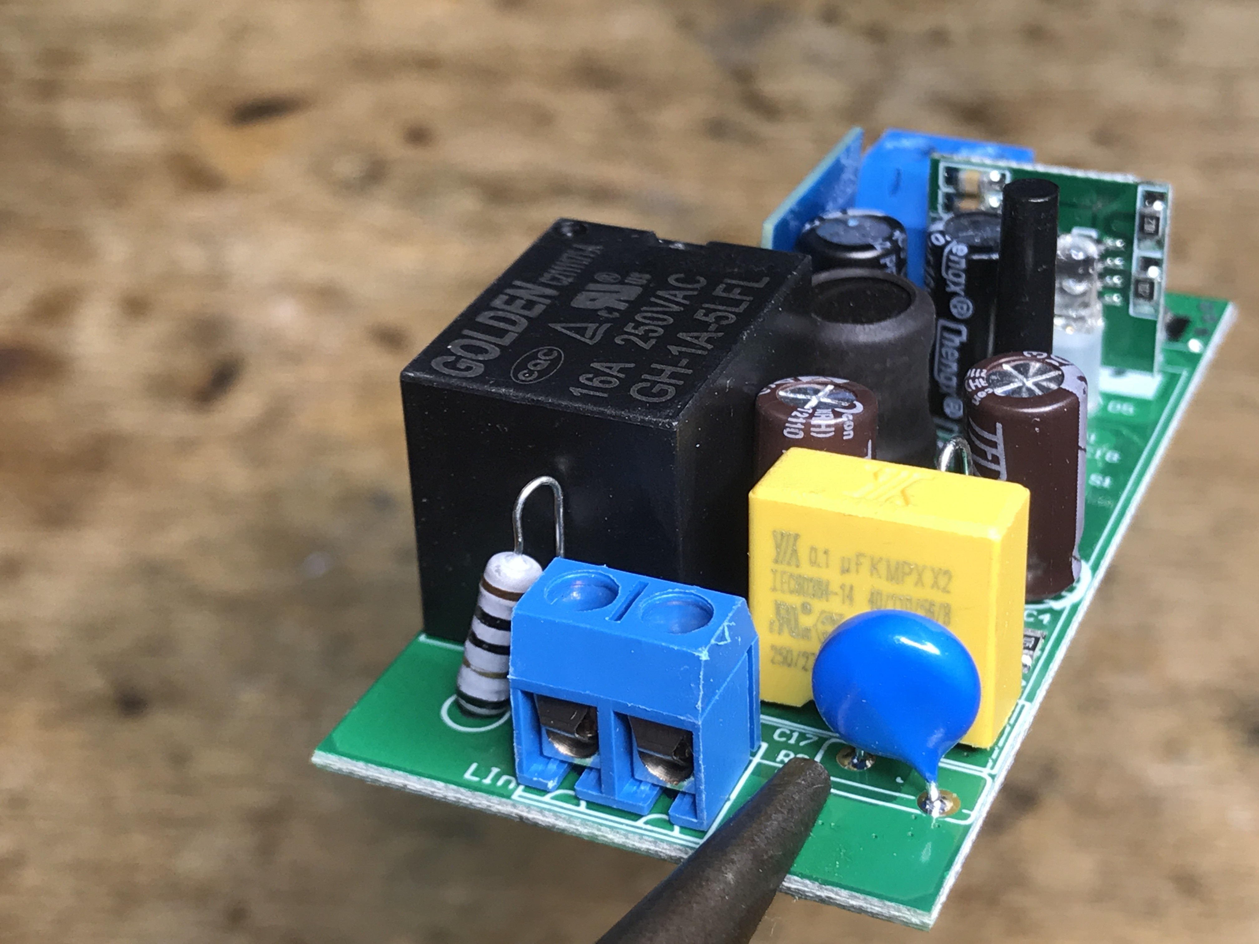

Interior of the MS-101
As with other products of this type in this case, all you have to do is pry:
Immediately inside a positive surprise. Varistor? Or even the X2 capacitor? Many manufacturers do not care a bit about such things, I met such relays only with a fuse resistor ... it is better than usual.
Then as standard, behind the bridge there are two electrolytic capacitors and a choke between them, then there is probably a converter without galvanic separation, on the PCB you can also see a separate WiFi module and an energy measurement module:
This energy measurement module is marked WMetBLi1 V1.0. You can also see the current/voltage shunt resistor, R13, coded R002, which is probably 0.02 ohms.

I have already seen this type of "smart" modules in the version without energy measurement and I was wondering what the second, free slot in the PCB could be for ... I thought it was for another WiFi module, but nothing more wrong - it was always for the module energy measurement, such as presented here in the topic. Anyway, you would rather not have two slots for the WiFI module in the PCB of the relay, because from what I've seen, all these "standing" modules have a very similar, compatible footprint. There is a whole family of them: CB2S, FL_M99_V1, TYWE2S, TYZS6, TW-02, WR2, WB2, WBR2, WR2E, WB2S, WA2, XT-BL02 - all compatible with ESP-02S. Only that here you do not need to change WB2S, just upload:
As for the rest - the construction of this gadget is good, the manufacturer did not even omit the varistor, this is something. The price, in turn, is slightly higher than some sonoffs, but here we have the energy measurement ...
