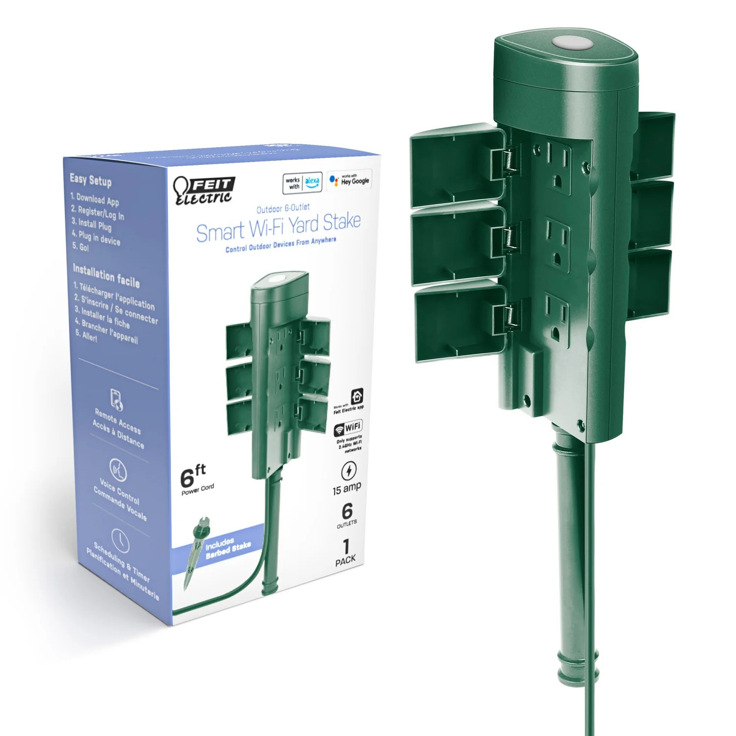

  • Feit Electric Smart Wi‑Fi Yard Stake, SKU PLUG/WIFI/STK/WP, is an outdoor six-outlet power stake with one relay controlling all 6 outlets.
  • Tuya-CloudCutter flashed OpenBeken without issues, using the Feit Electric PLUG/WIFI/WP configuration as the starting point.
  • The board uses a BK7231-TQN32 chip and no Tuya module; pin mapping is Wifi_LED p7, LED p8, Relay p24, Button p26.
  • OpenBeken works just like the Tuya cloud version on this device.
This is the first, and likely only device that I have ever added openbk to, but it has not yet been listed so I figure I'll throw the information that I have about it here.
I purchased this from an Ace Hardware a few years back, and finally decided to cut it from the cloud. It has one single relay that controls all 6 outlets.
Hopefully I have enough information to make this useful.
Device name: Feit Electric Smart Wi-Fi Yard Stake
SKU: PLUG/WIFI/STK/WP
Manufacturer URL: https://www.feit.com/products/six-outlet-outdoor-stake-wi-fi-smart-plug-plug-wifi-stk-wp
Description: outdoor 6 outlet power stake
Chip: BK7231-TQN32
No tuya module
Summary:
To flash Openbk, I used Tuya-CloudCutter and it worked without any problem.
I used the config from the Feit Electric PLUG/WIFI/WP and it works just like it did when connected to the Tuya cloud services (Wifi_LED p7; LED p8; Relay p24; Button p26)

p.kaczmarek2 20 Jul 2023 23:32
Thank you for the presentation, it is a very interesting device, although I would be worried about its IP rating. Is it really an outdoor one? I can also see the tracks for the RF circuit on the PCB.... [Read more]
Skooj 20 Jul 2023 23:49
As far as waterproofing, there is no mention that I've seen of any IP rating. There are no gaskets or seals of any kind that I can find, just the overlapping plastic bits of the housing... We have been... [Read more]
p.kaczmarek2 20 Jul 2023 23:54
It's good to hear it already lasted a long time. Maybe I worried over nothing. Btw, if you are a new user, you can look into PowerSave 1 and startDriver SSDP commands, the first one can reduce energy... [Read more]
Skooj 21 Jul 2023 00:14
That is good to know about the powersave feature! This page says that it should be 1 by default, but I have added it to my startup for good measure. As for the SSDP driver, I can't seem to find any... [Read more]
p.kaczmarek2 21 Jul 2023 00:29
Oops, I didn't mean to say it's enabled by default. Our intention was to say that if you type: PowerSave , without any arguments, it will assume that you want to do PowerSave 1 . This is because of the... [Read more]
Skooj 21 Jul 2023 00:45
That all makes sense. Thanks for letting me know about both of those! [Read more]
p.kaczmarek2 21 Jul 2023 07:15
We also have some OpenBeken information on our Elektroda YouTube Channel: https://www.youtube.com/@elektrodacom/videos [Read more]
Skooj 25 Jul 2023 22:17
I just learned how to download the Tuya config and extract the pinouts , and have updated my original post with the new information and config JSON: Device configuration, as extracted from Tuya: -... [Read more]
p.kaczmarek2 26 Jul 2023 07:38
You're lucky that you've got a device with two separate LEDs. Here's a SSDP tutorial: [Read more]
starbuck93 23 Dec 2024 21:07
Thanks for posting this. I just purchased the Globe Electric "Remote Control Ground Stake" Model number 50233 on clearance at my grocery store and it's exactly the same as the Feit Stake. All I could find... [Read more]
p.kaczmarek2 24 Dec 2024 05:27
Good luck, but don't worry if the device is already patched. The UART method is also easy to do. I can see there are some flashing pads exposed inside, in the case of patched device, we may need to check... [Read more]
