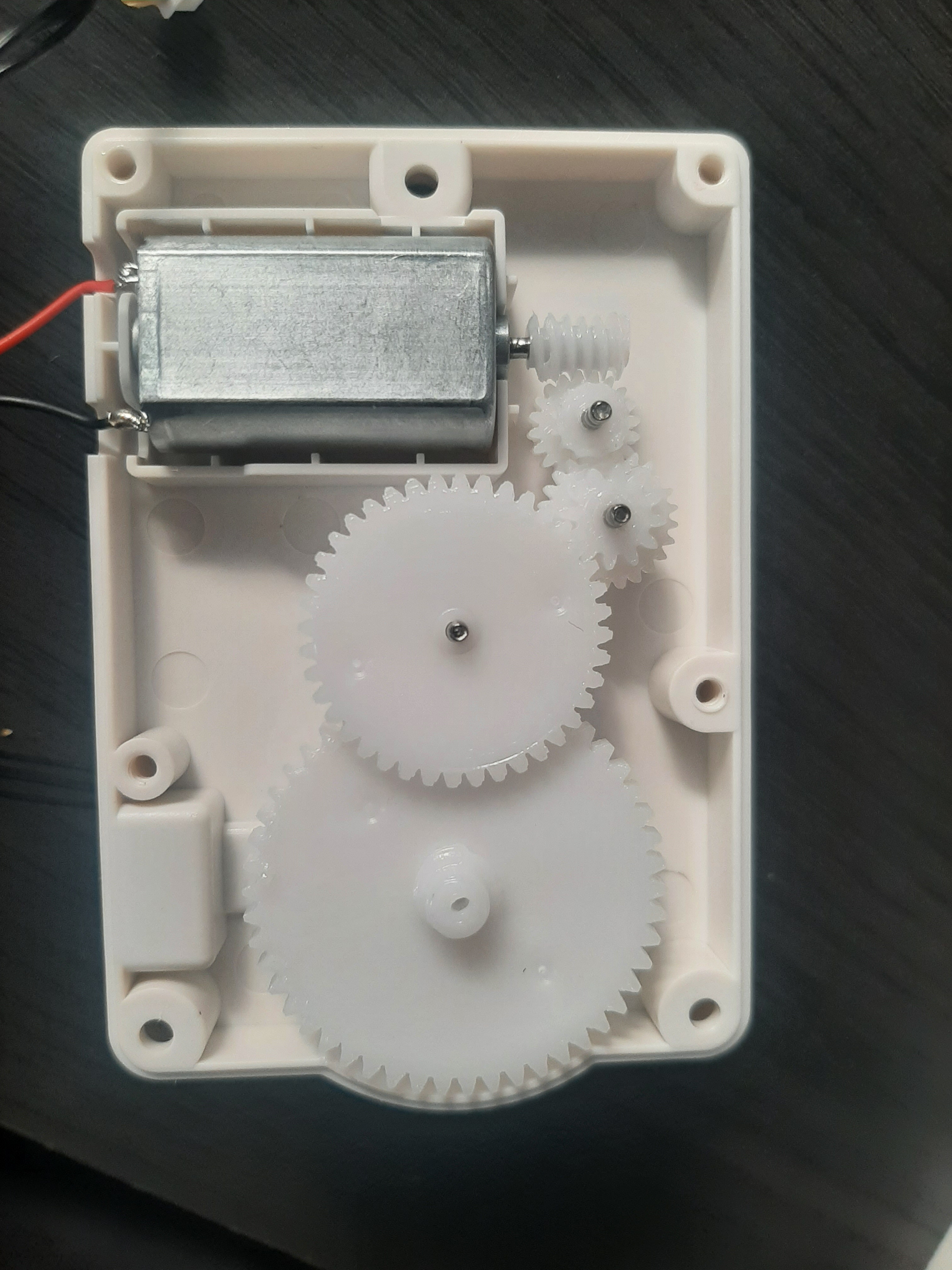

Device Name: 3Paws Smart Wi-Fi Pet Feeder 1080p
Device Type: Auto Pet Feeder with Camera
Device Chip: Has several chips onboard - ? TuyaMCU STM8L052C6T6 - Camera GK7102C - ? WIFI module BL-M8188FU3
The device I purchased was from Australia Post Shop. This Item is no longer available found a similar device on Alibaba.com
Device: Automatic Cat Pet Feeder
Flashing of Chip
So far I only have only found information about some of the chips/modules onboard.
STM8L052C6T6stm8l05...pdf (1.27 MB)You must be logged in to download this attachment.
GK7102CK1196327..1.pdf (62.59 kB)You must be logged in to download this attachment.
BL-M8188FU3BL-M8188FU3 Infomation
The STM8L052C6T6 is possibly the TuyaMCU that has the controlling firmware. Not sure how to dump this information yet.
The GK7102C is most likely the chip that controller the camera.
The BL-M8188FU3 is located on the camera board. This is also where all the control buttons are as well. Not sure if this could be hacked. It does appear to have pins that I could possibly try and dump the firmware on board. I have not tried to do this.
I am not sure it is even possible to hack this device. I have it running with home assistant and have been been able to get some functions working with local tuya but it's not prefect and I have reverted back to the standard Tuya interaction for now

p.kaczmarek2 21 Jul 2023 10:05
BL-M8188FU3.... that's interesting, it seems it's RTL8188 module, I just posted an article on our Polish site about recovering an RTL8188 module from old e-book reader: https://www.elektroda.pl/rtvforum/viewtopic.php?t=3990739&highlight= It... [Read more]
wolfieeewolf 24 Jul 2023 05:11
The BL-M8188FU3 is located on the back of the camera board. That board connects to the PP003 Button board via a ribbon cable. Another cable runs from the button board to the main board with the STM8L052C6T6... [Read more]
p.kaczmarek2 24 Jul 2023 06:27
Don't worry about that, we don't need to meddle with that device if it works well. I was just pointing out that RTL8188 has only USB interface, which means that USB must be used internally for communication... [Read more]
wolfieeewolf 15 Nov 2023 01:15
I realised I never actually posted these. I have it connected via the tuya mobile app. The functions are very basic but once you have things set you really never use the app. https://obrazki.elektroda.pl/3213563500_1700007107_thumb.jpg... [Read more]
