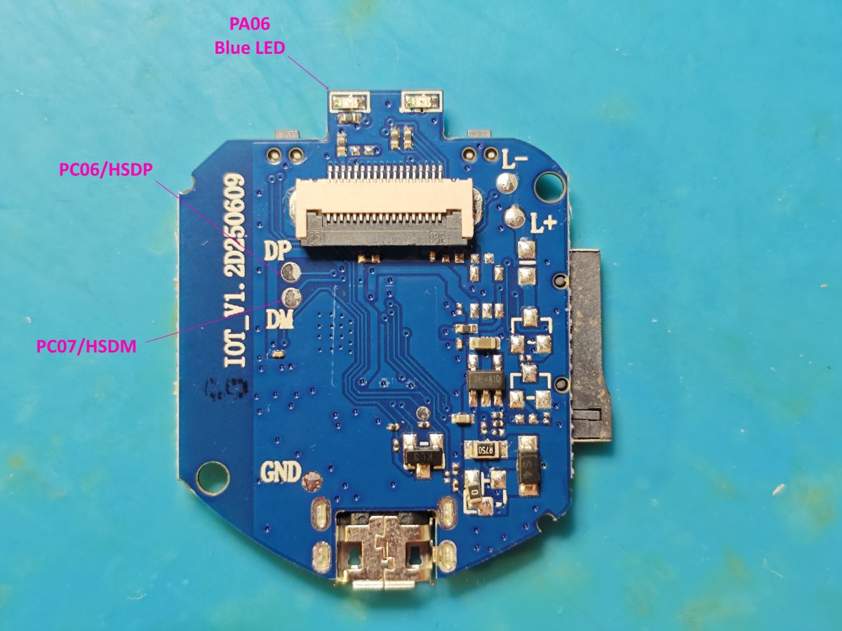

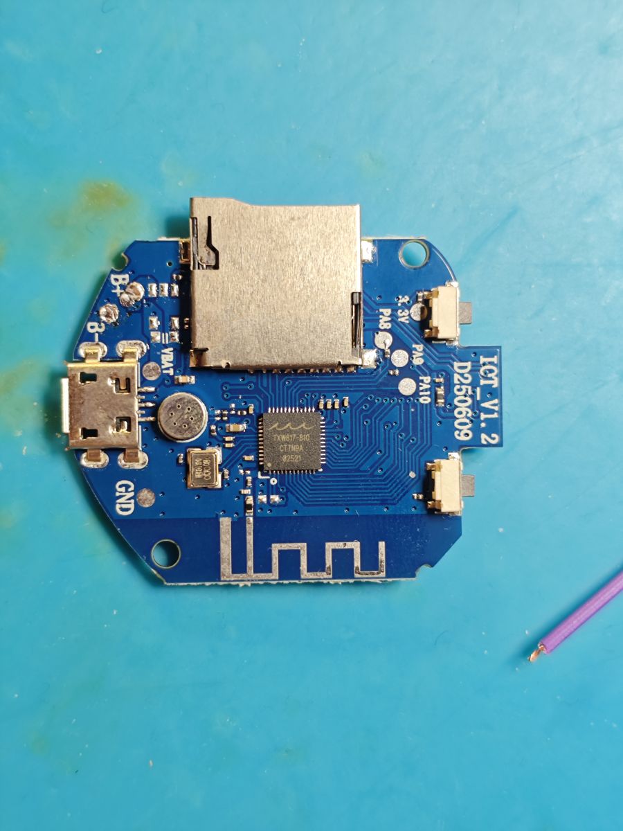

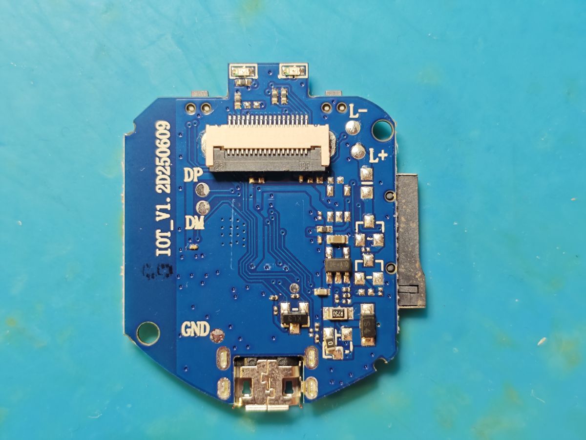

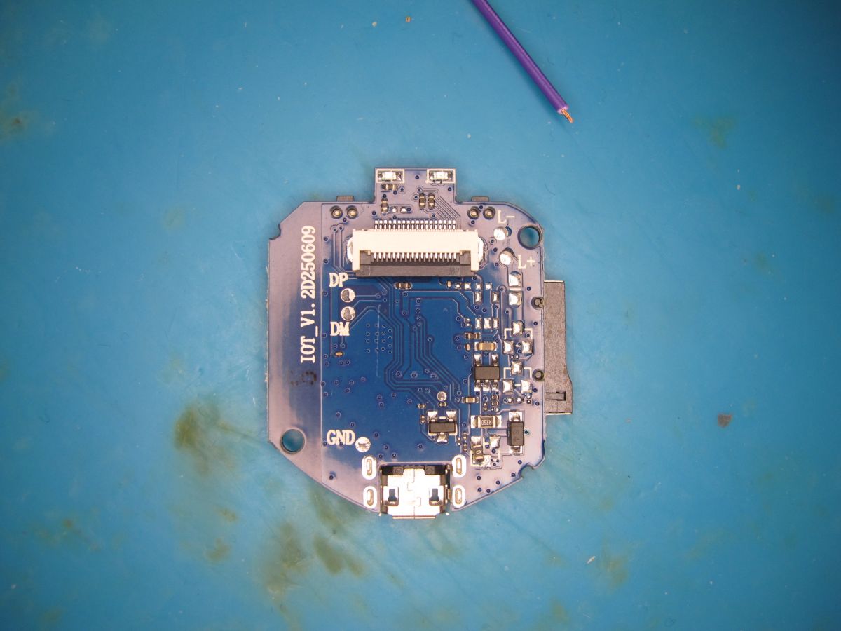

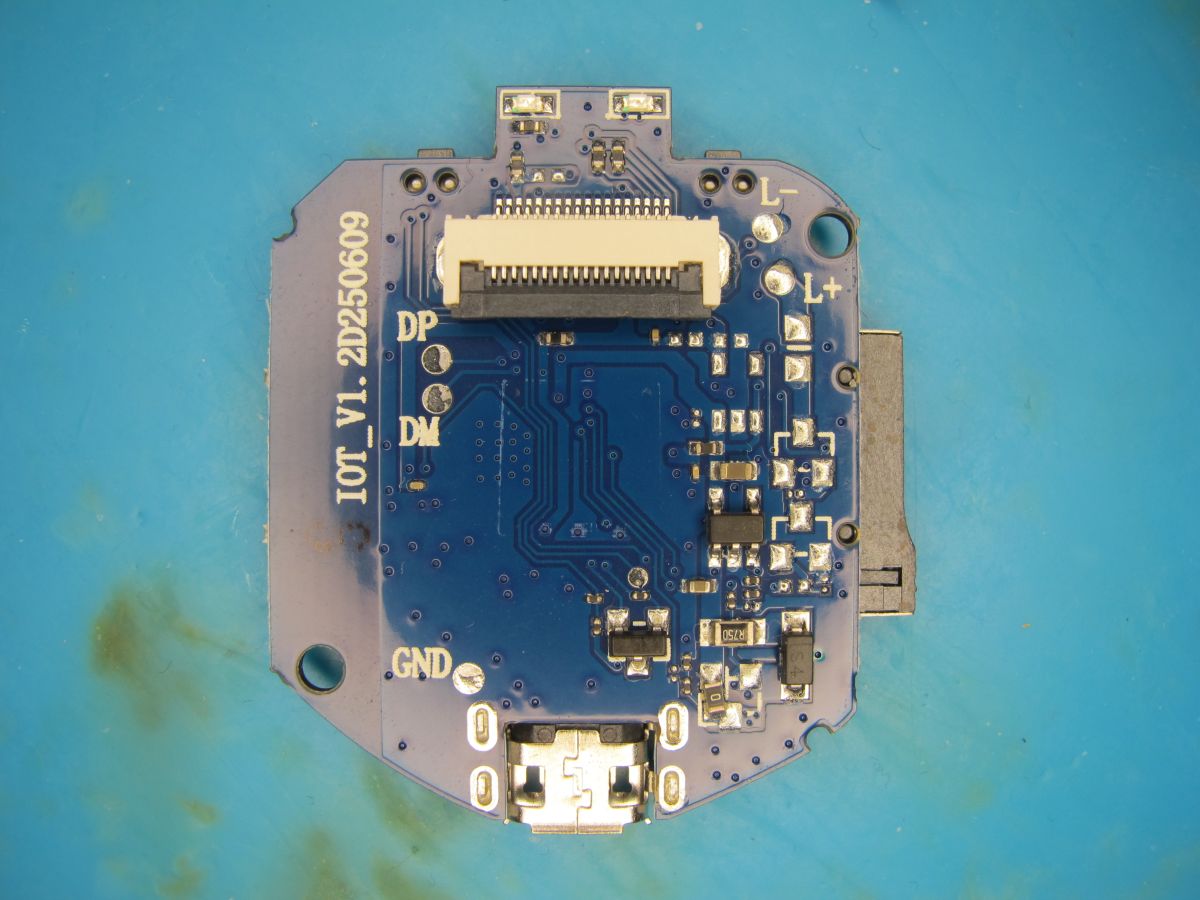

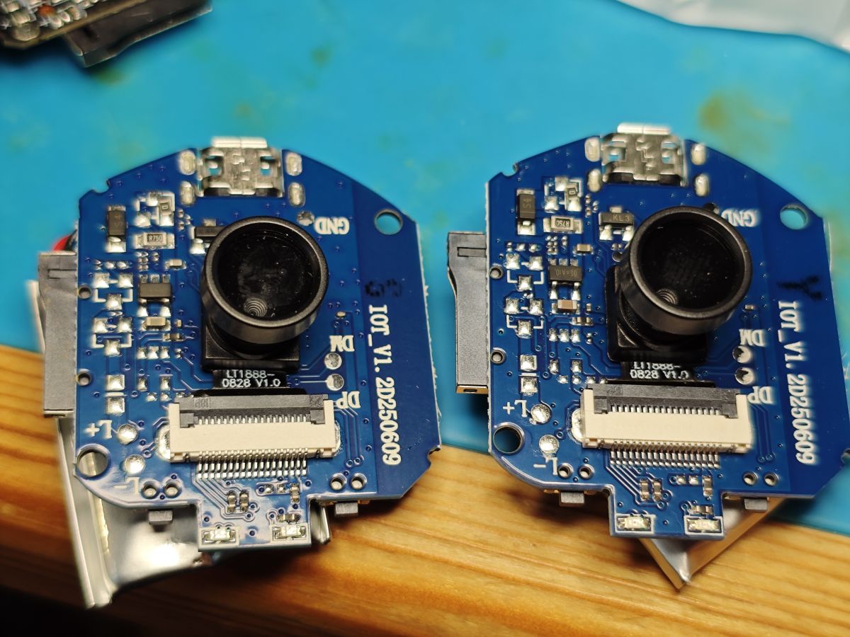

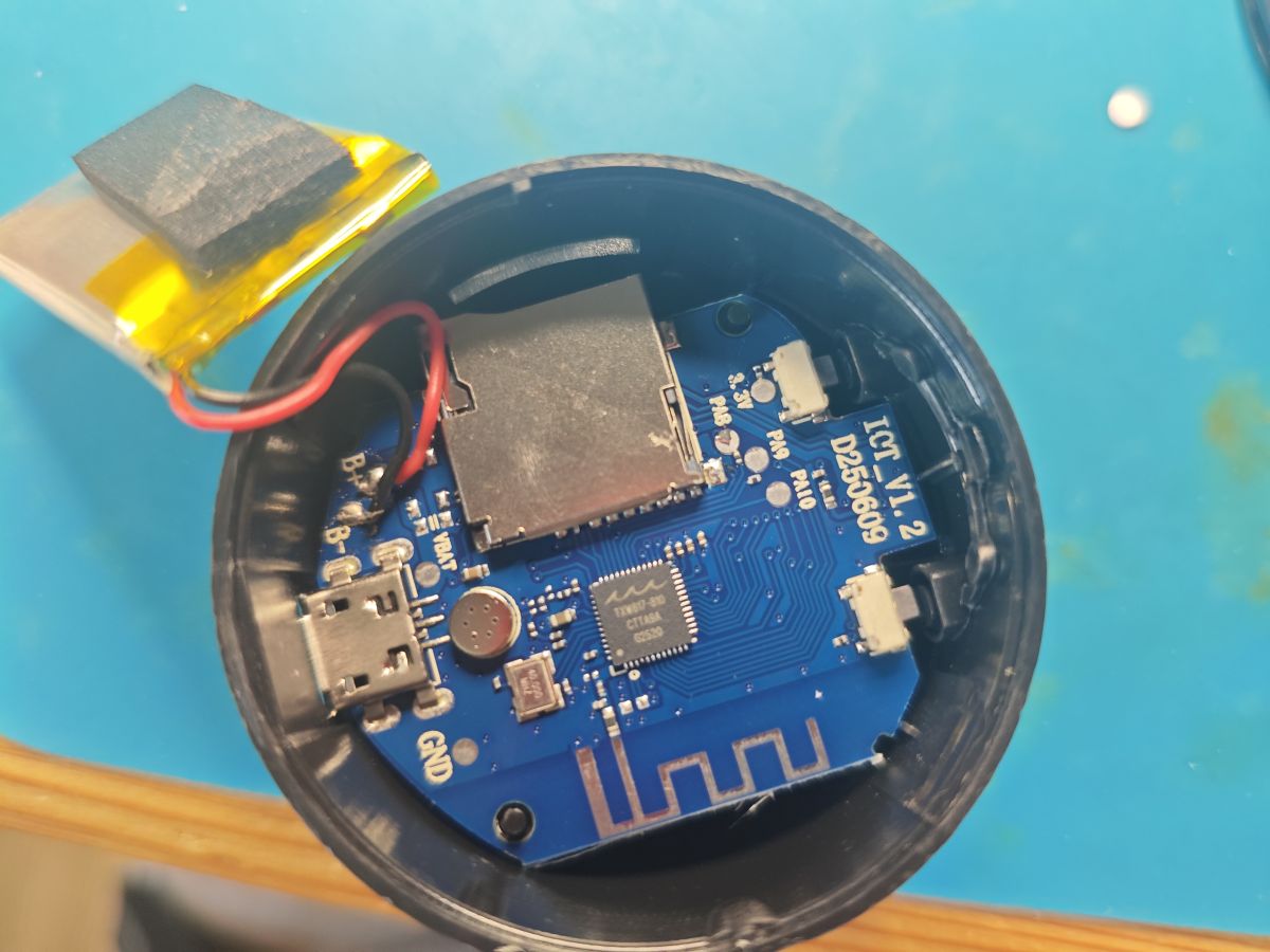

    This A9 PCB has already been seen here https://www.elektroda.com/rtvforum/topic4118499-60.html#21703243 and https://www.elektroda.com/rtvforum/topic4033757-150.html#21703262 but here's a few more pics, boot log from mine, Z-IOT CAM app pics. Further discoveries to be posted as and when
    Both mine shipped with SuperPix SP0828 320x240 sensor.

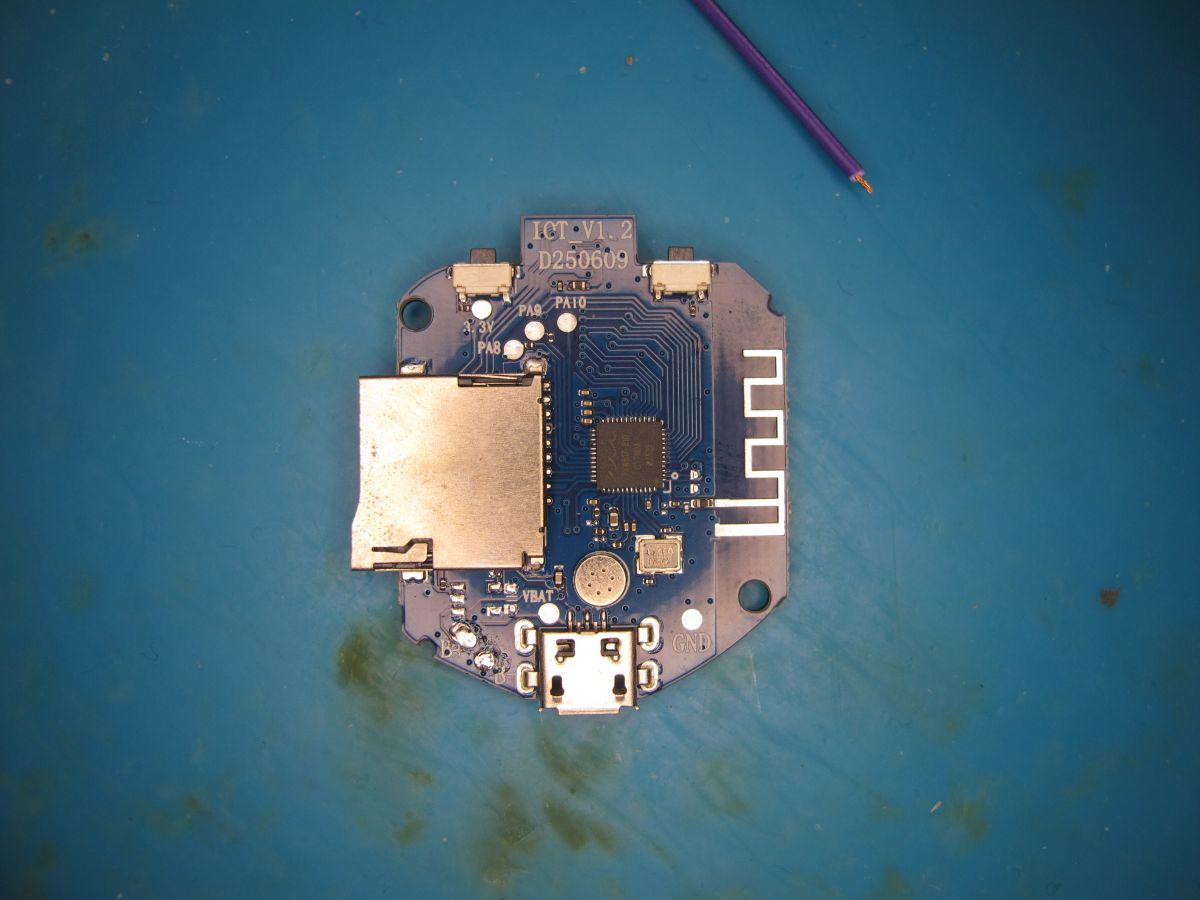

    Two camera modules with lenses on blue printed circuit boards
    OpenTXW81X supports SP0828 now as of PR 1818 https://github.com/openshwprojects/OpenBK7231T_App/pull/1818 but RTSP image is in portrait mode.
    pics dump
    Blue PCB with microSD slot, USB port, and microcontroller on blue surface PCB with lithium-polymer battery, micro USB port, microSD slot and Bluetooth module Close-up of a small electronic device showing PCB, battery, and Bluetooth module Blue PCB with micro USB port and SD card slot on a blue background Blue IoT PCB with electronic components on a blue work surface Blue PCB with USB connectors, SMD components, and labels DP, DM, GND Blue PCB with CY8C microcontroller, micro USB port, and microSD slot Blue PCB with electronic components, labeled pads, and flex and USB connectors
    boot log from 'DP' pad (HSDP/PC6) at 115200 (usually 921600 on Taixin)

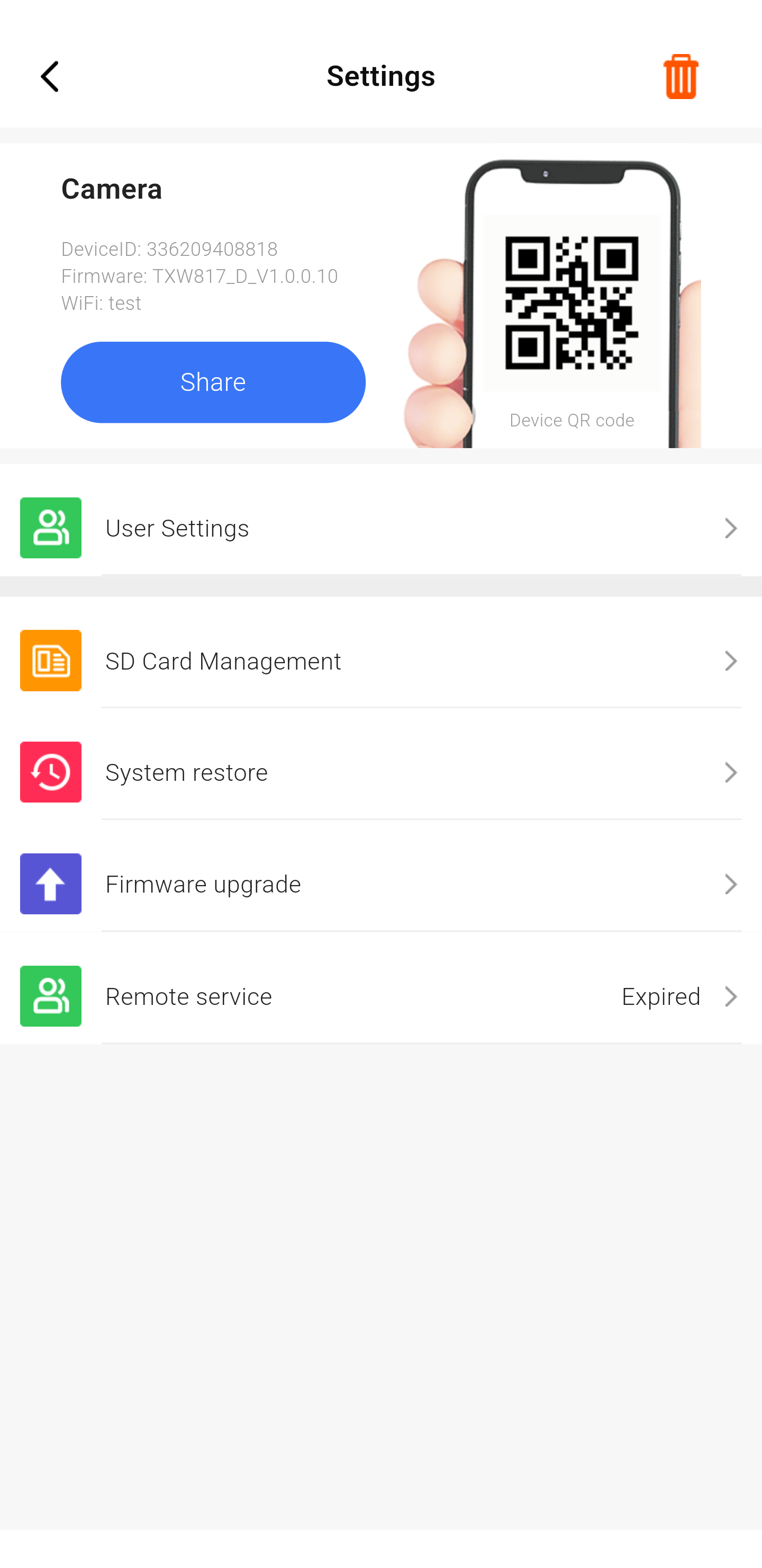

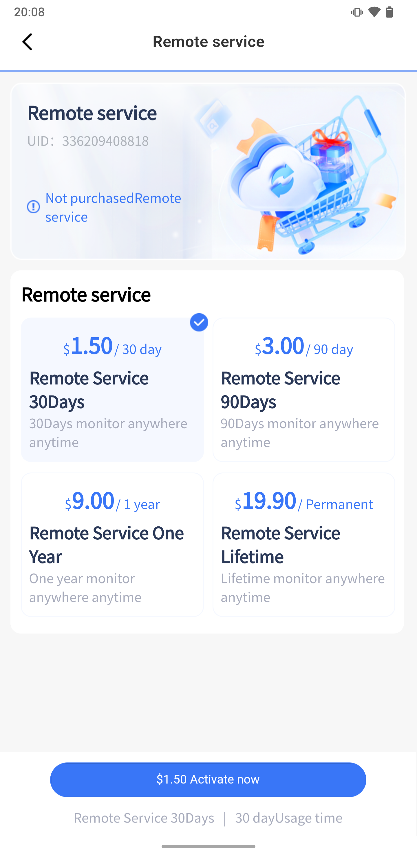

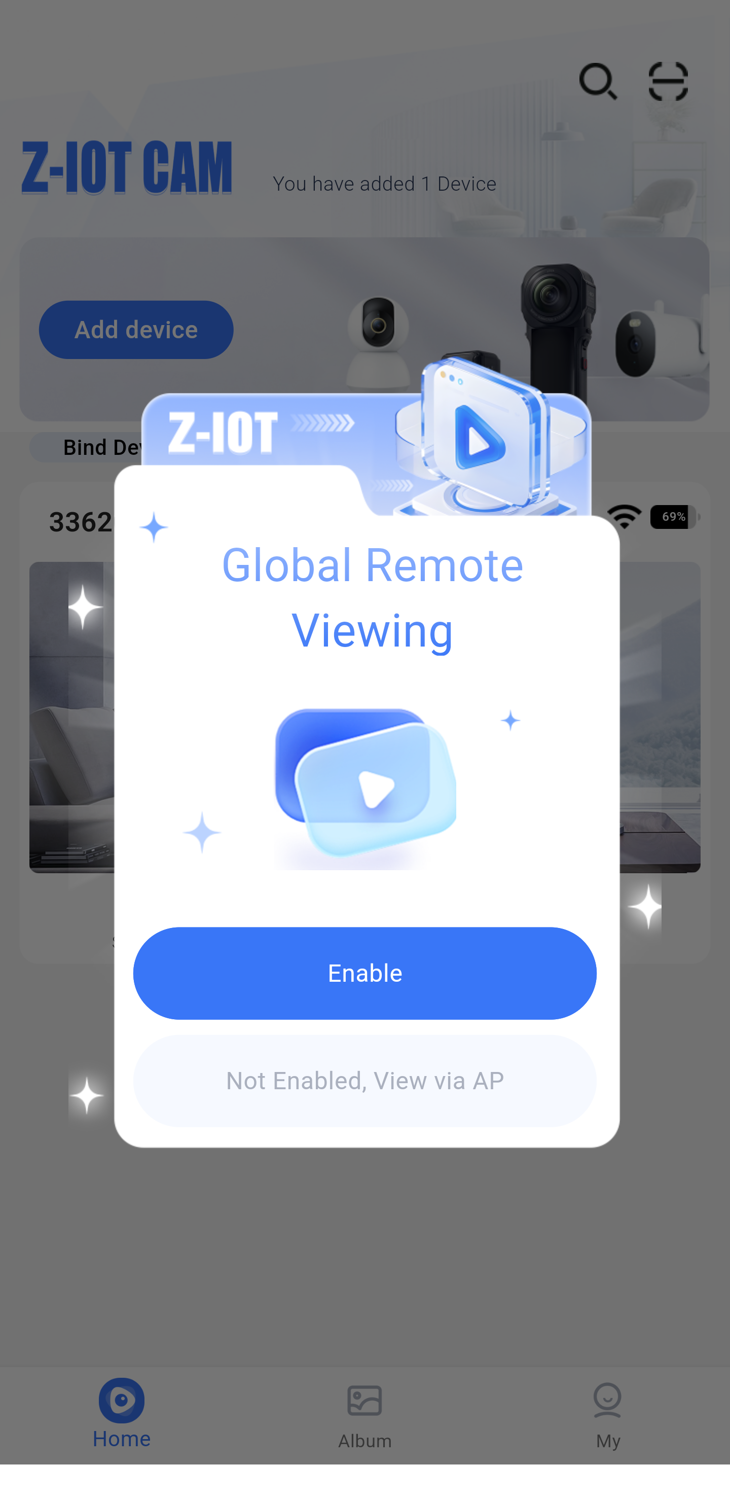

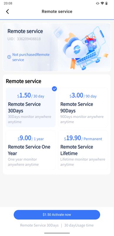

    Z-IOT CAM app offers streaming capability with device in AP mode but 'remote' mode is chargeable. No thanks.
    Z-IOT CAM app screen showing remote viewing option with Enable button App screen showing remote service subscription plans with prices and durations

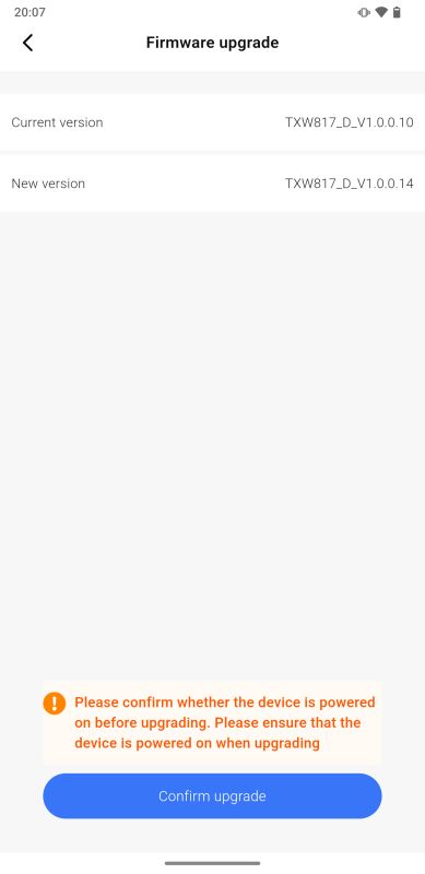

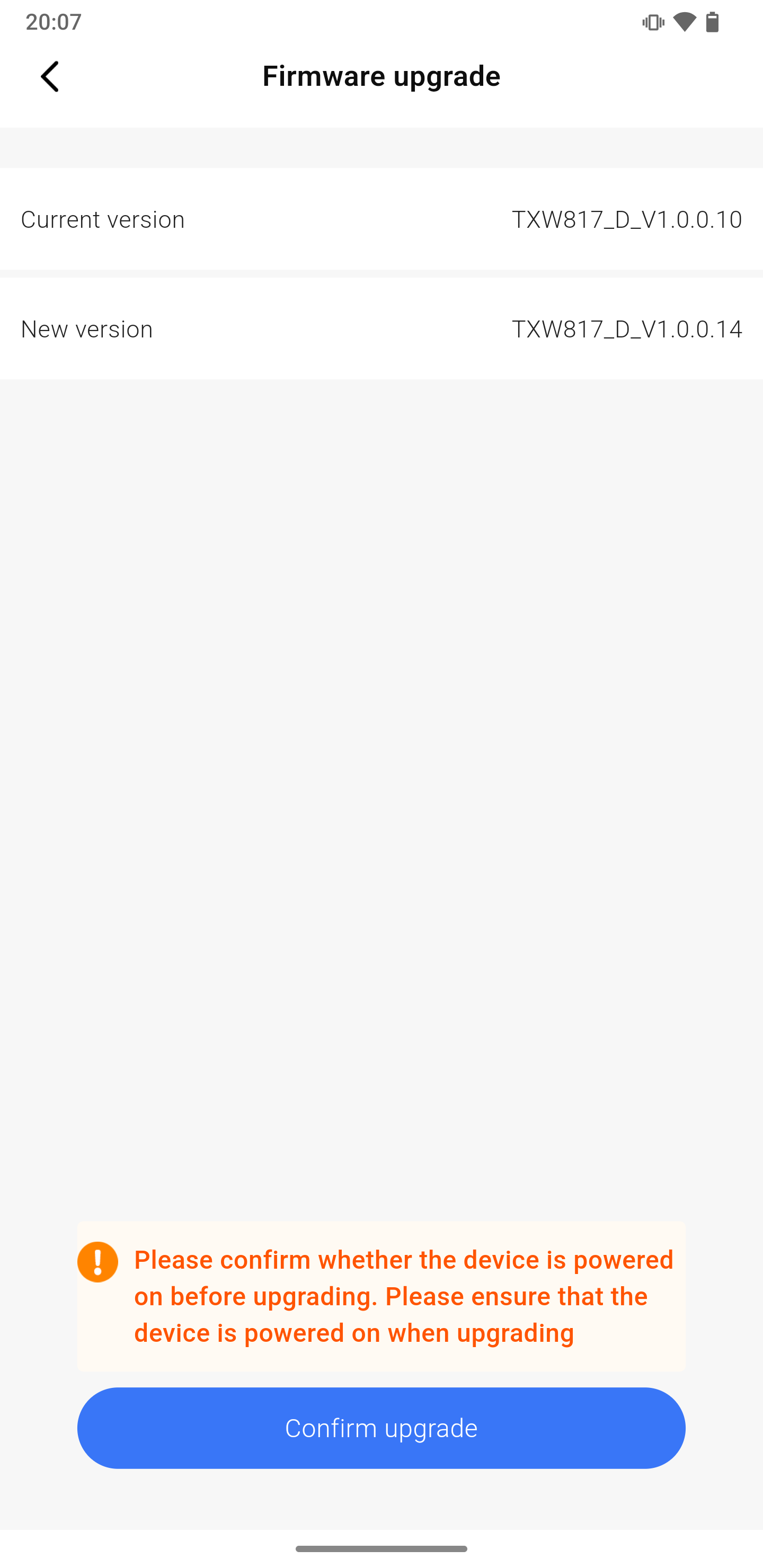

    Interesting it offers OTA update. Other A9 apps have the ability to check for and offer updates it seems, but this is the first I've seen actually have one available.
    Camera settings screen with sharing, management, and firmware update options Firmware update screen showing current and new version details

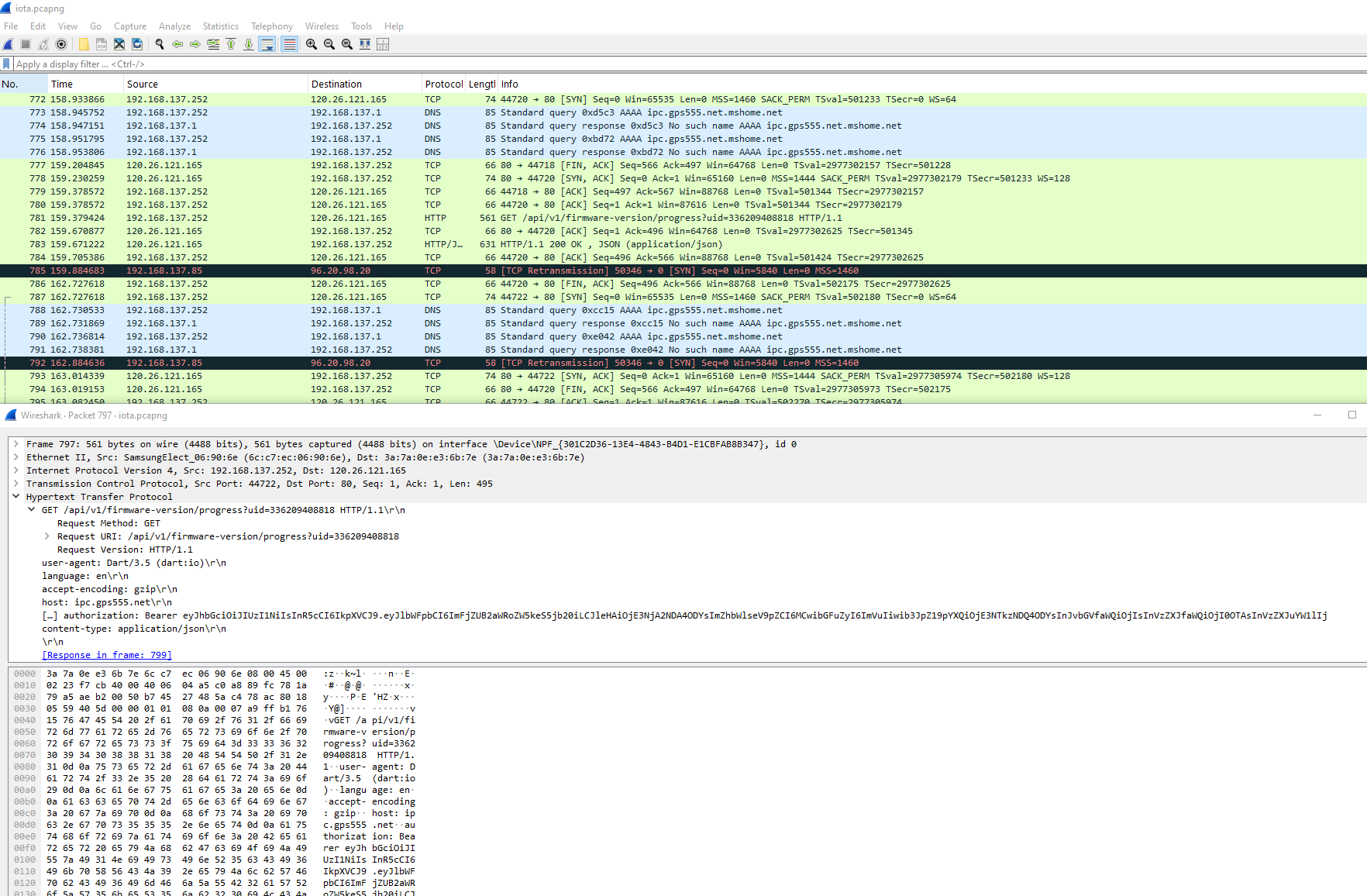

    Download attempts have so far been unsuccessful, repeating these firmware-version/progress?uid=xxxxx requests to ipc.gps555.net
    Wireshark screenshot showing HTTP GET packet with detailed headers

    ota file link seems dead
    http://sig.gps555.net/otabin/TXW817_D_V1.0.0.14.bin

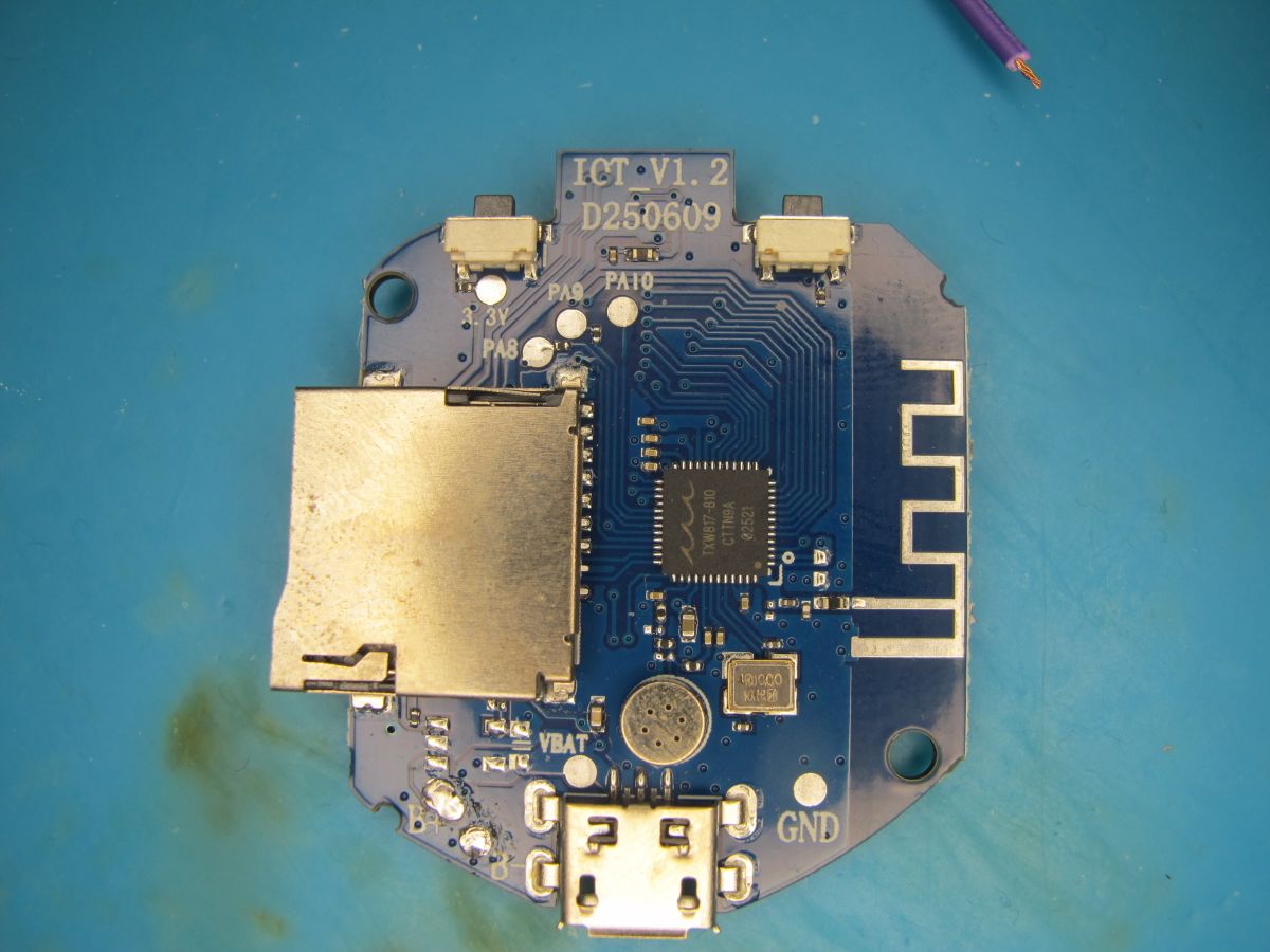

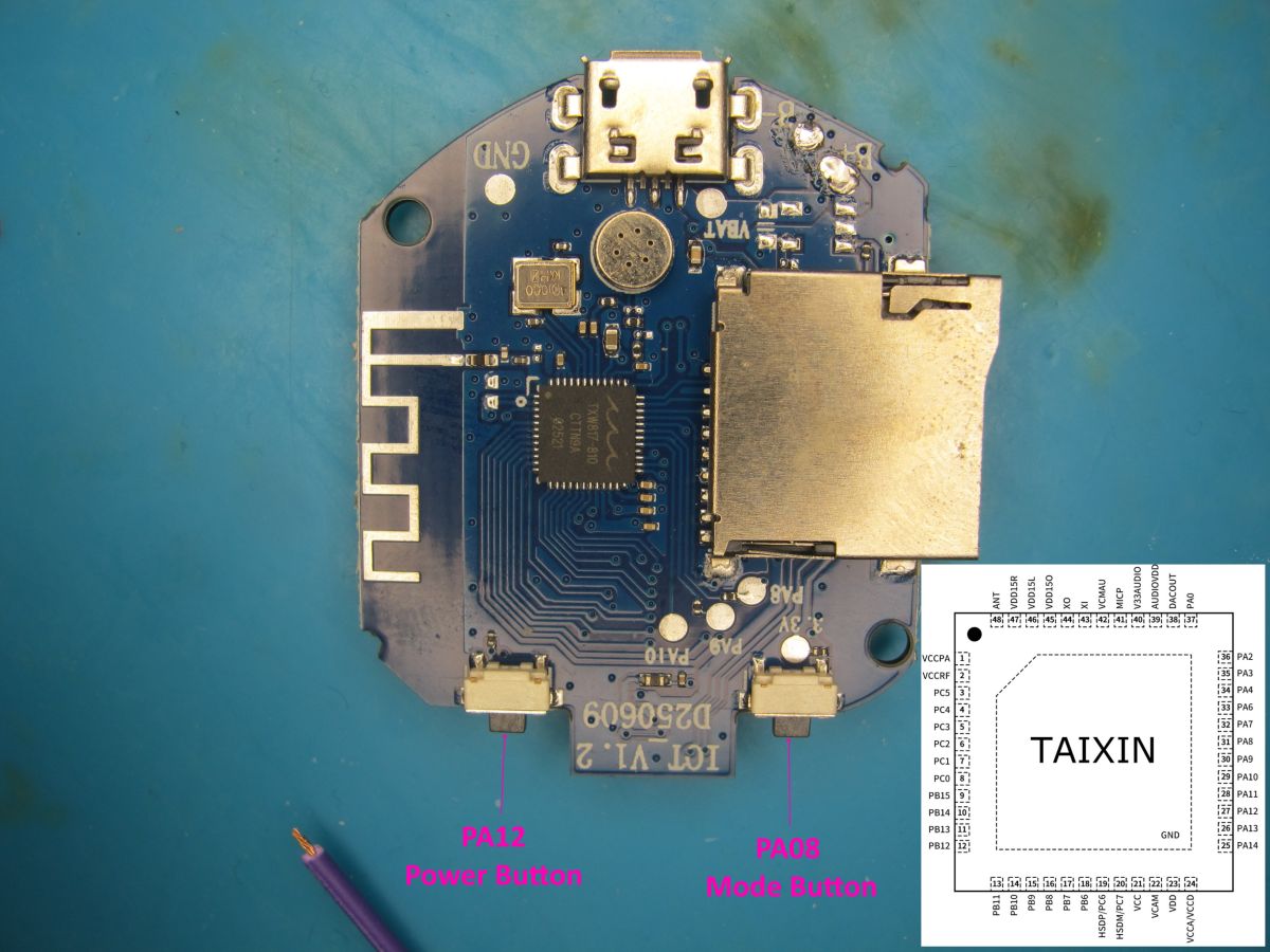

  • Pin mapping for buttons, LED, and sensor I2C
    #2 21708242
    Posts: 5202
    Help: 446
    Rate: 914
    PA06 - Blue LED
    PA08 - function button - works OK as standard Btn role
    PA12 - power button - no ack to pushes if set as Btn. Btn_n = Info:GEN:12 Button_OnLongPressHold
    Not sure at the moment how the power button and red LED are to be set, controlled, linked.
    PC02 - sensor SCL
    PC03 - sensor SDA
    Unlabeled blue PCB with I/O line markings and surface-mounted electronic components PCB with micro USB, SD card slot, and labeled PA12 Power and PA08 Mode buttons

    pergolafabio wrote:
    Did you successfully flash it using: https://github.com/openshwprojects/OpenBK7231T_App
    no. read/write flash is not possible via UART - requires 2-wire cJTAG (?) CK-Link connection - P10 (DebugCLK), P9 (DebugIO)
    CK-link Lite can be made easily with STM32 - https://www.elektroda.com/rtvforum/topic4120455.html - program STM32 via J-Link or UART
    Reading/writing with T-Head Debug Console or C-SKY Flash Programmer (easier): https://www.elektroda.com/rtvforum/topic4123724.html

    Ok. My hardware arrived to create the flash , like STM...
    I didn't open the A9 yet, but can you tell me where I can find those ?
    I don't see it in your posts. Or is it obvious when I open the cam? I also need to connect GND , right?
    identification of these will depend on the PCB inside the cam. There's a reasonable chance they've already been identified and there is a labelled picture in one of the posts. Open it up and take a pic?
    for when it comes to connecting up STM32 (converted to CK-Link Lite) to the A9 PCB, yes, a shared ground between the STM32 and the A9 cam ground will be needed.

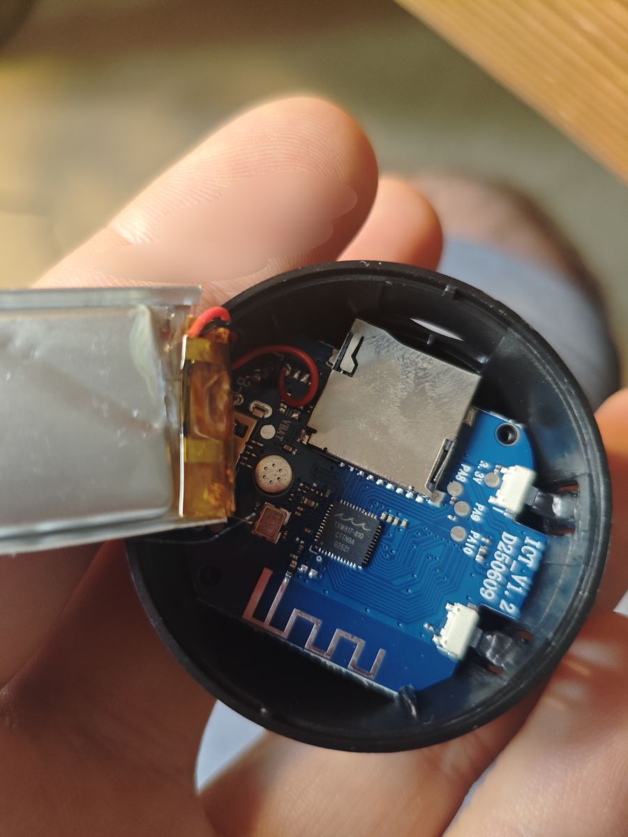

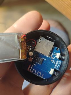

    pergolafabio
    Posts: 7
    hey @divadiow , opened it up, it's identical as yours, same numbers
    i was able to find GND :-), also the P10 and P9 , let's hope i have steady hands to solder :)
    Added after 23 [minutes]:
    ok, further reading before soldering
    since i have the same board as you
    what firmware do i need to flash?
    i see other people flashing txw81x_v2.5.2.6-31320_2025.5.25_IOT_AT_PC6-PC7.bin on this board?
    also some this one? => OpenTXW81X_1.18.221.bin
    i also notice this one: txw81x_v2.5.2.6-31320_2025.5.11_IOT_AT_PA1-PA2.bin
    What are those differences?
    thnx for all info, appreciated!
  • #11 21870615
    pergolafabio
    Posts: 7
    wow, it worked, succesfull flashed 2 cams!! :-)
    Now i need to see how i can confire the led
    also , if remove the usb cable, seems it immediately disconnects.shutdowns, it doesnt use the battery
