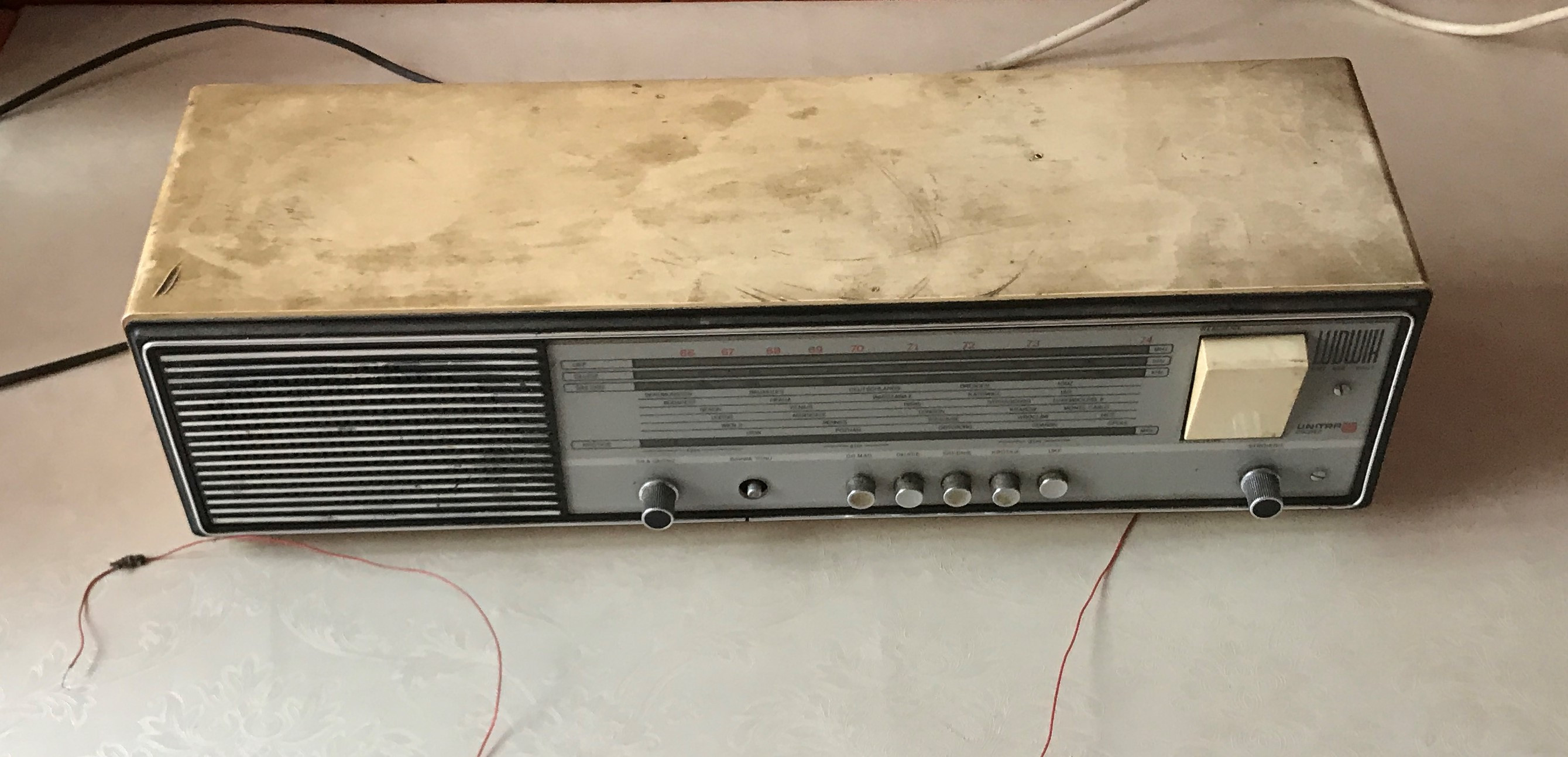

Old Polish Ludwik radio receiver from the 70s with a large rocker On/Off button on the right side of the front panel. .
I would like to invite you to another topic about an old Polish radio receiver, this time about a Ludwik from the 1970s, characterised by a large rocker On/Off button on the right side of the front of the case. This receiver allows you to listen to four ranges, standard long wave, medium wave, short wave and ultra short wave, whereby to listen to something in our time you would have to tune out the UKF, but to start with a look at the casing:
Vintage Polish radio receiver Unitra Ludwik from the 70s. .
Old Polish radio receiver Ludwik with a large On/Off button on the right side.
On the front, in addition to the range selector and volume control, we also have a tone knob and the option to switch to the tape deck connector.
