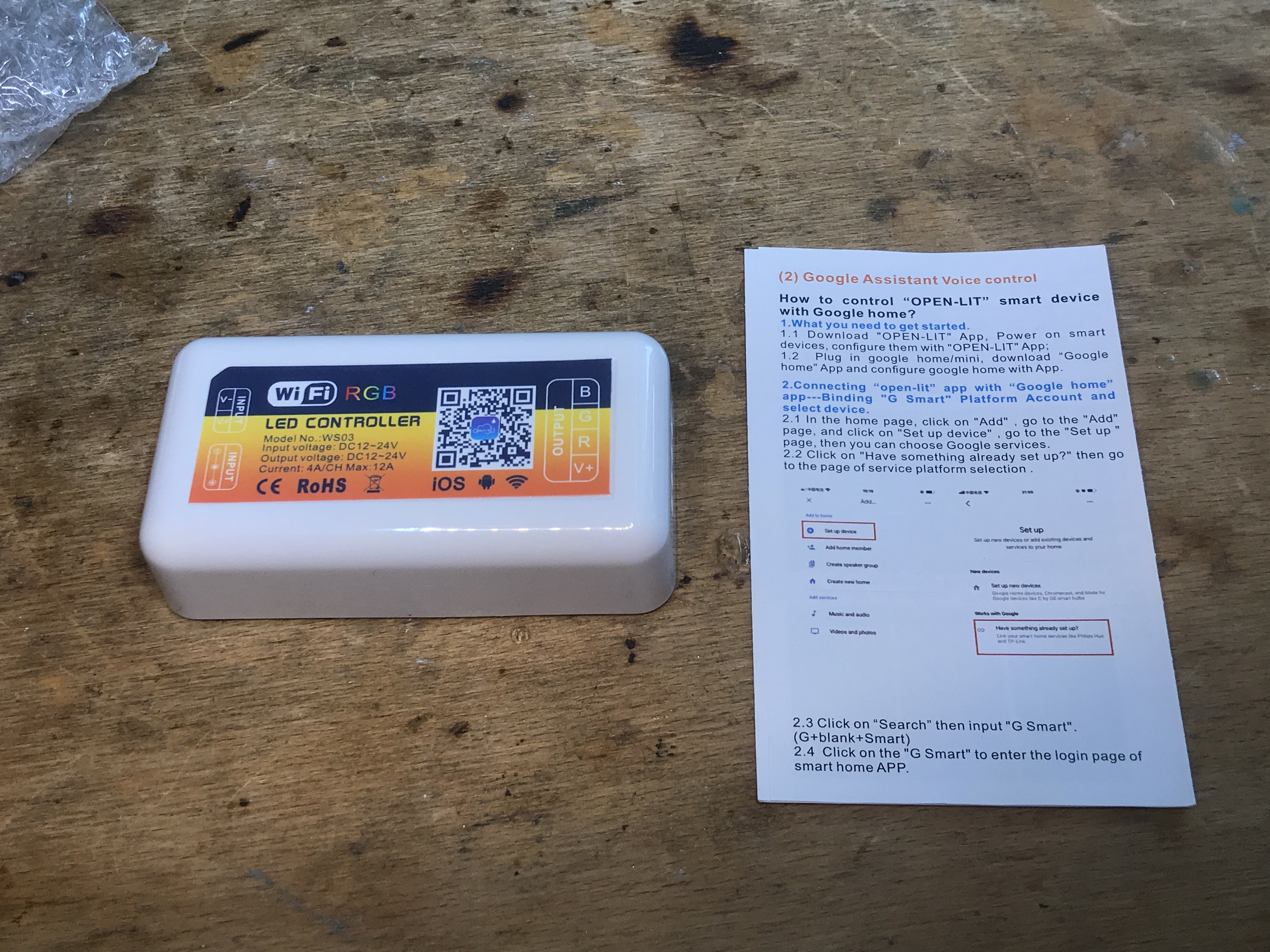

Today we are discussing another LED strip controller from a Polish auction site. This time the RGB version, i.e. intended for colorful LEDs. The controller is intended for the OpenLit mobile application, but we will flash it with Tasmota, as we usually do, in order to free it from the cloud and connect it locally with Home Assistant.
This product was given to me for free by a reader so that I could change his load. After programming, the product was returned to the reader. I received several other pieces of equipment in the set, including the related WF-M2 controller:

Set contents:
WS03 RGB LED controller and instruction manual on a wooden surface. LED strip controller WF-M2 in bubble wrap next to a user instruction manual.
I don't know where "Skills & Game" came from in this manual, but I haven't tested the application. Time to open the controller...
