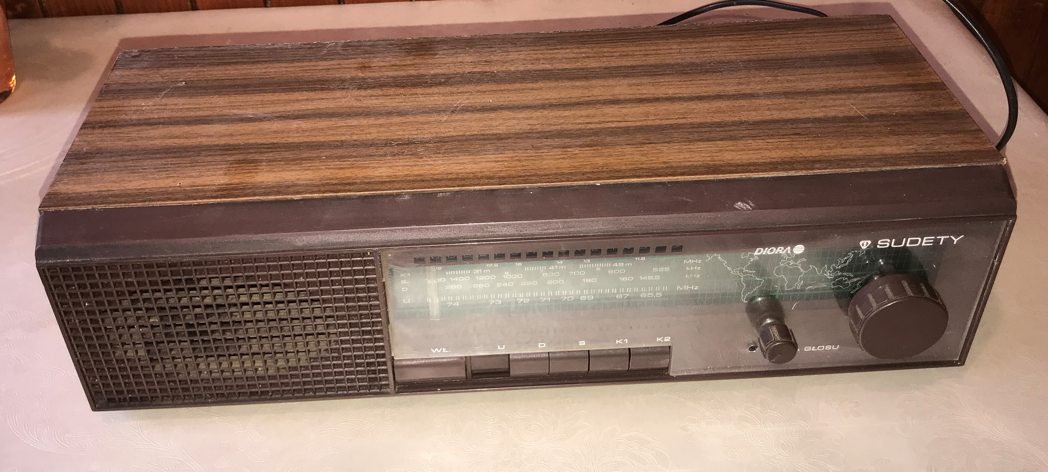

Vintage monophonic radio Unitra Sudety R-208 from 1987-1990 on a table. .
Today another short presentation of an old Polish monophonic radio, this time Unitra Sudety R-208 produced by Dior from the years ca. 1987-1990. This radio offers AM and FM reception and sound recording to an external tape recorder, supports the ranges of long wave (148.5-283.5 kHz), medium wave (526.5-1606.5 kHz), short wave (5.95-9.9 MHz and 11.65-21.85 MHz) and FM (65.5-74 MHz). Detailed sensitivity, power and power supply parameters can be found in the original manual attached to the subject.
