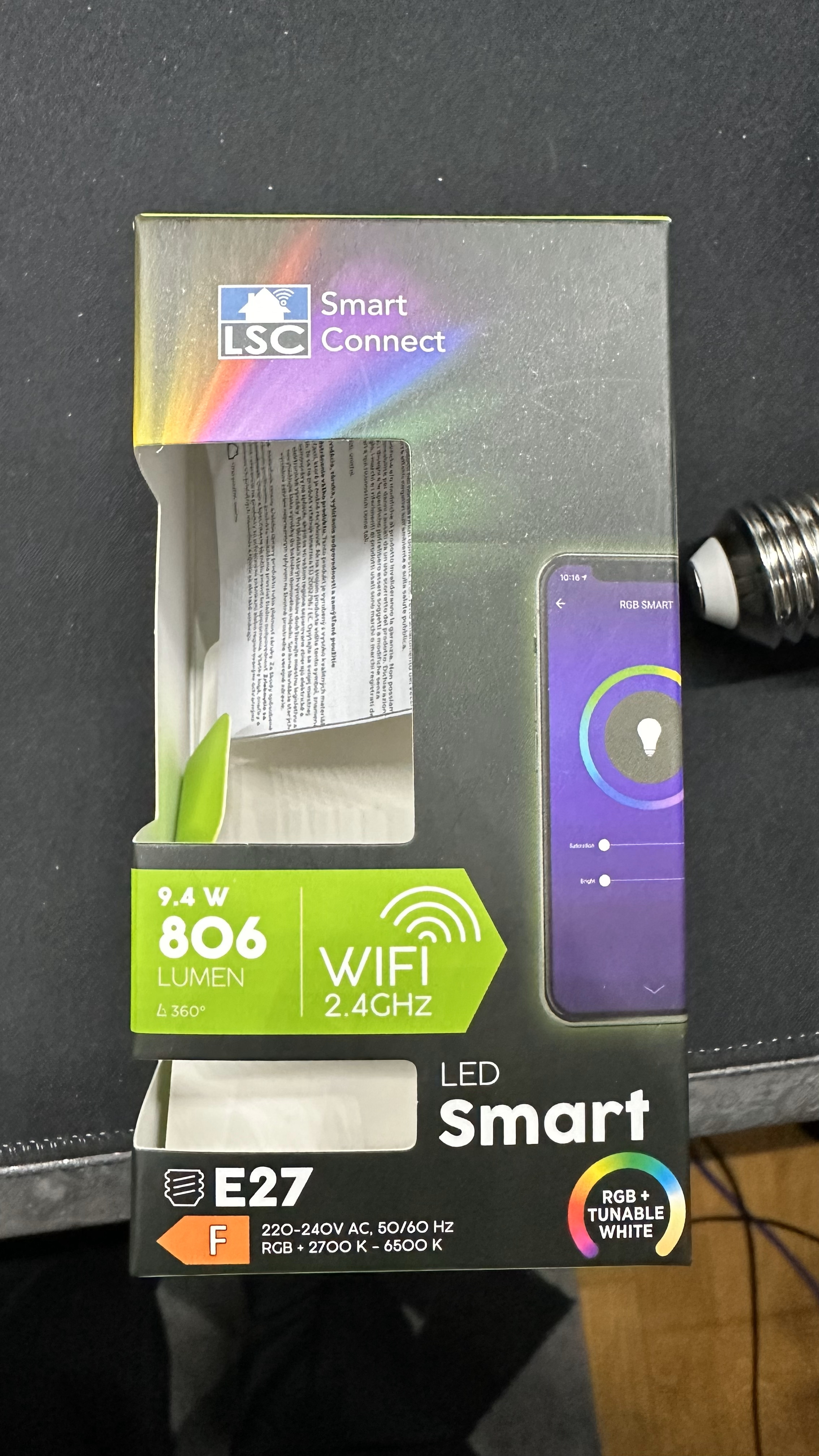

Empty packaging of LSC Smart Connect E27 bulb, displaying product specifications.
This is a new version of LSC/Action 2578539 bulb, previously described in this topic.
The new version is based on BK7231N instead of BK7231T, features Tuya firmware 1.3.21 FW and is flashable by TCC or by wires.
The pins used for BP5758D and colors remap were changed, so here I am attaching new template and photos provided by our reader.
First, device teardown:
Interior of LSC/Action 2578539 LED bulb showing electronic components. Close-up of the new LSC bulb, model number 2578539. Back of packaging with barcode and product information for LSC/Action 2578539 bulb.
New OBK template:
The newer versions of this device may be patched against WiFi flashing in the future, but it should be still possible to flash it by wires:
