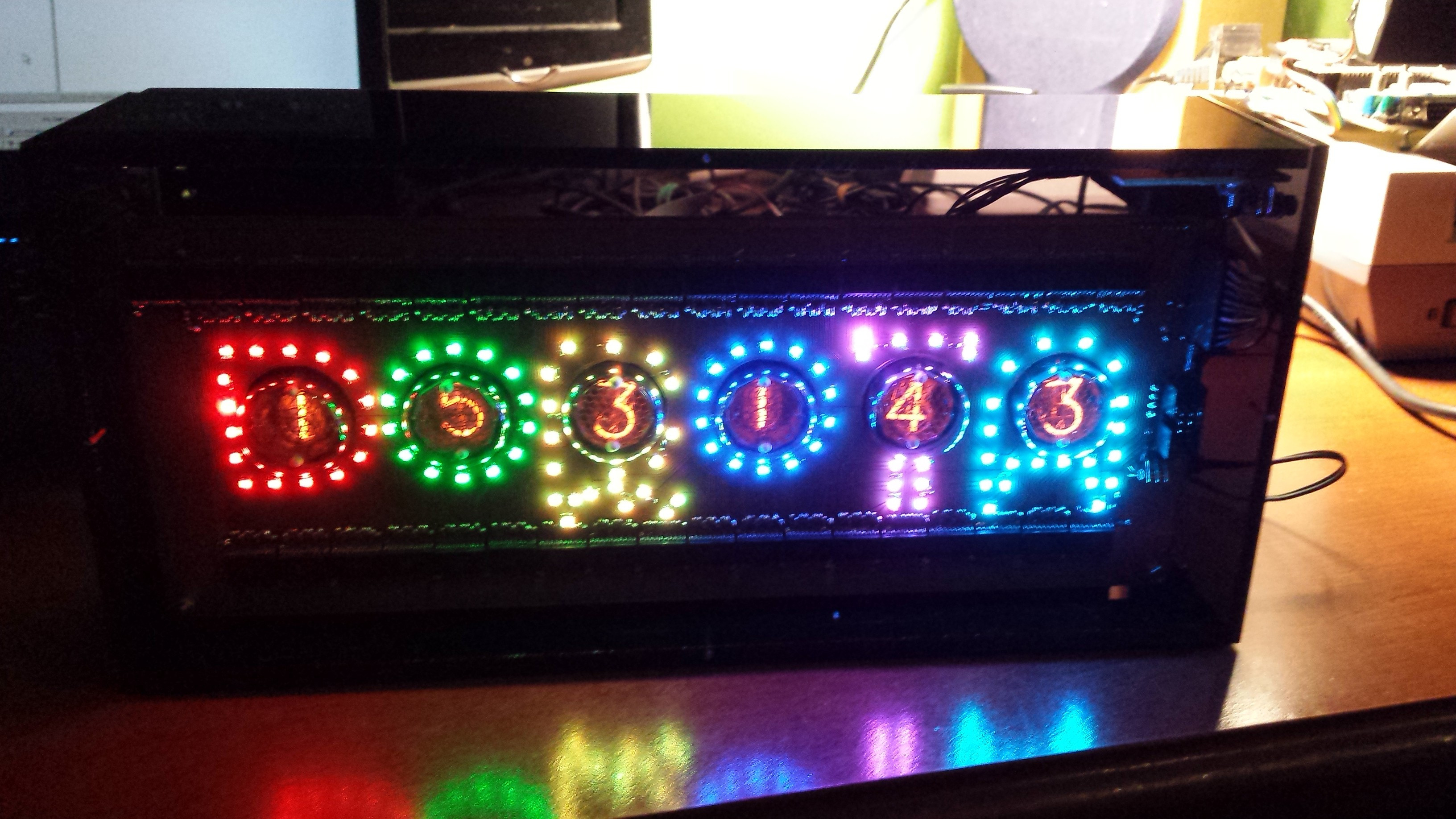

  • Built a personalized Nixie tube clock with LC-516 lamps and the name DOROTA illuminated by 96 miniature RGB LEDs.
  • Separated the design into two PCBs: an LED board and a lamp board, driven by an ATmega64, PCF8563 RTC, and 74574 latches.
  • The LED board uses 96 SMD 1206 RGB LEDs and 36 74574 chips, with multiplexed color control and 288 mini-tin jumpers.
  • Replacing the weak MPSA42 boost stage with an IRF740/MC34064 converter raised nixie current to 20 mA and made the tubes shine at full power.
  • Huge PCBs made transfer-etching, alignment, and soldering difficult, and permanently soldering the LC-516 tubes is generally not recommended.
Handcrafted nixie tube clock with colorful LED backlighting.
A special person deserved an equally special gift, and since I`m not a fan of buying surprises, I decided to "make" something with my own hands.

13. Final result
1. Introduction, motivation
Sometimes it`s hard to find someone`s taste, especially if we don`t know much about them, so I chose something universal and practical: a clock with Nixie tubes (after all, everyone likes to know what time it is).
However, to emphasize the `uniqueness` of the surprise and to make the recipient feel even more that it was something especially for her, I decided to personalize the gift in some way and put her name in it.
Since DOROTA has 6 letters and most of them have bellies inside, I came up with the idea that each letter would contain one number - a nixie lamp. The letters of the name will be illuminated with LED diodes, which will additionally add visual variety to the somewhat austere appearance of this type of clocks and give it a certain modernity.

Most clocks of this type are built on a single printed circuit board, but in this case, due to the relatively high height of the nixie lamps (several cm), the diodes should be placed flush with the very tip of the lamp, which forced the creation of two printed circuit boards - the first one with diodes. (and holes cut out), and the second one with lamps.
Nixie tube clock in a plexiglass case with LED backlighting.

11. Housing
The last, and most important from an aesthetic point of view, element of the design is the casing. Makers encase this type of clocks in wood and glass. However, I chose plexiglass due to the lack of carpentry facilities (and my attempts at cutting glass with an oil knife were, to put it mildly, average).
So I ordered 6 pieces of cut-to-size plexiglass. The recipient of the gift is crazy about the color black, so I chose graphite-colored smoked plexiglass (semi-transparent, allows about 20% of light through). Only the front glass is made of transparent plexiglass.
I glued the bottom, top, left and back boards with cyanoacrylate. I connected the right and front ones with M2 screws to make it possible to disassemble them if necessary. I drilled the large holes for the buttons and the power plug with a stepped conical drill at low speed.
I haven`t had much experience with plexiglass before, but I see that it`s a cool material. Only drilling/cutting requires either extremely slow speed or cooling. Otherwise it melts and smells like a dentist`s. And maybe if it wasn`t so electrified and didn`t attract all kinds of dust.
Nixie clock in a plexiglass case with exposed tubes and electronic components. Control panel of nixie tube clock with buttons on a black casing Black plexiglass enclosure on a wooden floor Handcrafted nixie tube clock with colorful LED backlighting.

12. Software
I defined such a nice bit structure
#define COLOR_LEVELS_BITS 2
struct rgb_t {
	uint8_t r : COLOR_LEVELS_BITS;
	uint8_t g : COLOR_LEVELS_BITS;
	uint8_t b : COLOR_LEVELS_BITS;
	uint8_t a : COLOR_LEVELS_BITS;
thanks to which each component can take 4 different values and I can encode 64 colors on one byte.
The main variable storing the state of what I want to display on the diodes is the buffer
#define LED_COUNT 96
volatile struct rgb_t leds[LED_COUNT + 1];
thanks to this, if I want to set which diodes should be lit - just set the appropriate components of a given diode, e.g. turning on the LED10 in yellow:
leds[10].r = 3;
leds[10].g = 3;
leds[10].b = 0;
Initially, the idea was that counter 0 reports an interrupt at least 540 (60 * 3 * 3) times per second and
* after 1 request, we turn on the R component of all diodes if its component R = 1,2,3 in the buffer
* after the second request, we turn on the R component of all diodes if its component R = 2.3 in the buffer
* after the third notification, we turn on the R component of all diodes if its component R = 3 in the buffer
* after the 4th request, we turn on the G component of all diodes if its component G = 1,2,3 in the buffer
* after the 5th notification, we turn on the G component of all diodes if its component G = 2.3 in the buffer
* after the 6th notification, we turn on the G component of all diodes if its G component = 3 in the buffer
* after the 7th request, we light the G component of all diodes if its B component in the buffer = 1,2,3
* after the 8th request, we light the G component of all diodes if its B component in the buffer = 2.3
* after the 9th request, we turn on the G component of all diodes if its B component = 3 in the buffer
Thanks to this, if the component:
=0 - the diode is on for 0/9 of the time
=1 - the diode lights for 1/9 of the time
=2 - the diode lights for 2/9 of the time
=3 - the diode lights for 3/9 of the time
(lighting time proportional to the component value and you can actually get 64 different colors).
Timing diagram for RGB LED control.
//timer1.png
However, even when turned on only 1/9 of the time, the diodes were too bright compared to the Nixie lamps (I used 330R resistors for the diodes, which forced a current of 10mA for the R diode and 5mA for the G/B diode.
To dim the LED world, I added additional dead periods in which none of the LEDs are lit. I also had to increase the counter frequency to 1953 Hz (16MHz / prescaler 32 / overflow every 256 cycles).
The counter frequency must be selected so that a single color does not flash less than 60 times per second - otherwise unpleasant shaking will be visible.
The nixie tubes are also multiplexed in the same interrupt.
Real-time clock support
The PCF8563 clock uses the I2C protocol, but hardware implementation was not possible because the SCL (PD0) line is used as USBD+ in the V-USB driver, so I had to write a simple software implementation.
13. Final result
After two months of work, I think it worked. In the attached video you can see the flashing, but in reality it is of course not there. And although a real smile cannot be bought or made, the recipient seemed to like it.
