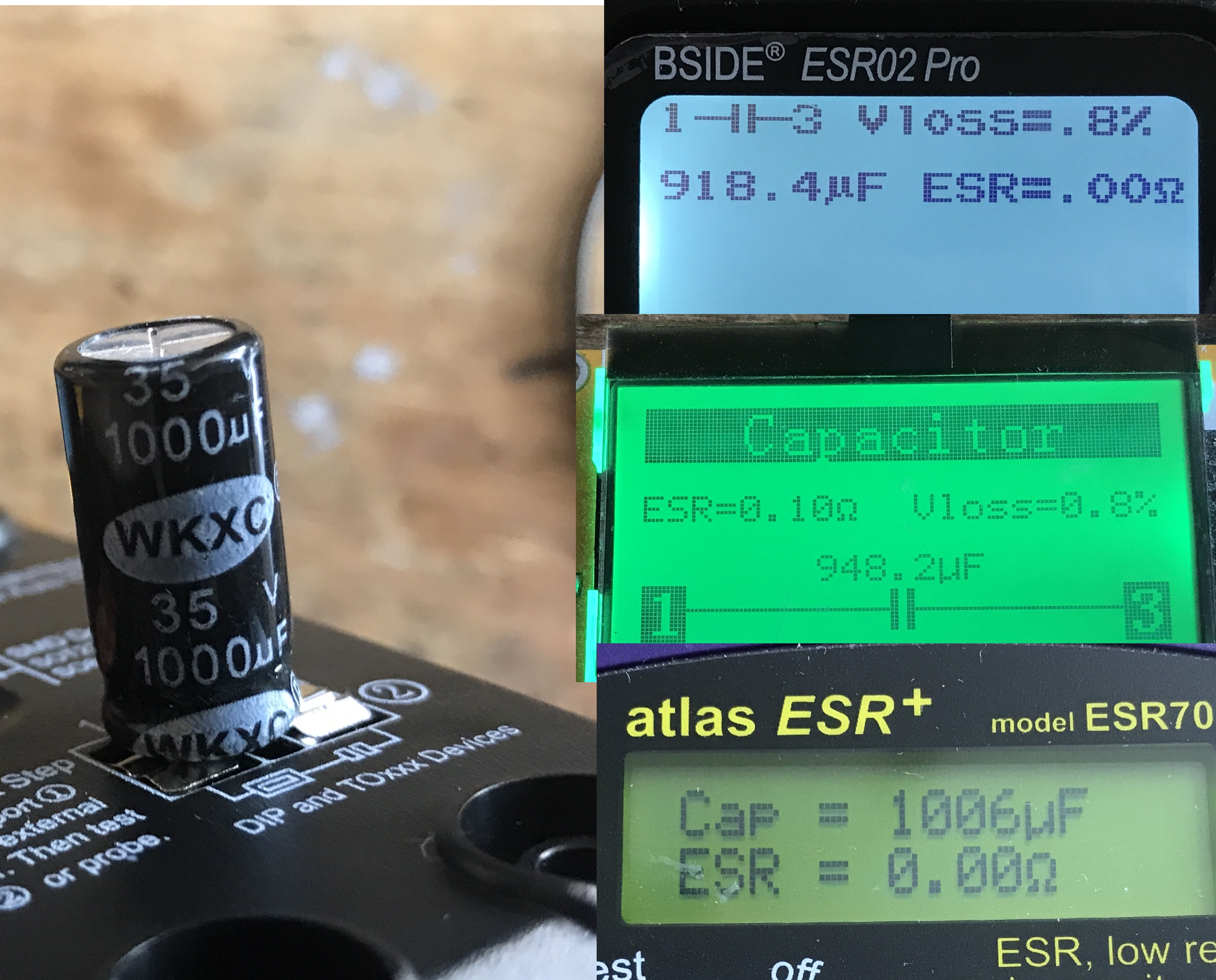

Comparisons and tests
Now I`m comparing the results from BSIDE ESR02 Pro with other testers, depending on what I measure there will be other competitors, because e.g. ESR70 only measures ESR... let`s start with capacitors:
Comparison of ESR measurements on a capacitor by different testers.
BSIDE ESR02 Pro component tester displaying capacitor measurement results. Comparison of capacitor measurement results using different testers. BSIDE ESR02 Pro tester compared with other ESR testers. Component testers: BSIDE ESR02 Pro, LCR-T4, Atlas ESR+ BSIDE ESR02 Pro component tester compared with other devices. BSIDE ESR02 Pro tester displaying ESR measurements of a capacitor. Comparison of readings from BSIDE ESR02 Pro and Atlas ESR+ testers while testing a capacitor. Example of capacitor testing using BSIDE ESR02 Pro and Atlas ESR+ testers.
Comparison of capacitor test results using BSIDE ESR02 Pro, LCR-T4, and ESR70 testers.
LCR-T4 seems to slightly overestimate ESR, or maybe the other two underestimate it?
