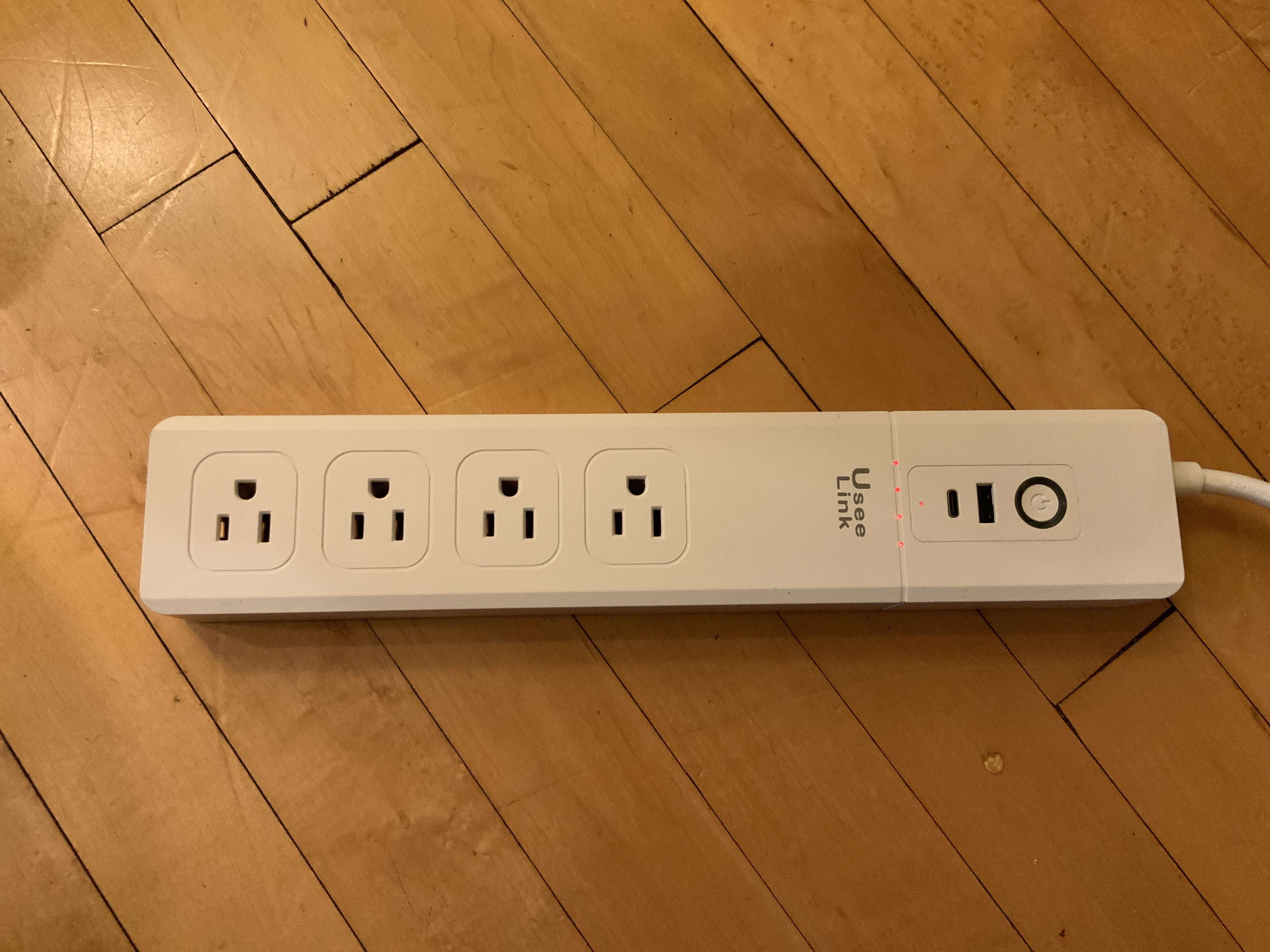

  • Tuya Usee Link USB-C PD Surge Protector SM-306U-PA65 uses a BK7231N CBU board with a JSON pin setup for its relays and LEDs.
  • The pin map assigns GPIO 6, 7, 8, 9, and 24 to Rel1–Rel5, GPIO 17 to LED6, GPIO 22 to Btn_Tgl_All8, and GPIO 28 to WifiLED7.
  • Keywords identify it as a 4-port USB-C PD powerstrip, and the configuration file includes the device image and wiki link.

JSON file for the realys, and leds.
  "vendor": "Tuya",
  "bDetailed": "0",
  "name": "Usee Link USB-C PD Surge Protector",
  "model": "SM-306U-PA65",
  "chip": "BK7231N",
  "board": "CBU",
  "flags": "1024",
  "keywords": [
    "USB-C PD",
    "4-port",
    "Powerstrip"
  "pins": {
    "6": "Rel;1",
    "7": "Rel;2",
    "8": "Rel;3",
    "9": "Rel;4",
    "17": "LED;6",
    "22": "Btn_Tgl_All;8",
    "24": "Rel;5",
    "28": "WifiLED;7"
  "command": "",
  "image": "https://obrazki.elektroda.pl/7345684300_1704571106_thumb.jpg",
  "wiki": "https://www.elektroda.com/rtvforum/topic4026639.html"

You may also consider using click events script for this device. See: https://github.com/openshwprojects/OpenBK7231T_App/blob/main/docs/autoexecExamples.md Search for: Configuration for 4x socket... [Read more]
