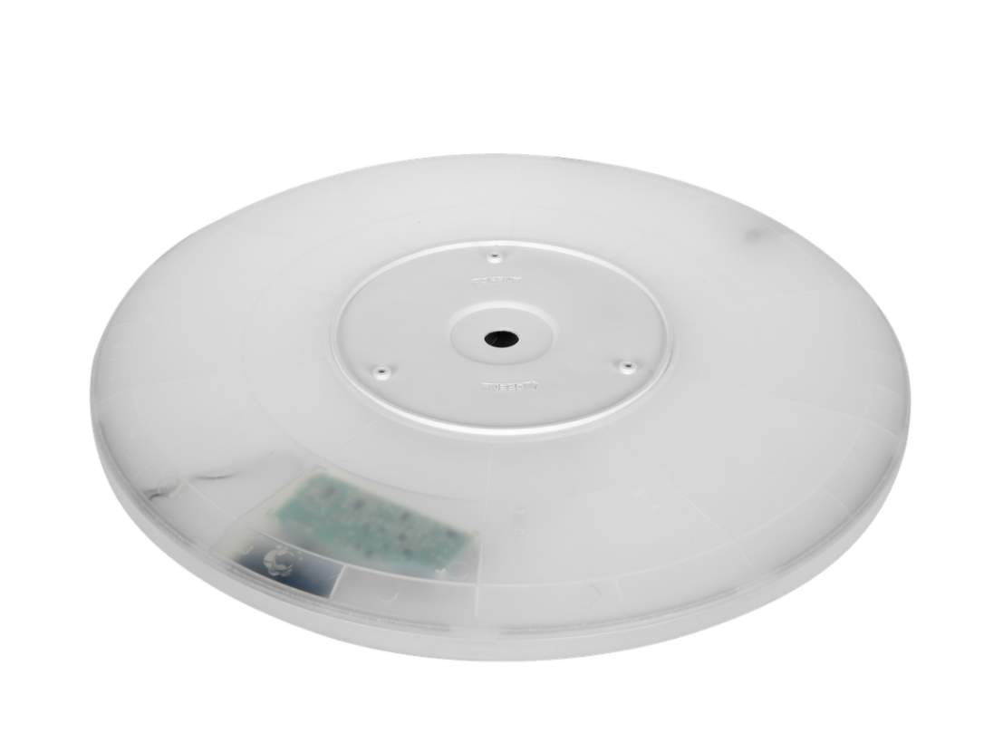

  • Anslut halo LED light teardown covers the 42 cm 22 W model and also applies to the 29 cm 14 W version.
  • The fixture uses a BK7231T chipset and was flashed over UART with OpenBK.
  • OpenBK version 1.17.398 was used successfully for the flashing process.
View of the casing of a flat, round Anslut LED lamp.
Teardown of Anslut 42cm 22w halo LED light
also applies to 29cm 14w model
Jula store webpage featuring an advertisement for the Anslut 42 cm 22 W Smart LED ceiling light.
https://www.jula.se/catalog/el-och-belysning/...husbelysning/takarmaturer/plafond-led-024724/
Contains Chipset BK7231T
Flashed over uart with version 1.17.398 of OpenBK
Label on Anslut Halo LED lamp with 22W power Interior of a disassembled LED lamp showing the electronic circuitry and a chipset BK7231T board.
