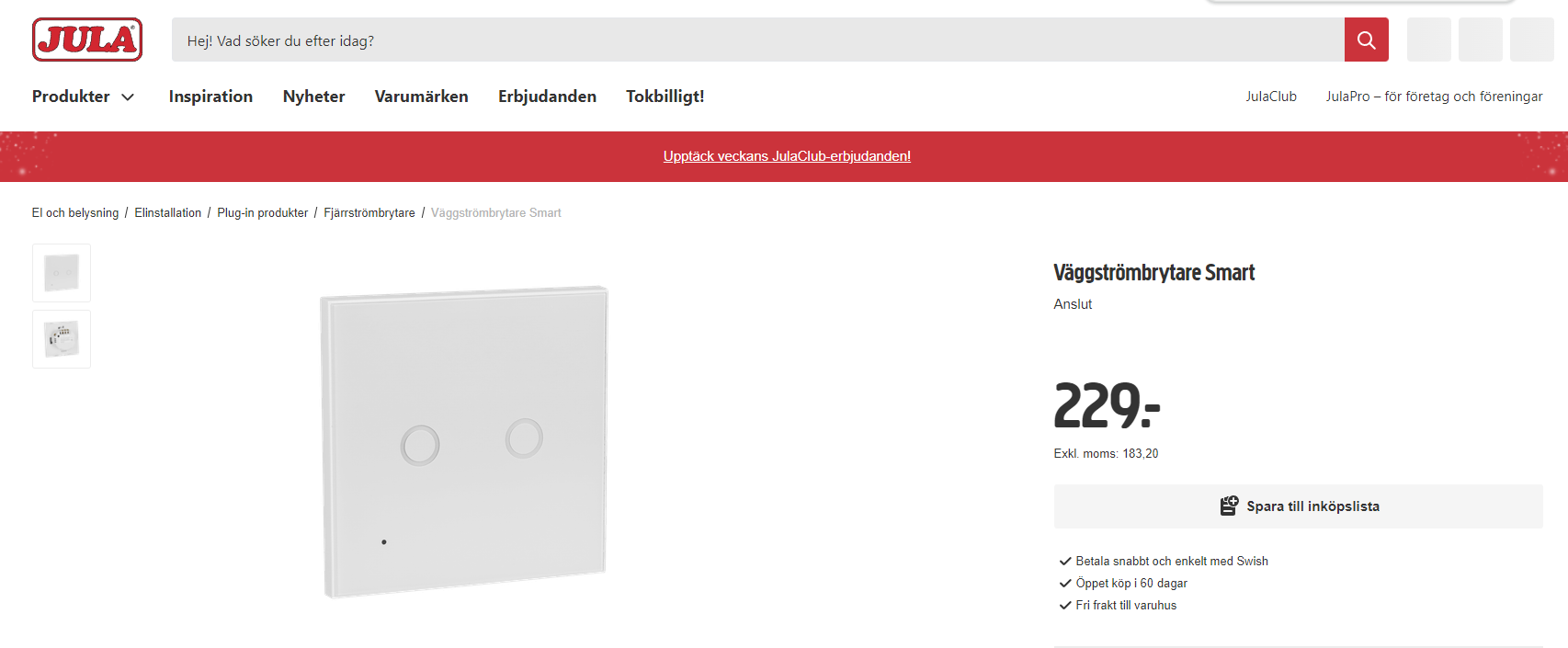

  • BK7231N-based Anslut smart wall switches are covered in 1-, 2-, and 3-button versions from Jula.
  • The teardown highlights neatly labeled pins on the top right, which simplifies identification and flashing.
  • The switches were flashed with openBK version 1.17.398.
Anslut smart wall switch 1, 2, and 3 buttons
Product webpage displaying the Anslut smart wall switch.
https://www.jula.se/catalog/el-och-belysning/...er/fjarrstrombrytare/vaggstrombrytare-025900/
Pins are nicely labeled on the top right
flashed with version 1.17.398 of openbk

p.kaczmarek2 13 Jan 2024 15:36
Thank you for sharing template for 2 gang version. Do you also happen to have template for 3 gang one? [Read more]
