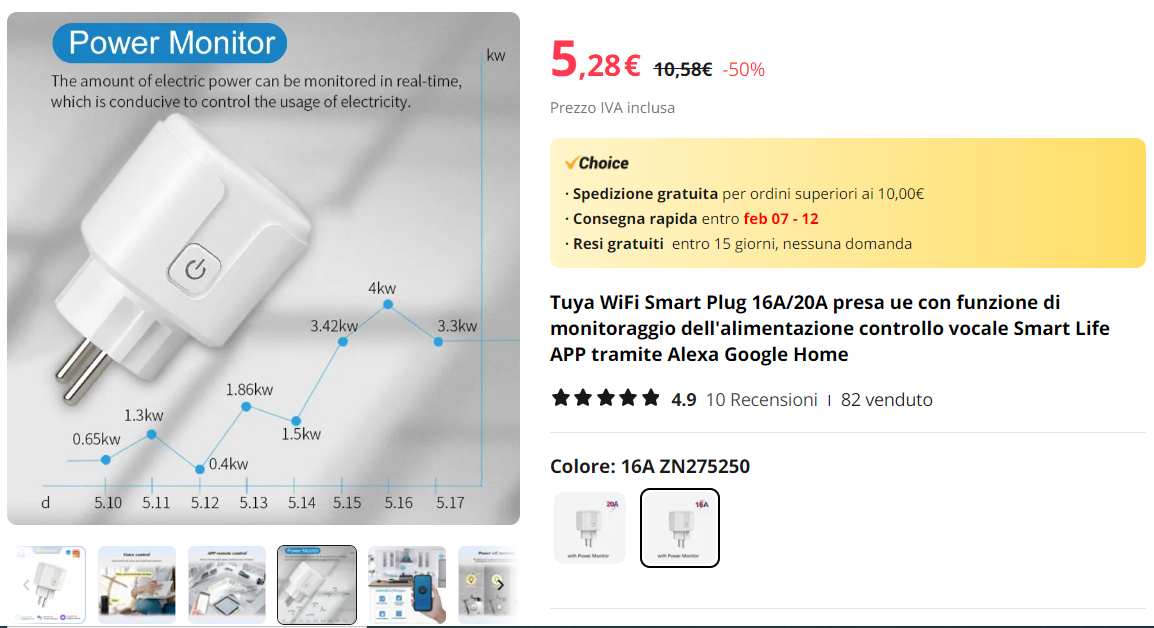

I use all the information read from this forum to "update" and free from Chinese server a 16A plug device with energy meter.
Advertisement for Tuya WiFi Smart Plug with energy monitoring function.
I bought it from Aliexpress site:
https://it.aliexpress.com/item/10050059683013...t_main.58.65863696sd18bs&gatewayAdapt=glo2ita
