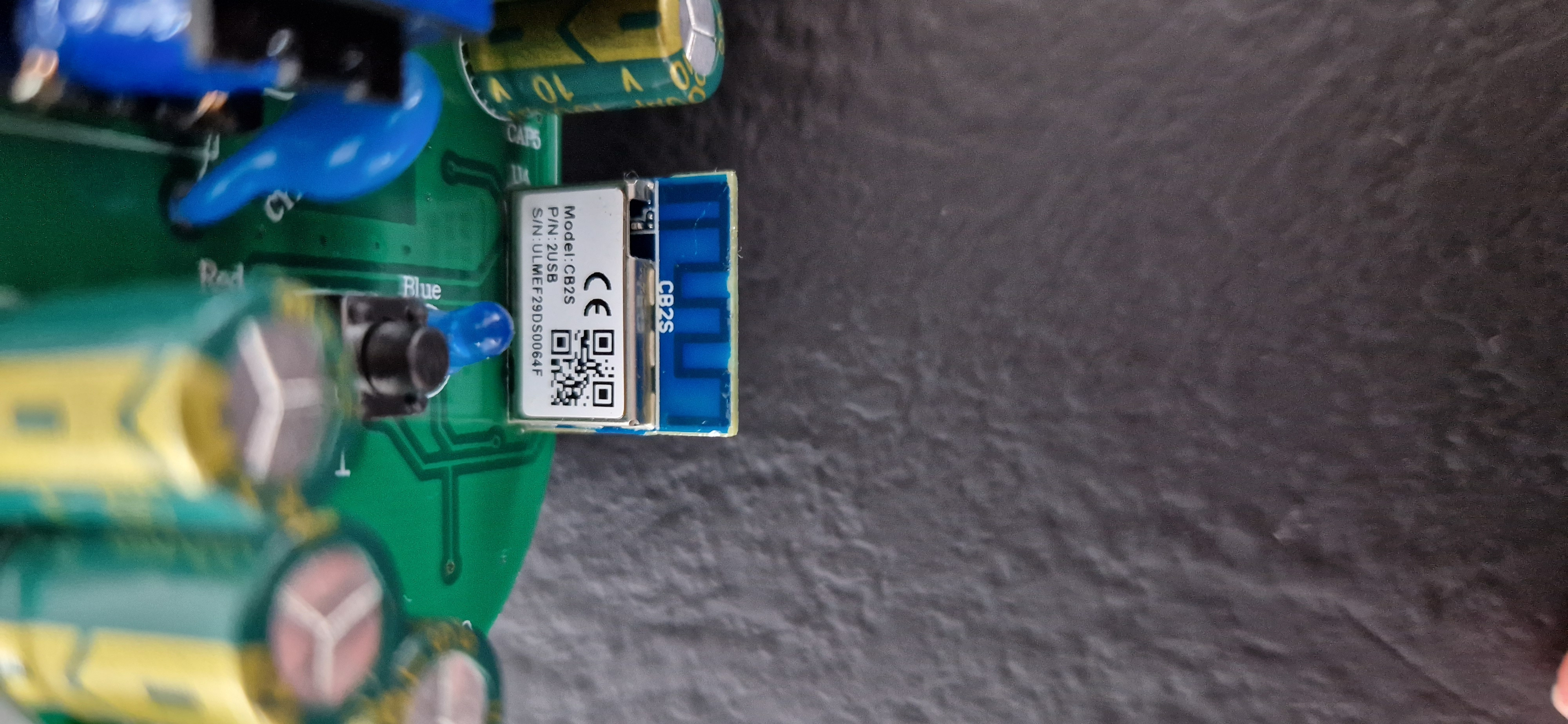

Hi,
Recently I have bought this socket https://www.aliexpress.com/item/1005005583141499.html?spm=a2g0o.order_list.order_list_main.88.26e8180268ZrMC which is similar to https://www.elektroda.com/rtvforum/topic3892473.html#20014441 with some differences. Pinout is slightly different and has 3 relays.
- Relay (channel 3) on P7
- Pair/Toggle All Button on P10
- WiFi LED on P8
- Relay (channel 2) on P24
- Relay (channel 1) on P26
Device seems to be using CB2S module, which is using BK7231N.

OpenBeken template:
  "vendor": "Tuya",
  "bDetailed": "0",
  "chip": "BK7231N",
  "board": "TODO",
  "flags": "0",
  "keywords": [
    "TODO",
    "TODO",
    "TODO"
  "pins": {
    "7": "Rel;3",
    "8": "LED;0",
    "10": "Btn_Tgl_All;0",
    "24": "Rel;2",
    "26": "Rel;1"
  "command": "",
And some pictures
Close-up of a green circuit board with a CB2S module and capacitors.
Image of the inside of a smart socket with visible PCB and electronic components.
White electrical outlet with two USB ports and a power button.
White Wi-Fi Smart Socket with model and specification label.
Close-up view of an electronic device's printed circuit board.
Close-up of a circuit board with electronic components, including relays and a module.
Added after 18 [minutes]:
Because I am new with openbeken I'am seeking some help.
I don't know if I'm doing something wrong:
1. It appears that LED light shows as Button. If I toggle the blue light turns on and off, without any relay changes
2. Btn Toggle All is missing in web gui
3. Is it possible to include Btn toggle all to Home Assistant using mqtt?
4. How can I configure the relay's last state? After wifi reconnects, Relay 0 is switched on, but USB relays are off.
Thank you

p.kaczmarek2 01 Feb 2024 21:27
Thank you for posting the teardown. I can try to help with your issues: That's how you have it configured: "pins": { "7": "Rel;3", "8":... [Read more]
mihcc 02 Feb 2024 11:45
Hi, Thank you for your fast reply. 1. I changed to LED because I had problems with LED status. Now I changed P8 to WifiLED and it works as expected. I did not want the blue light to be turned on. So... [Read more]
p.kaczmarek2 02 Feb 2024 12:01
Channel 0 is not for WiFi LED. WiFi LED is channel-independent. I think that channel 0 is unused in your case, you have relays set for channel 1, 2 and 3. The channel 0 may be visible on Startup... [Read more]
