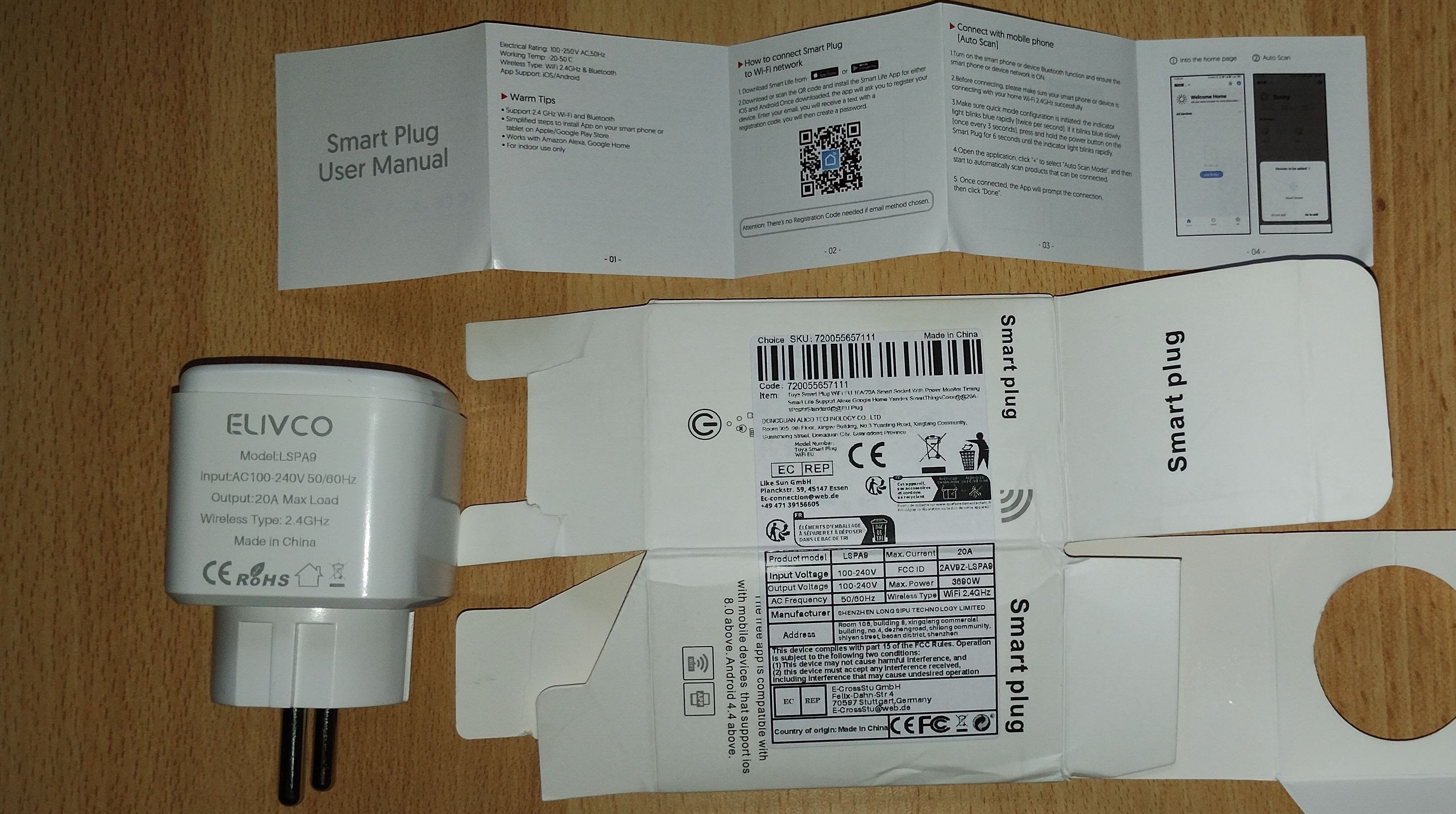

ELIVCO LSPA9 smart plug with user manual and packaging ELIVCO smart plug with packaging.
So, why another post? I think I might give some useful information here, so I hope it's o.k.
(If there should not be a new post, for the same device, please move it into one of the other posts)
