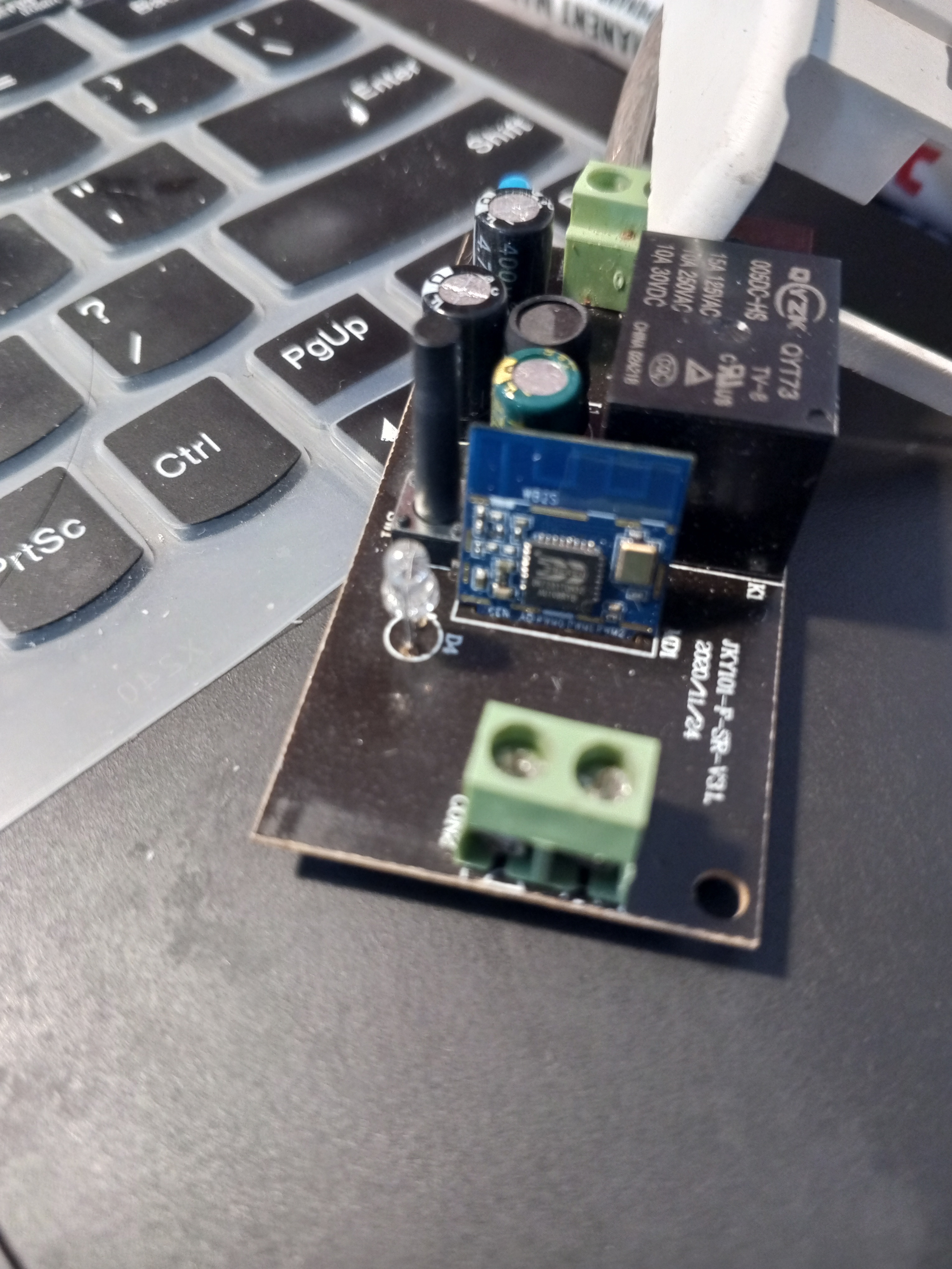

  • Bardi ON Off Breaker JKY101-F-SR-V31 is an Indonesia product from Bardi.
  • It is rated for a maximum load of 10A and uses the JKY101-F-SR-V31 model.
  • The WiFi module uses WB2S with the BK7231T chipset.
Bardi ON Off Breaker (max load 10A - JKY101-F-SR-V31) an Indonesia product by brand Bardi (https://bardi.co.id/product/on-off-breaker/) for who using it this is the templates. The chipset is using WB2S / BK7231T.
Electronic switch module on a laptop keyboard.
OpenBK7231T system interface with the switch in OFF state.
Configuration interface for the Bardi ON Off switch with PWM and GPIO values.

And here is OBK JSON: { "vendor": "Bardi", "bDetailed": "0", "name": "Bardi On Off Breaker", "model": "JKY101-F-SR-V31", "chip": "BK7231T", "board": "WB2S", "flags": "1024", ... [Read more]

Key insight: The thread gives a complete OpenBeken template for one exact device variant: Bardi ON Off Breaker, model JKY101-F-SR-V31, using a WB2S module with a BK7231T chip and three mapped functions on pins 6, 7, and 24. [#20968657]
  • The product is the Bardi ON Off Breaker, model JKY101-F-SR-V31, and the thread states a max load of 10A. [#20966402]
  • The posted OpenBeken template identifies the hardware as WB2S board + BK7231T chip. [#20968657]
  • The JSON maps exactly 3 active pins: pin 6 as Btn;0, pin 7 as LED_n;0, and pin 24 as Rel;0. [#20968657]
  • The template metadata tags it with keywords for Indonesia, single smart switch, and single relay, which helps classify the device quickly. [#20968657]
  • The thread includes 3 PCB photos in the first post and a separate image plus wiki reference inside the JSON template. [#20966402]
