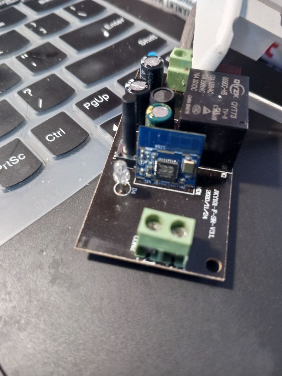

    Electronic switch module on a laptop keyboard.

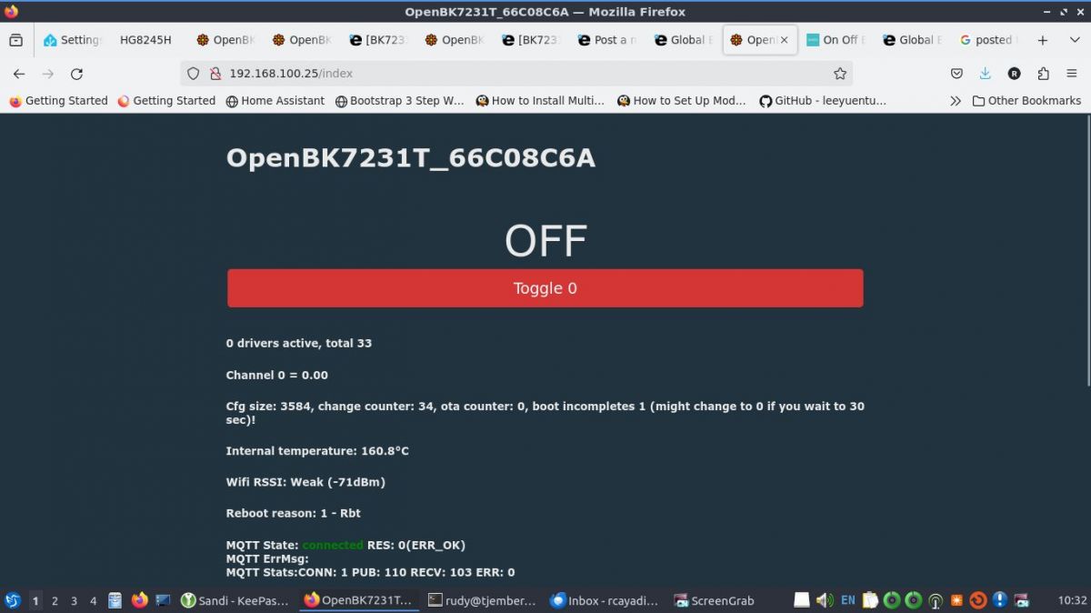

    OpenBK7231T system interface with the switch in OFF state.

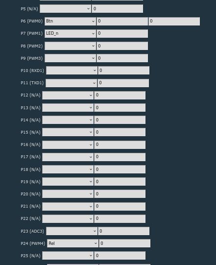

    Configuration interface for the Bardi ON Off switch with PWM and GPIO values.

Key insight: The thread gives a complete OpenBeken template for one exact device variant: Bardi ON Off Breaker, model JKY101-F-SR-V31, using a WB2S module with a BK7231T chip and three mapped functions on pins 6, 7, and 24. [#20968657]
  • The product is the Bardi ON Off Breaker, model JKY101-F-SR-V31, and the thread states a max load of 10A. [#20966402]
  • The posted OpenBeken template identifies the hardware as WB2S board + BK7231T chip. [#20968657]
  • The JSON maps exactly 3 active pins: pin 6 as Btn;0, pin 7 as LED_n;0, and pin 24 as Rel;0. [#20968657]

The thread provides a full OBK JSON template for this exact breaker. It identifies vendor Bardi, name Bardi On Off Breaker, model JKY101-F-SR-V31, chip BK7231T, board WB2S, flags 1024, and three pin roles: 6=Btn;0, 7=LED_n;0, 24=Rel;0. It also includes an image field and a wiki field for reference. [#20968657]
Which GPIO pins are assigned to the button, LED, and relay on the Bardi JKY101-F-SR-V31 with a WB2S module?
The posted template assigns pin 6 to the button, pin 7 to the LED, and pin 24 to the relay. In OpenBeken syntax, those roles are Btn;0, LED_n;0, and Rel;0. That gives this device one button input, one LED output, and one relay output in the shared mapping. [#20968657]
