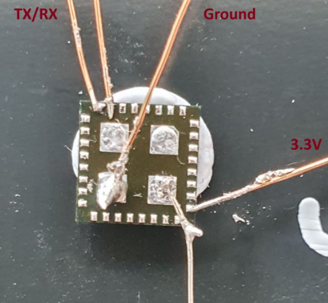

Here is how you can flash a T34-based wall switch with OpenBeken. This switch has no programming pads available, so desoldering T34 in QFN case is required.
Nothing special in the box, comes with a capacitor and some screws, and a wiring diagram.
Teardown is very straightforward, a flat head screwdriver is all that is required: Just gently lever the front glass off (There is an opening at the bottom for this purpose). Removing the motherboard is as simple as unclipping 4 plastic clips and lifting it up. It is joined to the back via 6 pins.
Flashing is a lot less straightforward. This switch came patched for the cloudcutter exploit. (Firmware 1.3.10).
The 4 pads on the board don't appear to be connected to the T34 which is the brains of the operation. The far right pad is 3.3V, the one next to it is GND, unsure of the other two.
All the pins of the T34 are hidden, so flashing is non-trivial. I had to hot air desolder it, solder some jumper wires, and then dump/flash it via bk7231flasher. Miraculously, I managed to resolder it successfully. This is not for the faint of heart.
The dump also failed to extract the tuya config, but I was able to reverse it via inspection.
Hope this is helpful to someone, but I would strongly advise not purchasing this one. With the T34 package, and no exposed pads or silk screen, these are non-trivial to flash.

This is the most pro way of flashing I've ever seen here:
https://obrazki.elektroda.pl/5096754300_1708325564_thumb.jpg
Just a quick question - was using CEN really necessary? [Read more]
CameronDev
19 Feb 2024 08:56
A pro wouldn't have taken 3 hours to do it :D
Don't know, I didn't try without grounding CEN. I just read somewhere that I needed to ground it.
Either way, TX/RX are also inaccessible, so it required... [Read more]

Hi @camerondev
How did you apply the solder paste to the back chip?
Do you cover the entire back or just meticulously apply to each of the small pads? [Read more]
CameronDev
19 Feb 2024 09:40
I didn't use solder paste. I tried to add solder to the board using the soldering iron, but it mostly went onto the ground and ignored the pins.
Those pads are TINY. The wires in that picture are 0.25mm... [Read more]
ferbulous
19 Feb 2024 10:13
I see, so it’s mostly solder reflow and you heat it up with hot air.
I tried it once with esp32 ic chip that got displaced when i was desoldering. Didn’t quite work for me though [Read more]
Just curious to know the temperature ranges and the air flow settings use in Hotair guns that you use for these kind of desoldering/soldering.
Some recommend preheating the board and then having a quick... [Read more]

CameronDev
29 Feb 2024 02:09
I didn't pre-heat the board, and used one of these:
https://www.aliexpress.com/item/1005005855040180.html
https://obrazki.elektroda.pl/7633115700_1709188118_thumb.jpg
I just set it as hot... [Read more]

CameronDev
01 Mar 2024 01:02
I used 480c (Whatever that actually ends up being), and the fastest fan speed. Desoldering smaller things is easier, the T34 came off fairly easily. [Read more]

Hi ! About bridge from PIN 9 - CEN to the GND : do you have it permanently or short up it when flash was started ? and what baud rate did you use ? [Read more]
t2004dd
17 Mar 2024 14:44
I flashed T34 chip successfully.
Bridge CEN is not needed. You can start flashing if you just interrupt 3.3V , attached to the PIN8.
I flashed it with baud rate 921600.
https://obrazki.elektroda.pl/2585614500_1710683016_thumb.jpg... [Read more]
17 Mar 2024 15:53
Good job! I actually never use CEN for flashing these days, but I haven't really encountered any T34s so far, only BK7231N [Read more]
