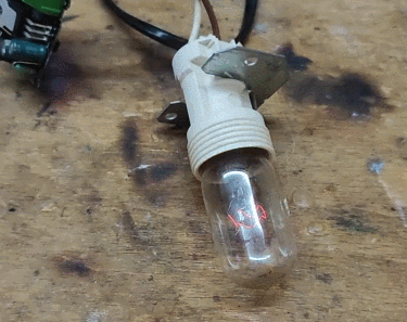

Changing the FS-05R load CB2S communicates with the MCU via the UART port used for programming, so you need to desolder CB2S. You need flux and braid.
I program with my flasher: https://github.com/openshwprojects/BK7231GUIFlashTool Desoldered, cables need to be connected ignoring the descriptive layer, looking at the catalog note : : Whole system: After uploading, we solder the module into place.
Configuration for OBK FS-05R My first experiment was to create a script that sends hard-captured UART packets:
Then I added a wrapper for sending TuyaMCU commands so as not to have to provide the checksum and header in the script, now the last byte is counted automatically:
The syntax of tuyaMcu_sendCmd is very simple. The first argument is the TuyaMCU command number and the second is its payload. The checksum is calculated automatically. Effect:
Here you can also see that the smooth transition effect is handled by the MCU itself, not the WiFi module. Now it`s time to turn this proof of concept demo into something functional . OBK allows you to define channel types and create simple scripts, you can read about it in the documentation: https://github.com/openshwprojects/OpenBK7231T_App/tree/main/docs Based on this, I prepared the following script:

This script creates a dimmer controller on foot that supports both turning it on and off, as well as changing the brightness level. The brightness level is remembered after turning it off and on. It`s all about the scripts. The brightness level is manually split into two bytes and sent in the packet already discussed. This is what it looks like in LittleFS: And on the panel: Thanks to the new Home Assistant Discovery system, a dimmer scripted in this way will be seen automatically by HA, without writing Yaml!

I have the same dimmer. I use your script in autoexec.bat.
But i haven't dimmer effect. When i move slider up the bulb only light up with full brightness. Toogle works... [Read more]
16 Mar 2024 17:11
Please try updating OBK to latest version. You may have an older one, depending on the way you've flashed your dimmer. [Read more]
If it's still not working, then try executing the test autoexec.bat:

Yes. It works with Tuya, but in very small range.
Today i've changed the bulb and... it works perfectly with your script. It is very strange, but it is. Thank your for reverse engeneering!!!
I think... [Read more]
22 Mar 2024 08:59
Of course not all of the bulbs are dimmable nowadays. I would even say that it's safe to assume that bulb is not dimmable unless otherwise specified.

Hi, I also got FS-05R dimmer module, except it had a Zigbee module. I figured I wanted WiFi so I replaced the module with and ESP equivalent of CB2S. This is exactly the same 'motherboard'. However I... [Read more]
Hello, I am currently playing with this dimmer and have a problem. It is also the FS-05R version, although there is no model designation on the housing and there are minimal differences in the position... [Read more]
And when you send in an "artificial" command to change the brightness it always arrives? [Read more]
I understand that I have to go into "Execute Custom Command" and send, for example, something like "tuyaMcu_sendCmd 0x30 0001FF" ? It doesn't, it also only responds after the first time. [Read more]
