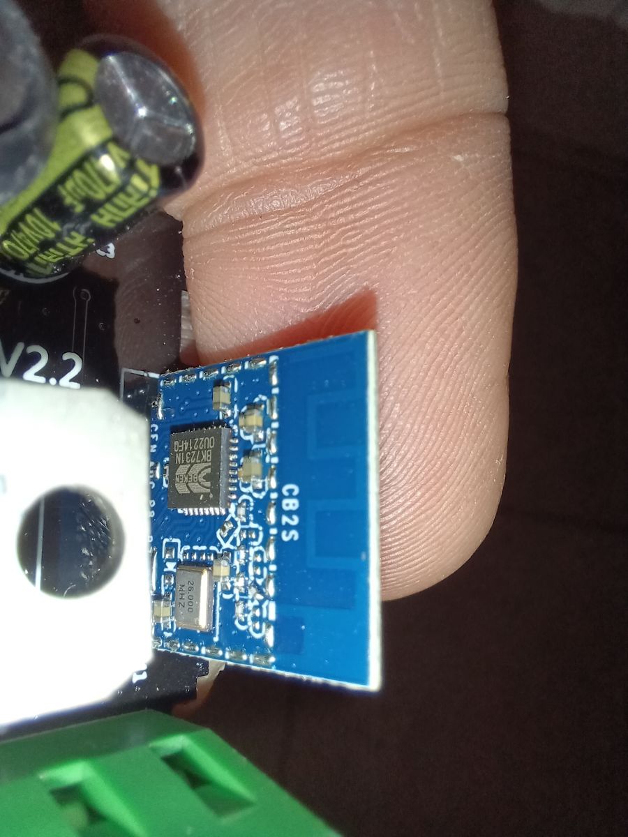

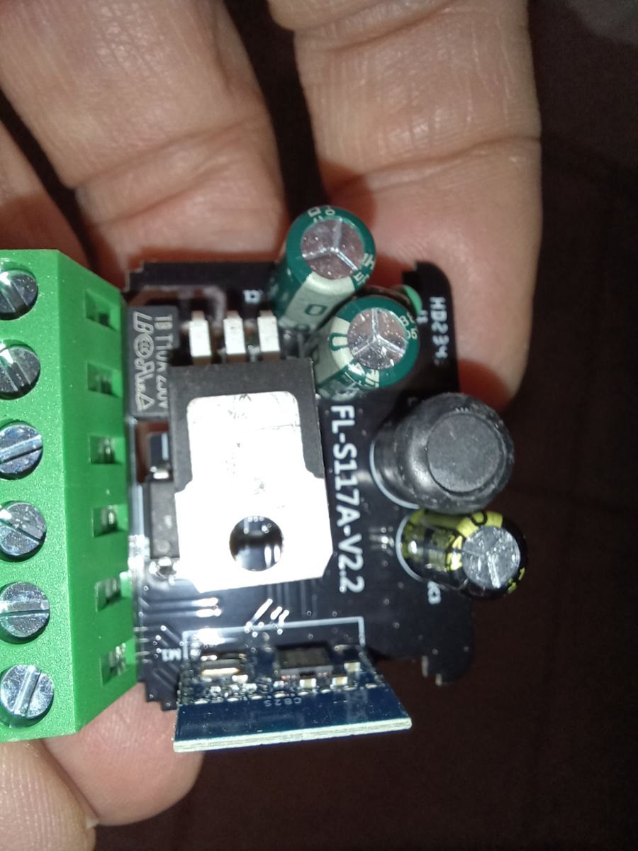

    I follow your guide in order to replace the original firmware for a smart dimmer (no brand, FS-05R) as you can see in the attached image.
    Mini dimmable switch with a technical label on the front.
    I was able to do the job only removing the CB2S module from the main board:
    Smart dimmer module FS-05R held in hand
    Everything seems to be fine except that it doesn't work: the "automatic" configuration doesn't give all the I/O configuration (or I'm using it wrong). Is there someone that can help me?

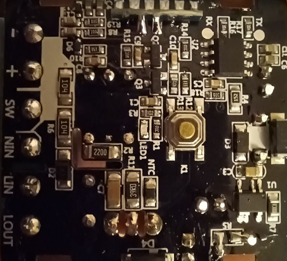

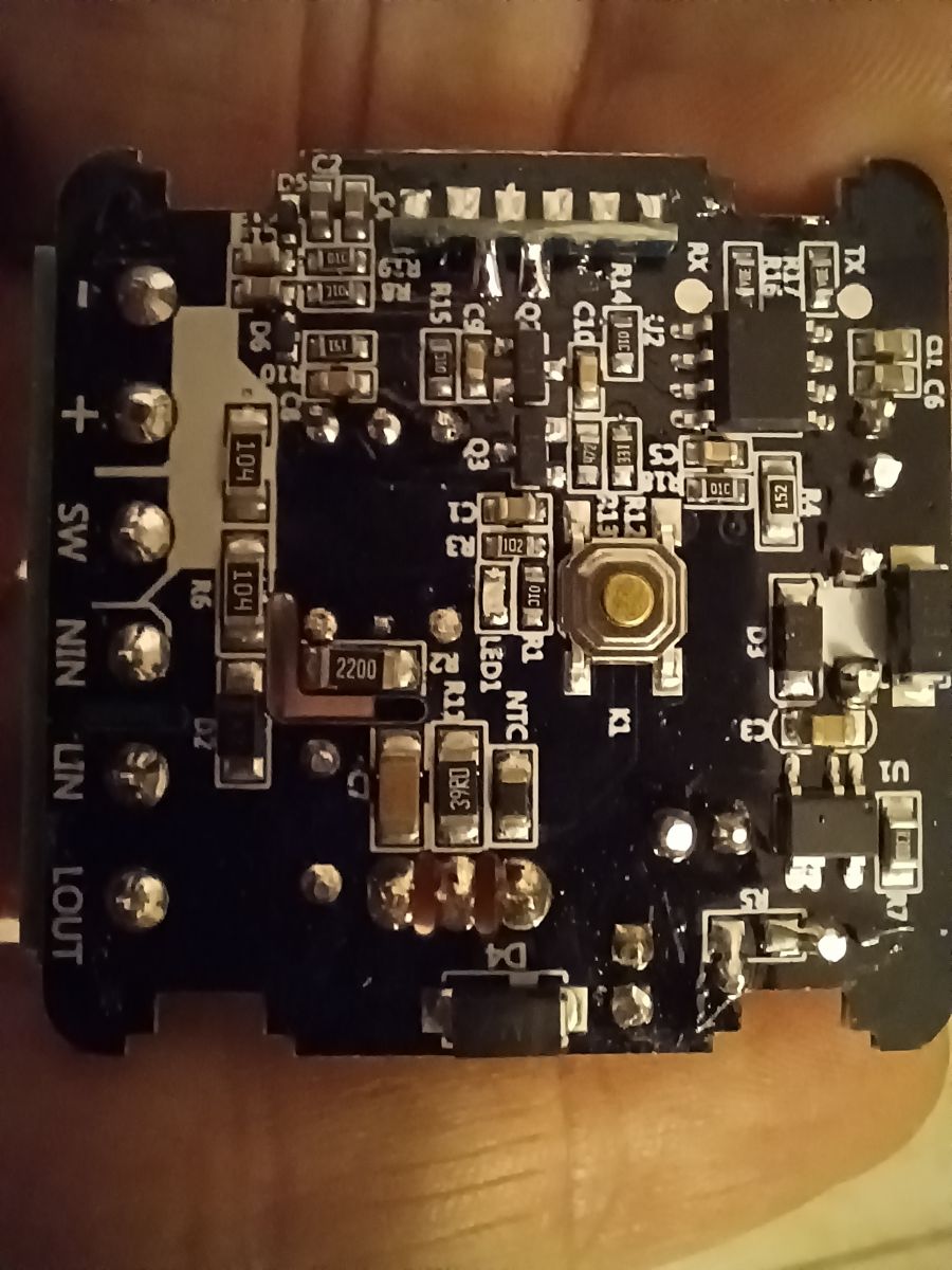

    I haven't found a similar product in the list; this is why I tried to follow your guide and ask for your help.
    These are other pictures of the device in question:
    Printed circuit board with various electronic components. Close-up of an electronic module with components on a blue circuit board and nearby capacitors.
    I do not know exactly how it works, but from the automatic configuration file I can see which are the I/O to be used (led, light_minus, light_plus, on/off button) but I have no idea how to set the dimmer setting. I'll read all the info from the link you gave me.
    Feel free to ask me for other more detailed pictures.

    Close-up of a circuit board with visible integrated circuits, including markings TX, RX, and MCU.
    U1 is a power supply chip, that converts mains to something like 12V or 5V, depending on the device, I don't know.
    U2 looks like the MCU.
    Another strong indication that there is something UART-related going on is the TX and RX pad near U2.
    I think you can check with your multimeter (with the device disconnected from power, of course!) in the continuity test mode that RX1 and TX1 are connected to U2 chip.

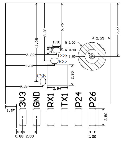

  • Incorrect CB2S silkscreen and 3.3V supply path identified
    #30 20983327
    Posts: 14771
    Rate: 12914

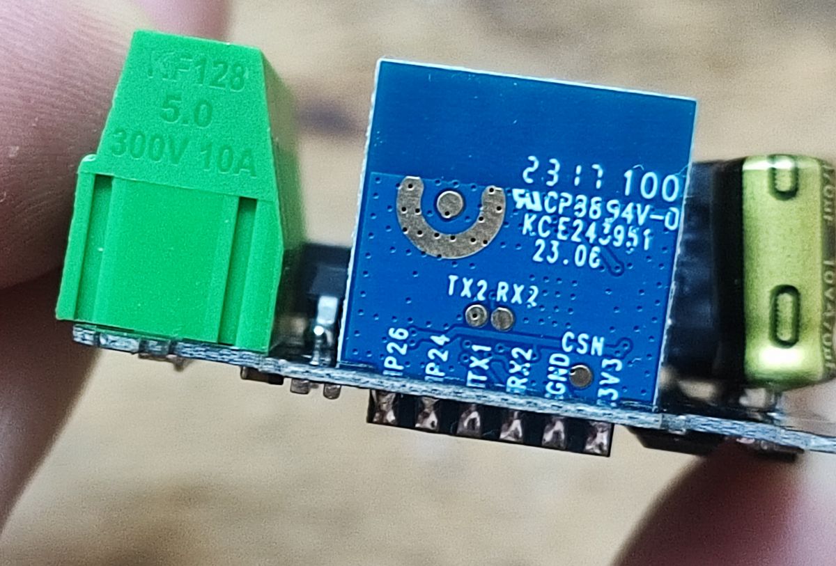

    This device is super confusing.
    1. It has no LDO and no extra step down converter, the main step down converters changes mains to 3.6V and then, after one diode, we already have 3.3V for WiFi module:
    Interior of an electronic circuit with voltage labels
    2. the CB2S has incorrect silkscreen:
    Close-up of an electronic module with a green connector and blue printed circuit board.
    Correct one is:
    Electrical circuit diagram with pin labels and measurements.

    Hmmm 55 AA ?
    Screenshot from a logic analyzer showing UART data.
    Hm"
    TuyaMCU Explorer application interface displaying raw packet data in hex format.
