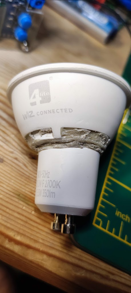

A previous semi-successful attempt saw a 4lite Wiz GU10 reveal an unknown ESP8285 module which I posted about in reply to an old thread here https://discourse.superhouse.tv/t/flashing-an-esp-8285-on-a-wiz-bulb/741/4?u=divadiow
In that attempt I cut the chassis in half so the PCB could be freed for desoldering and flashing with Tasmota. Sadly I cut in slightly the wrong place so had to cut again. The reconstruction works fine but it doesn't look nice and it's a little wonky!
