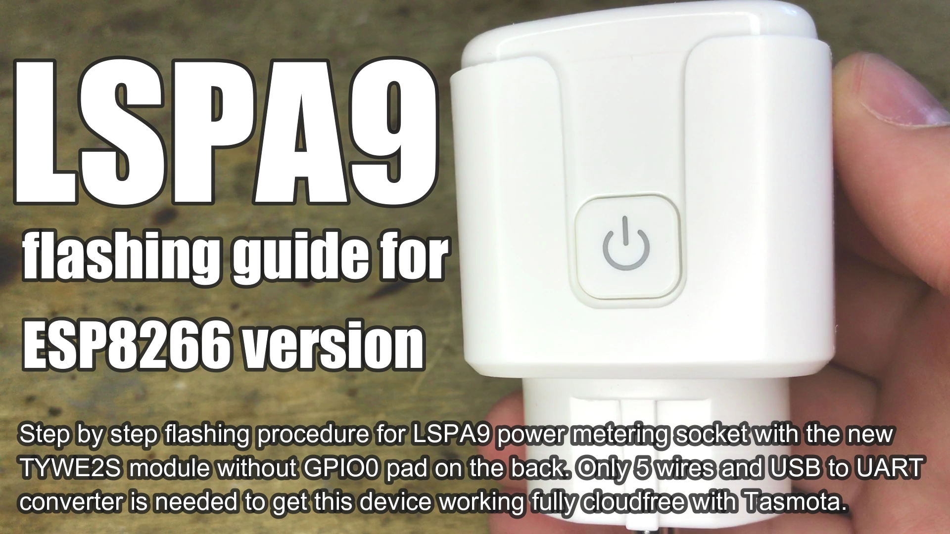

  • Flashes a LSPA9 smart socket that uses an unusual TYWE2S module pinout, installing Tasmota on the device.
  • Uses a soldering guide and esptool.py to program the ESP8266, with an alternate TYWE2S pinout that exposes GPIO0.
  • Flags that this TYWE2S layout does not match Tuya documentation and corrects a video typo that once named TYWE3S.
  • Points to related guides for CB2S, WB2S, and LN882 LSPA9 versions, plus Tasmota Device Groups compatibility with OBK sockets.
The image depicts a flashing guide for the LSPA9 socket with the TYWE2S module.
This is a short programming guide for a LSPA9 socket that is using a strange TYWE2S version with non-stand pinout that does not match Tuya documentation. Video includes soldering guide and flashing method for ESP8266 with esptool.py. We'll flash Tasmota to this socket.
ERRATA: On the video, TYWE3S name is once used. It should be TYWE2S, obviously.
