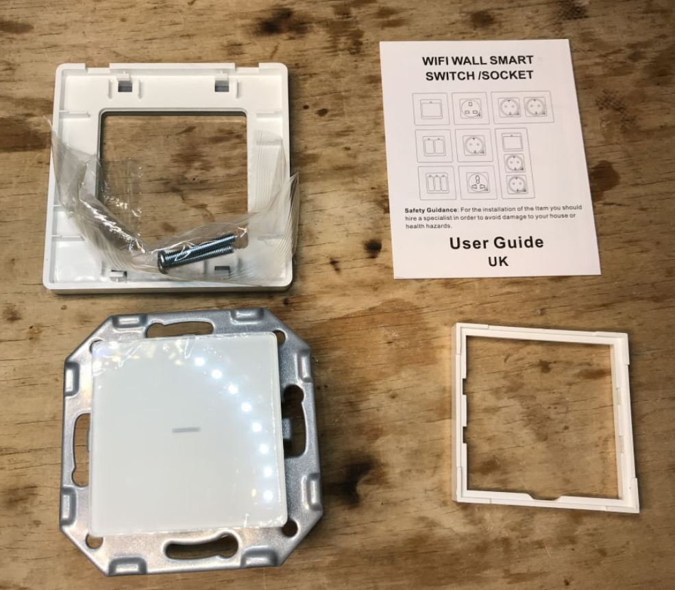

Parts of Avatto N-TS10-W1 WiFi wall switch on a wooden table

White light switch Avatto N-TS10-W1 in disassembled form on a white background, showing internal components. Next to it are three assembled switches on a blue background.

Set contents:
Avatto N-TS10-EU-W1 set with wall switch and manual. Box with WiFi wall switch and user guide WiFi wall switch set with manual and mounting components
The set also includes a second manual, already in English:
User manual for a WiFi smart wall switch English instruction leaflet for setting up the Avatto N-TS10-W1 device. Photo of user manual with Amazon Alexa and Google Home apps.
Mounting screws are present.
