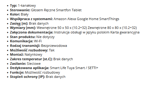

    Specifications, dimensions, etc.:
    Technical specifications: type, color, range, dimensions, communication, features.
    Here, I have a plus for the seller for writing "no data available" within WiFi range, it`s probably better than declaring values that are then not reflected in practice. WiFi is quite capricious and its reliability does not come close to that of a cable.

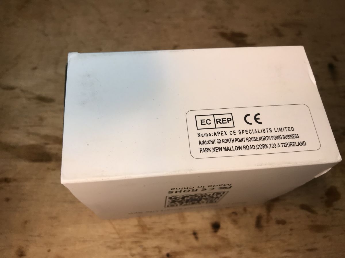

    It seems that the importer tried to print his own print on the carton cover, and the carton is already without the Avatto name, typical:
    Cardboard packaging with a sticker of the Avatto N-TS10-EU-W1 product in white color.
    Full name: N-TS10-EU-W1

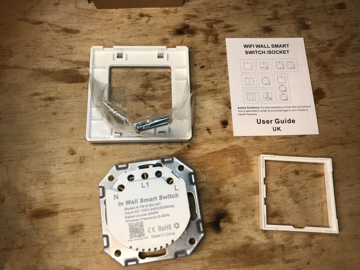

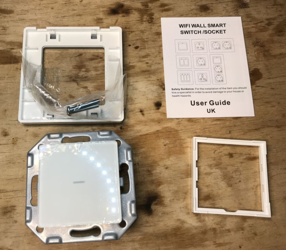

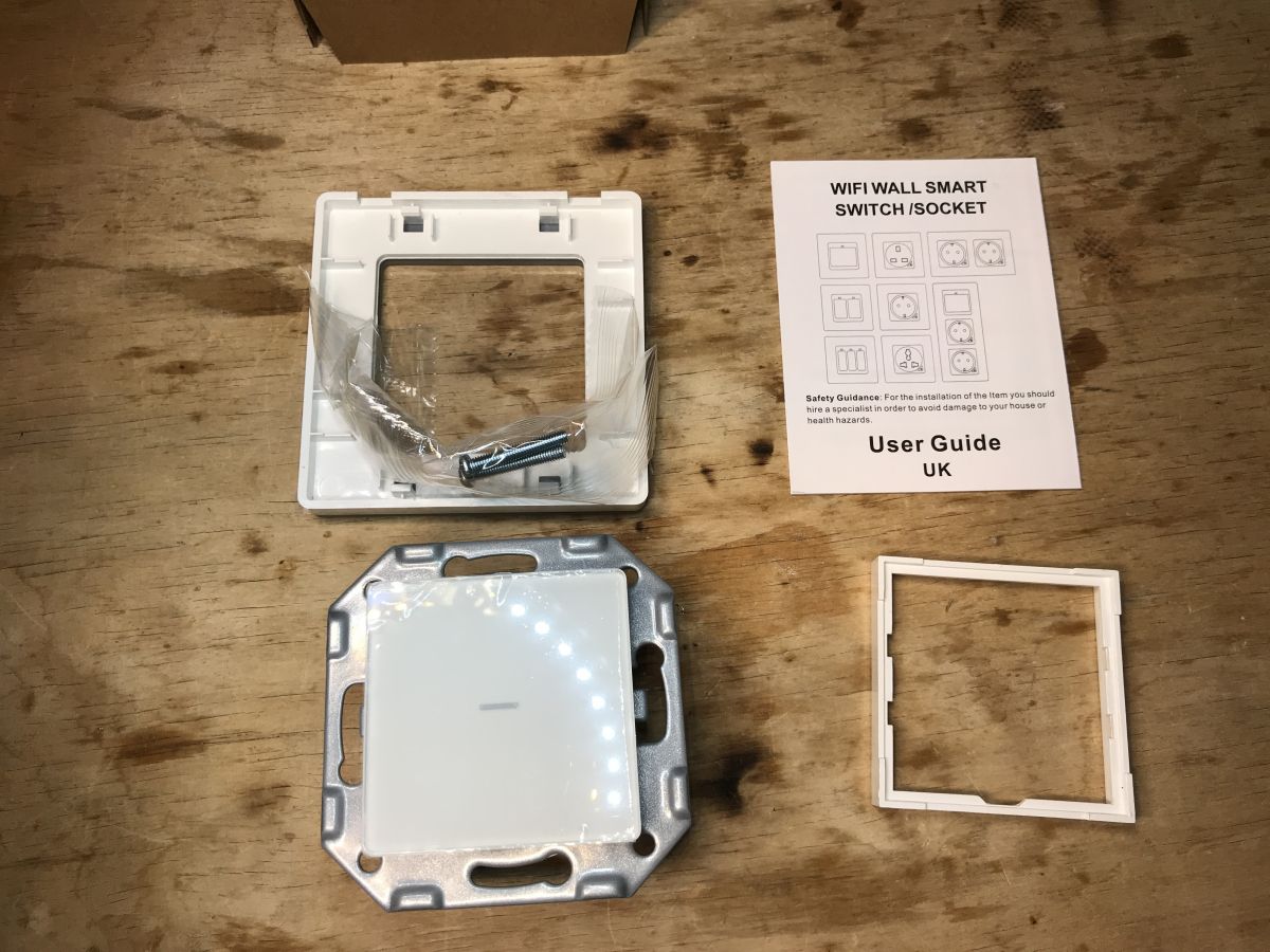

    Set contents:
    Avatto N-TS10-EU-W1 set with wall switch and manual. Box with WiFi wall switch and user guide WiFi wall switch set with manual and mounting components
    The set also includes a second manual, already in English:
    User manual for a WiFi smart wall switch English instruction leaflet for setting up the Avatto N-TS10-W1 device. Photo of user manual with Amazon Alexa and Google Home apps.
    Mounting screws are present.

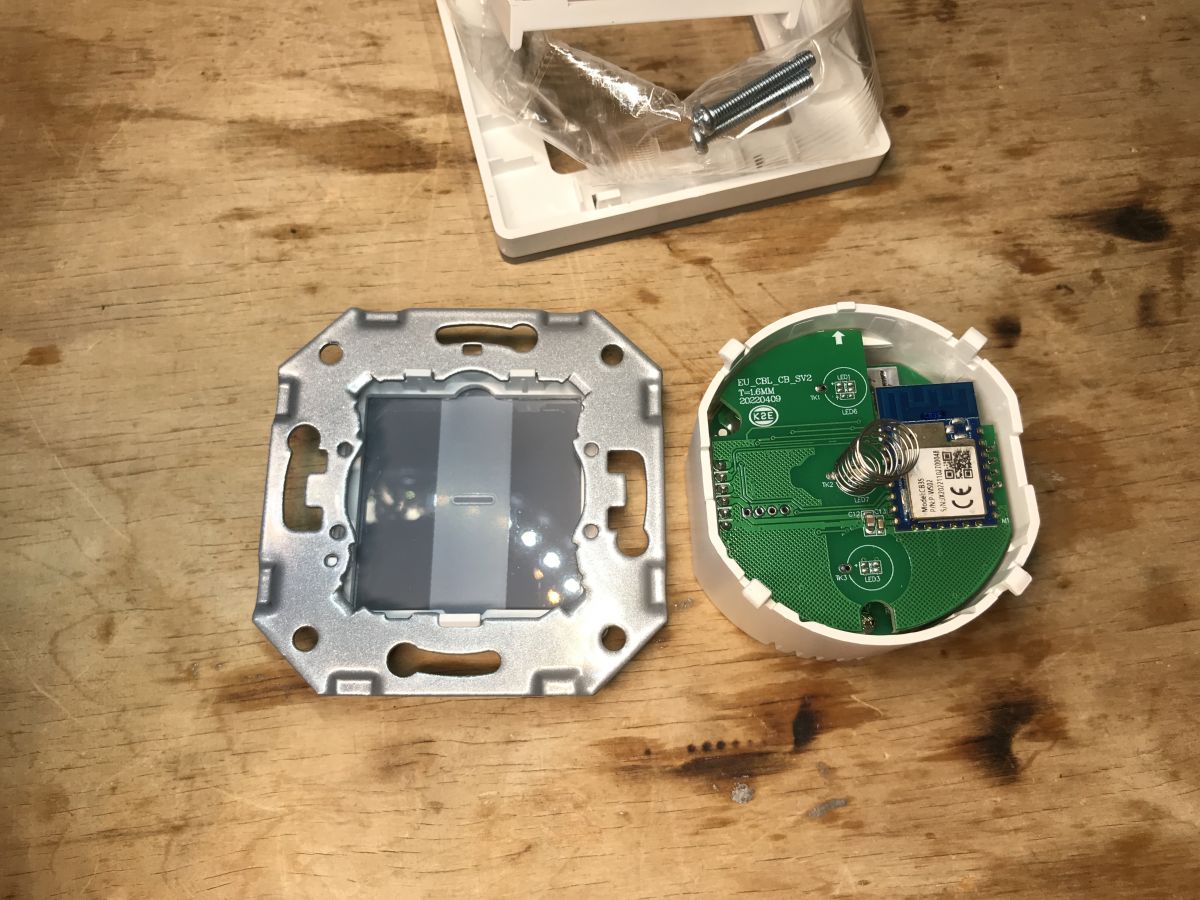

    Interior of Avatto N-TS10-W1
    We release four catches:
    Interior of the Avatto N-TS10-W1 light switch and mounting part.

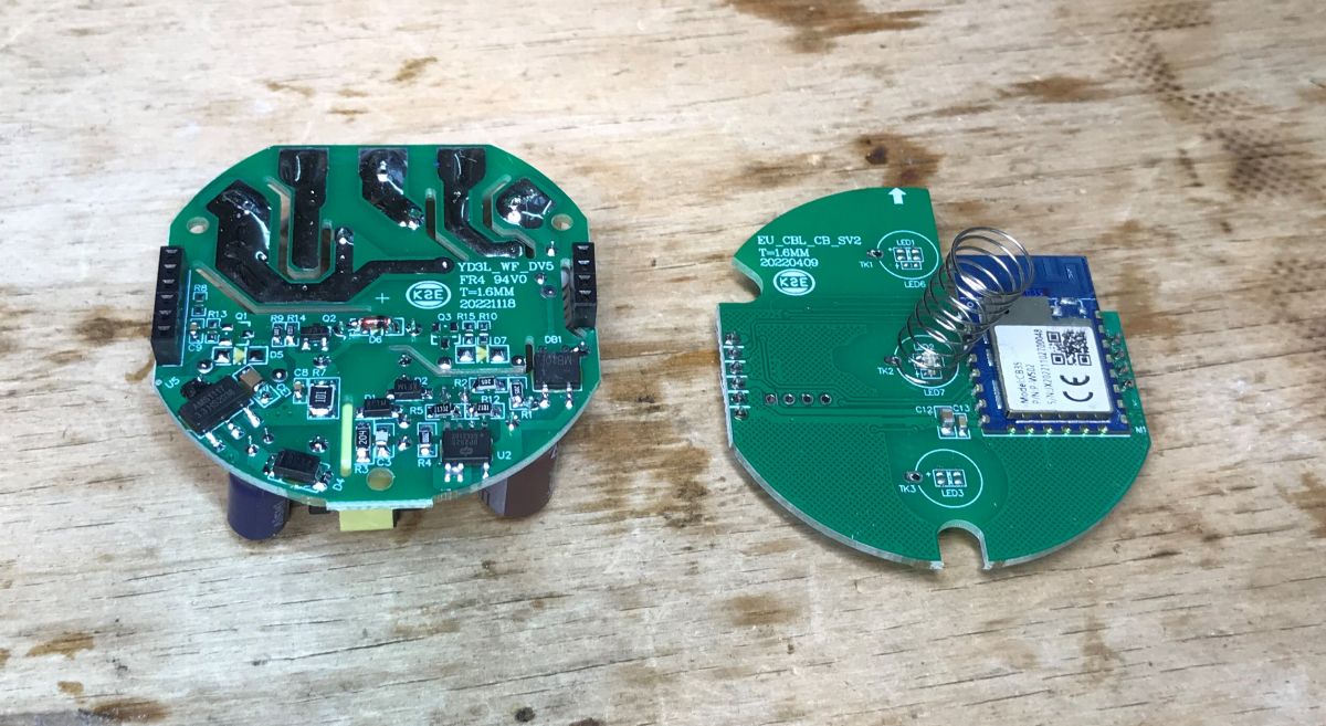

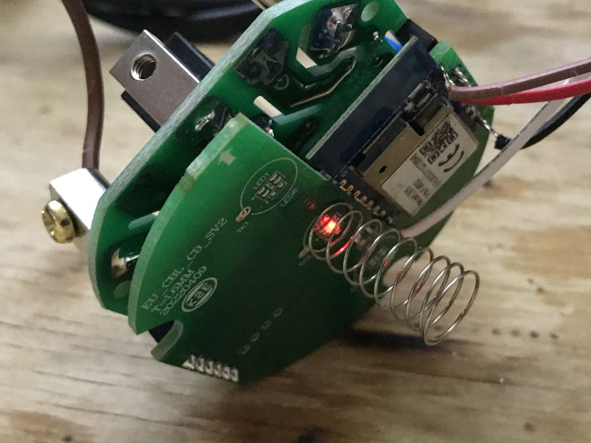

    There is a CB3S module with BK7231 inside, you can load OpenBeken.
    View of the internal PCBs of the Avatto N-TS10-W1 switch

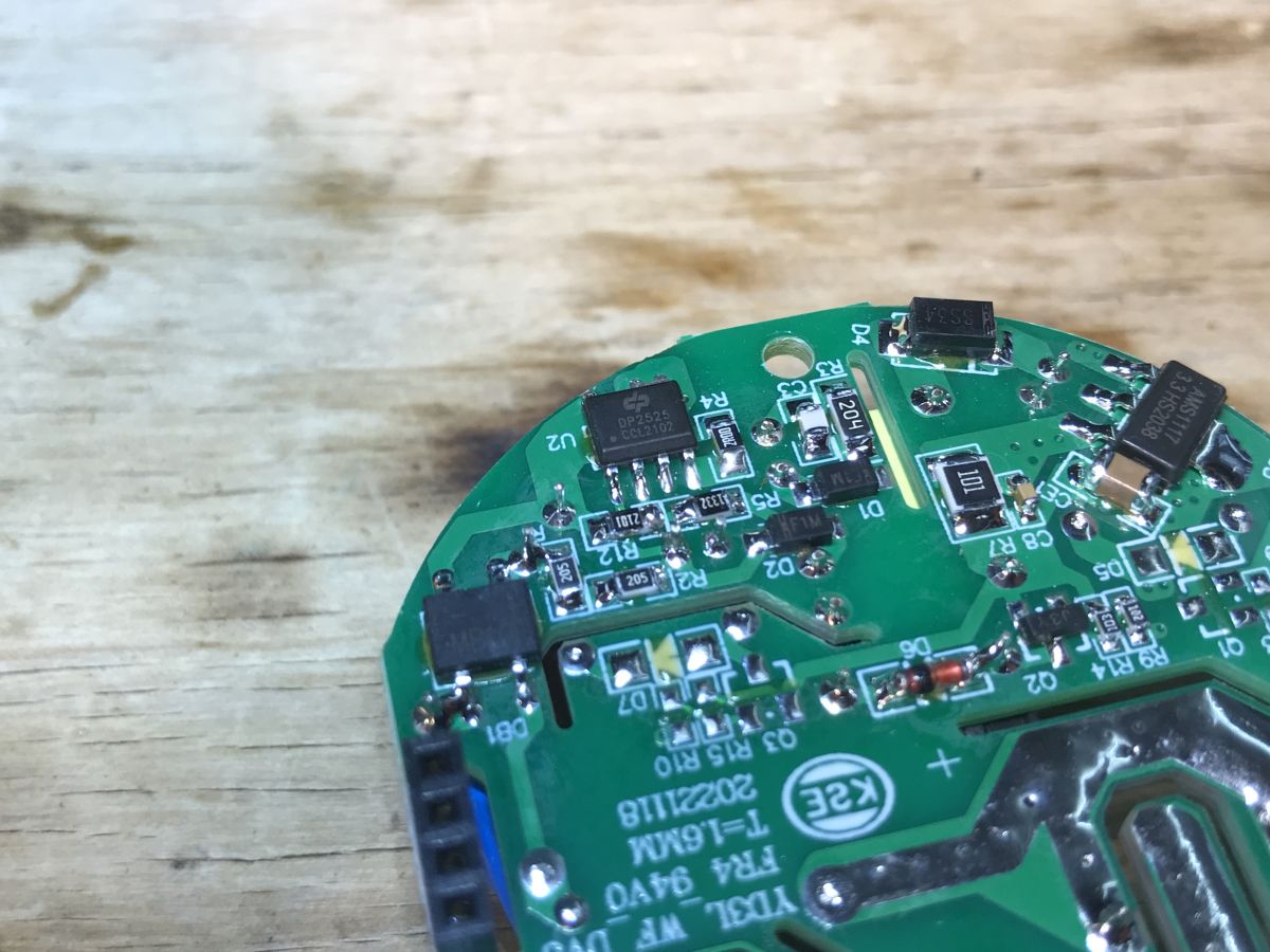

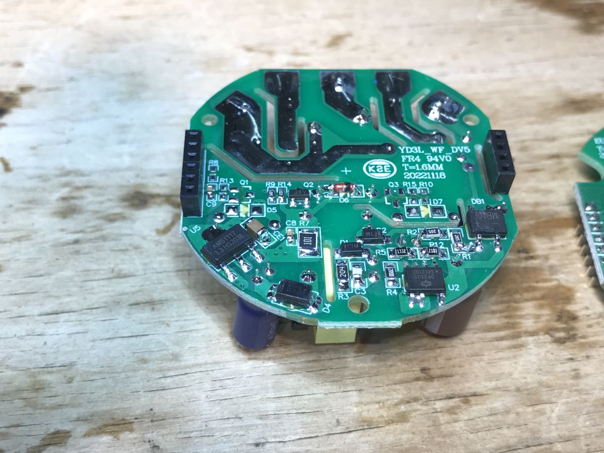

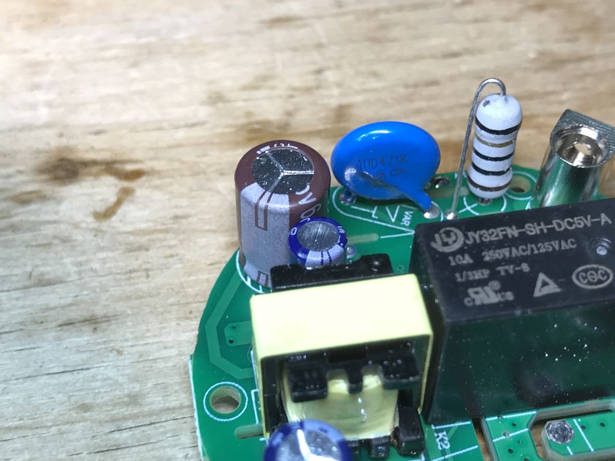

    The board with the power supply is typical, the system powers DP2525, this board also has a 3.3V AMS1117 LDO, because the power supply itself generates 5V for the relay.
    Printed circuit board of the Avatto N-TS10-W1 switch, version YD3L_WF_DV5, with visible electronic components.
    One row of connectors on the side is for mechanical support only, the other provides a connection to the front board.
    Close-up of a circuit board with visible electronic components.

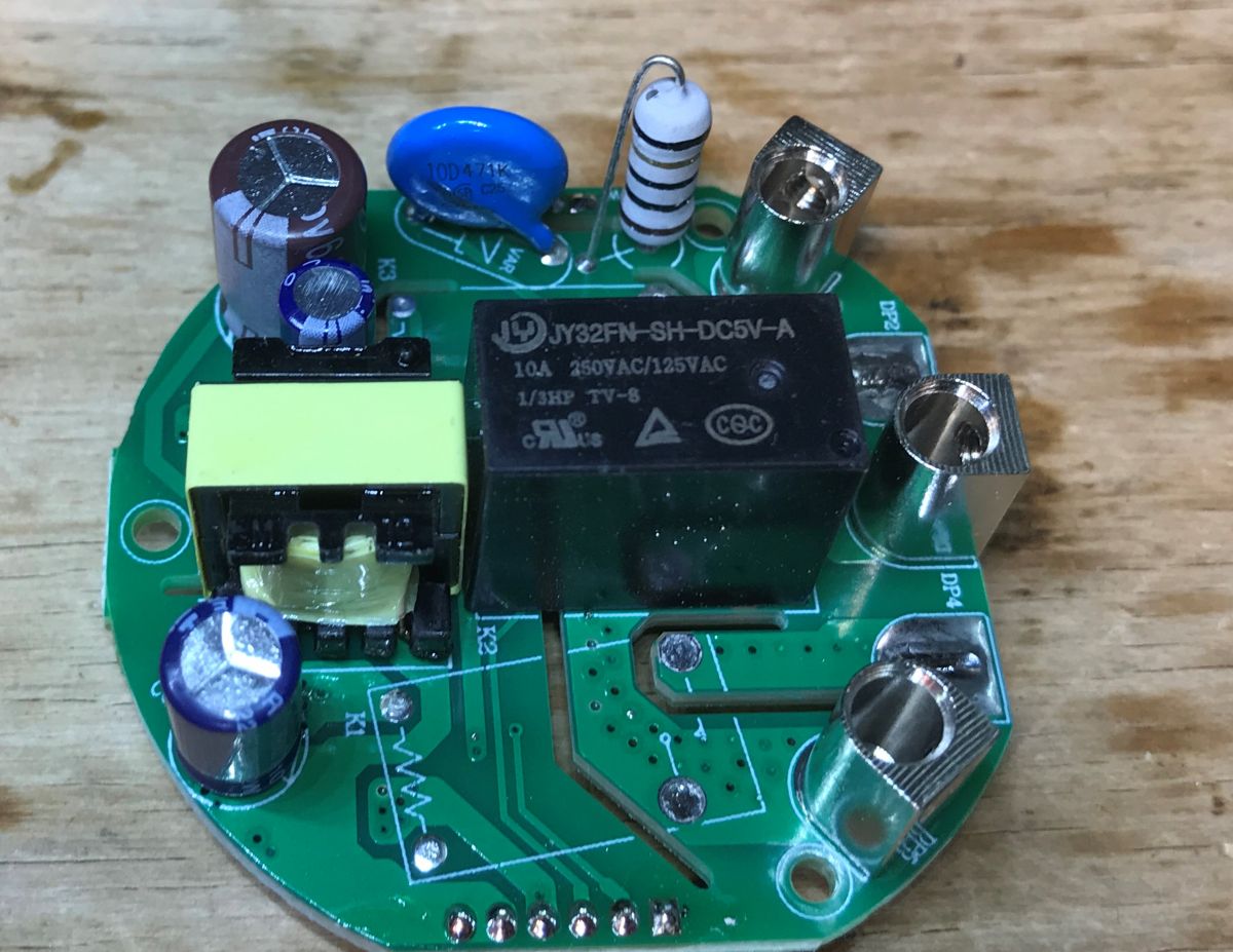

    On the other side you can see a relay for the mentioned 5V and a nice accent is also a varistor, manufacturers do not always provide it, there is a fuse resistor as usual.
    Electronic components on a green printed circuit board. Close-up of a circuit board with electronic components for a light switch.
    I also see room for additional relays.

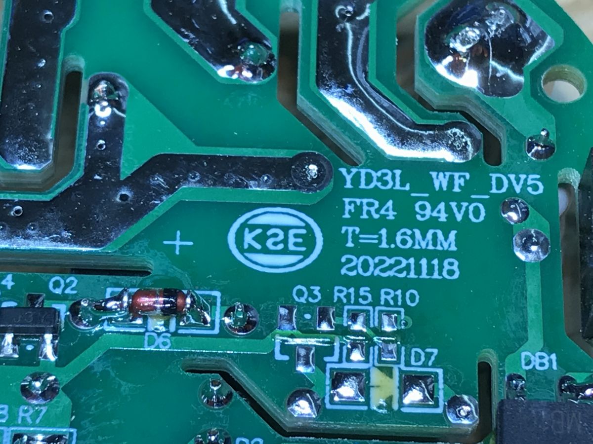

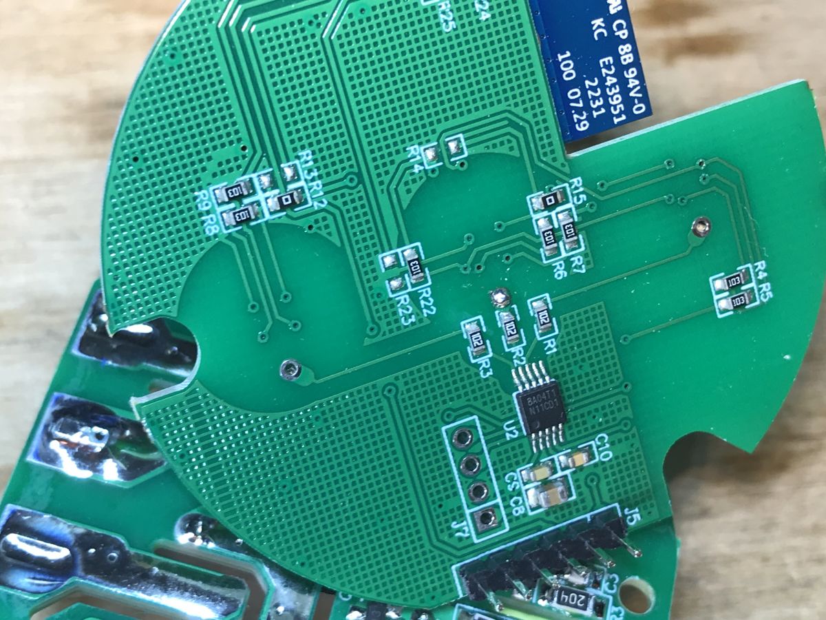

    Another front plate, touch buttons support BA04T1:
    Close-up of the Avatto N-TS10-W1 circuit board with visible electronic components.
    PCB designation YD3L_WF_DV5 20221118:
    Close-up of a circuit board with YD3L_WF_DV5 markings and electronic components.

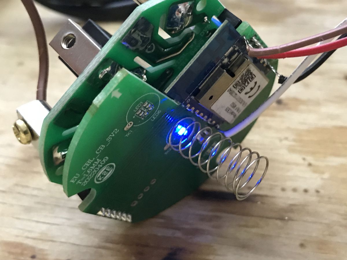

    After connecting the power supply, we see that we have two colors of the LED:
    Close-up of the internal components of a light switch with a visible blue LED. Close-up of the interior of an Avatto N-TS10-W1 switch with visible electronic module.

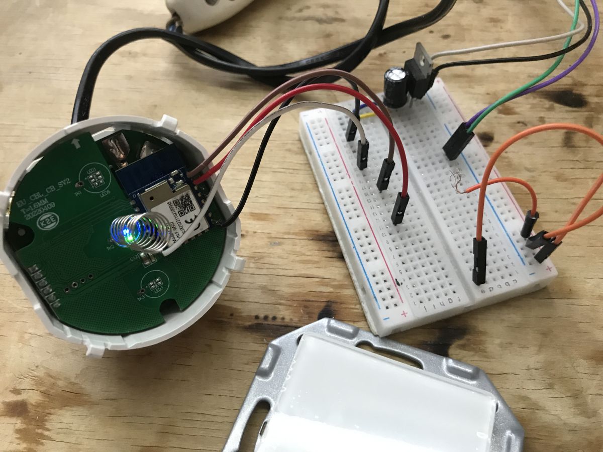

    Avatto N-TS10-W1 firmware change
    Now let`s try to load OpenBeken to free this switch from the cloud.
    For previous products in this series, the process was quite simple:
    [CB3S/BK7231N] AVATTO TS02-EU-W3 light switch (triple version)

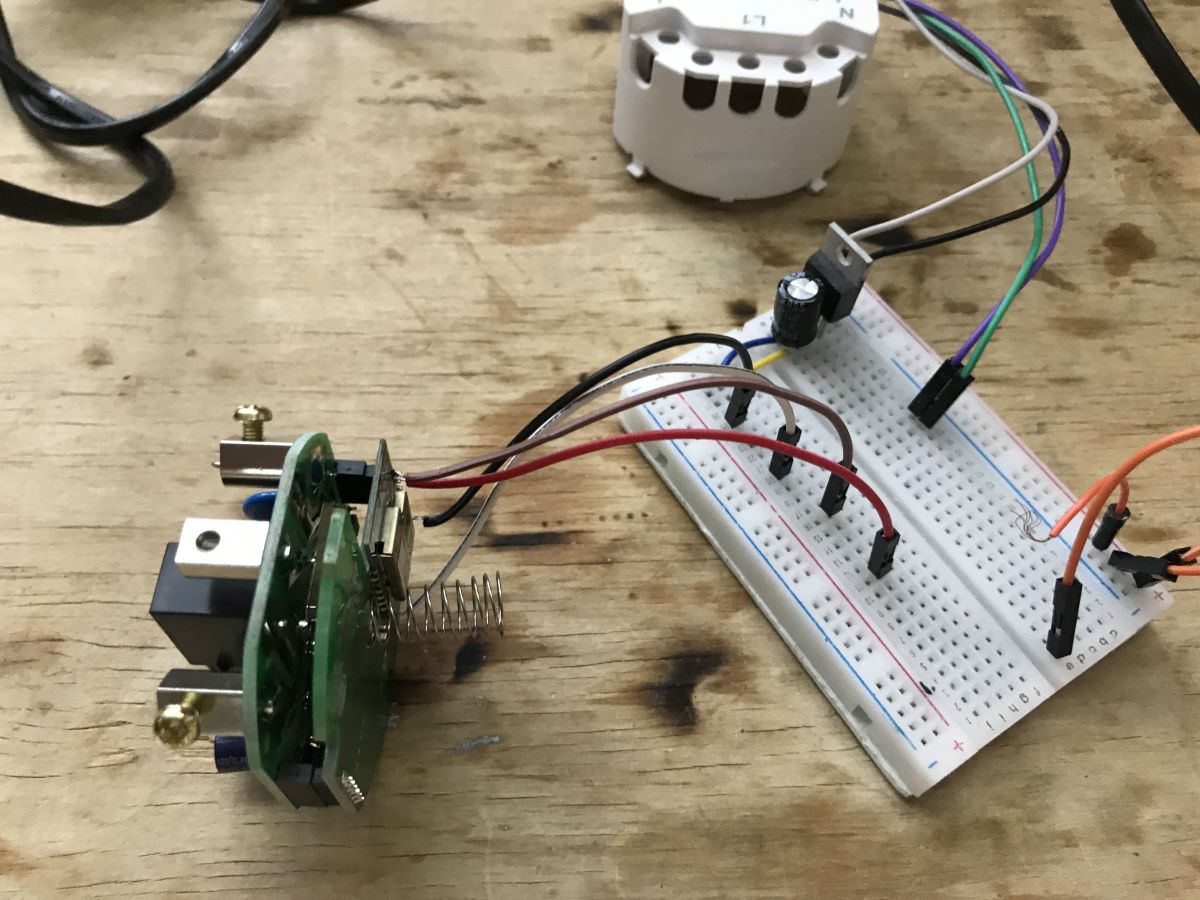

    I also wanted to repeat it here, according to the flasher`s instructions:
    Interior of a light switch with electronic components connected to a breadboard. CB3S module from Avatto N-TS10-W1 light switch connected to a breadboard.
    Just see the CB3S pins on the Tuya website and connect the USB to UART converter to TX1/RX1 and connect the 3.3V power supply:
    https://developer.tuya.com/en/docs/iot/cb3s?id=Kai94mec0s076

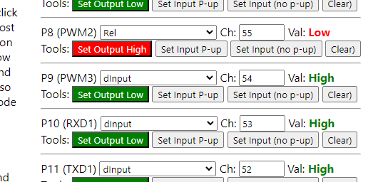

    It was possible to upload the batch, but this time it was not possible to read the GPIO configuration/template from Tuya.
    In such a situation, use the GPIO Doctor tool located in the Web App:
    Interface of the GPIO Doctor tool showing pin configuration.
    We examine each pin in turn:
    Screenshot fragment of a diagnostic tool with GPIO settings for a light switch.
    However, the result disappointed me a bit. We only have 3 GPIOs to control here:
    - P8 - has a relay and both LEDs, blue and red, depending on whether the state is high or low
    - P26 - green led, e.g. for WiFi
    - P10 - button (touch button)
