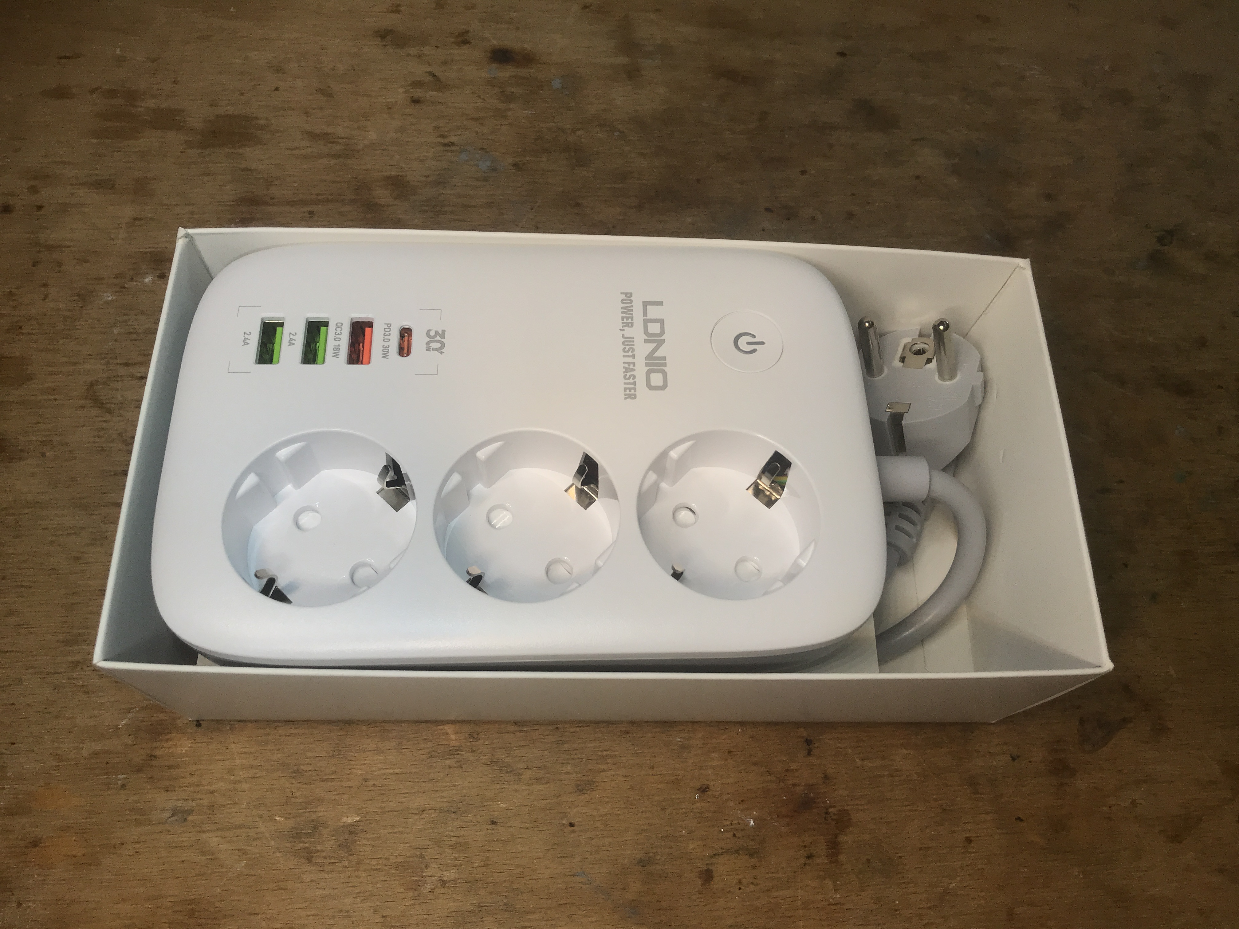

LDNIO SEW3452 power strip with three sockets and four USB ports in a box. Today I will present the interior and firmware change of a strip/extender offering three power sockets and four USB sockets, in addition with QC support. I will upload open source software onto the product OBK so that it works 100% locally, in a way that is secure and respects the user's privacy, without the cloud.

Interior of the LDNIO SEW3452 USB QC This will be a bit tricky. You need a special screwdriver with a triangular tip.
Bottom of a power strip with technical data and QR codes Screwdriver opening power strip case with a set of bits.
The interior is really rich. I can even see some coil and filters, although there is an empty space for a varistor?
Interior of a disassembled LDNIO SEW3452 power strip showing electronics and sockets. Interior of a power strip with electronic components. Interior of the QC USB LDNIO SEW3452 power strip showing electronic components. There is also an NTC thermistor, probably limits the inrush current.
Interior of LDNIO SEW3452 power strip with WiFi module CB2S.
The WiFi module is a CB2S (BK7231N). You can see the step down converter next to it (element U4 with large coil L2). The relay is for 5V, 1ASTE-DC5V.
