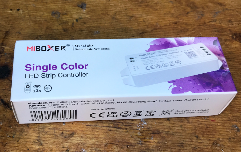

The FUT036 LED strip controller first appeared on our forum when a user asked about the possibility of changing the firmware of the CB3S module from inside, but did you know that the same controllers are available in a version based only on RF, without WiFi? Here is exactly such a controller I will present. The version discussed here will be single-colour, although versions are also available for different combinations of LED strips (FUT037, FUT038, etc). For the version shown here we paid only PLN40, not a lot, but this is the version without WiFi, for the versions with WiFi we pay about twice as much.

Here I have a slightly different version:
Packaging of MiBoxer FUT036 Single Color LED strip controller. LED controller FUT036 packaging with technical specifications
Simply FUT036, according to the markings there is RF 2.4GHz here, but no WiFi.
