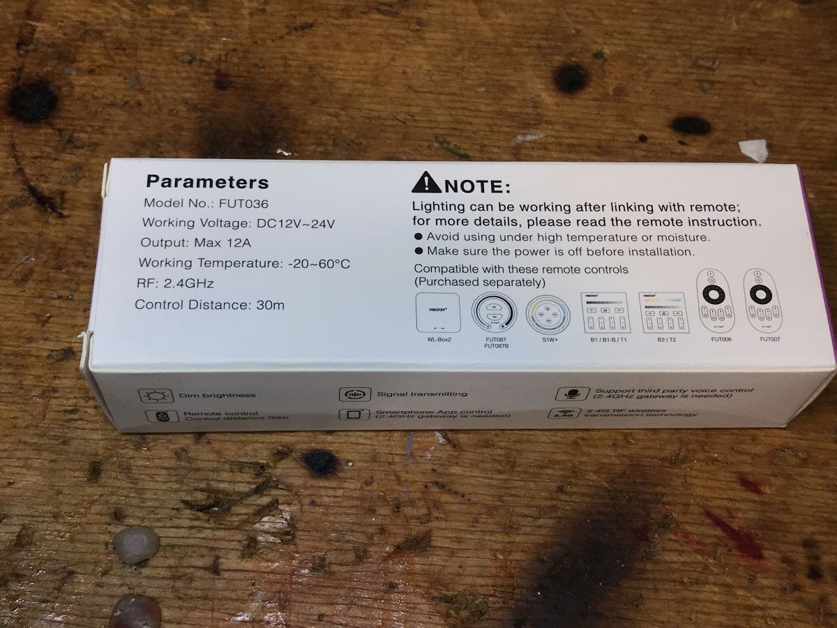

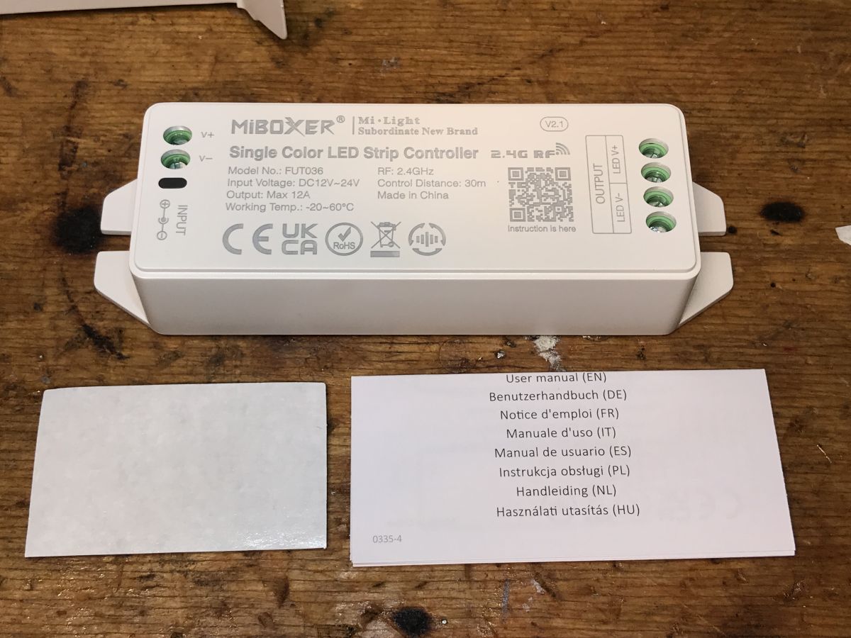

    Here I have a slightly different version:
    Packaging of MiBoxer FUT036 Single Color LED strip controller. LED controller FUT036 packaging with technical specifications
    Simply FUT036, according to the markings there is RF 2.4GHz here, but no WiFi.
    Contents:
    FUT036 LED Controller and user manual.

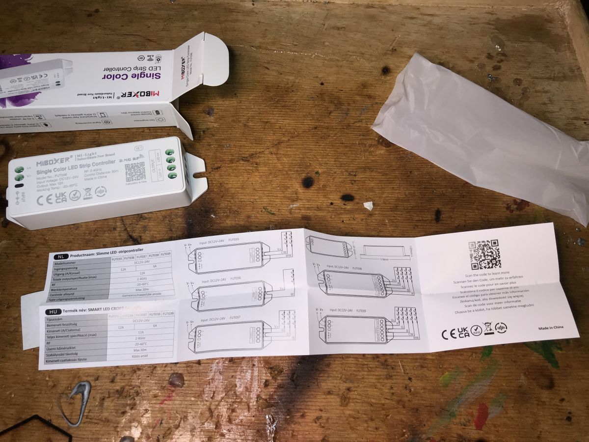

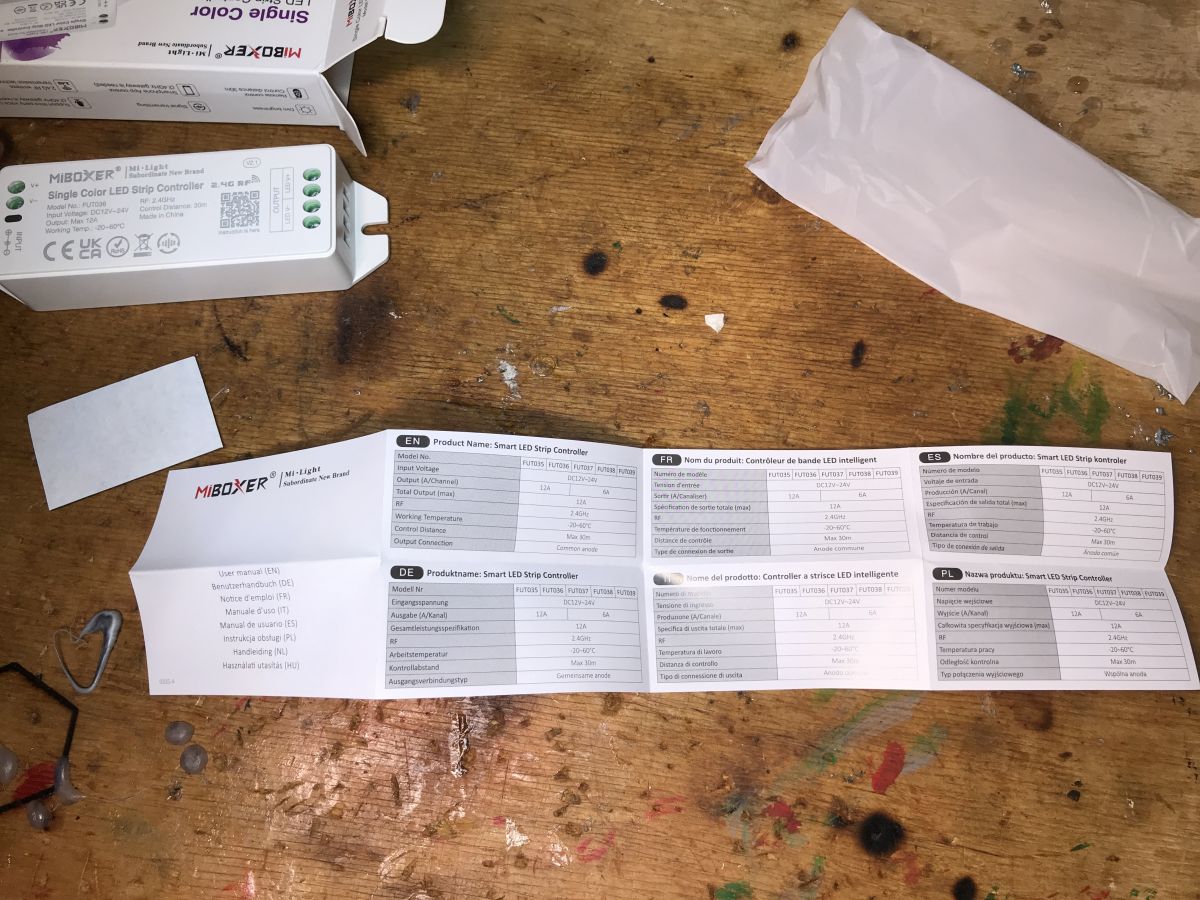

    Instructions from inside, description of the whole family, there are controllers for single-colour strips, for CW strips (shades of white), RGB, etc....:
    FUT036 LED controller on a workbench with a manual beside it. FUT036 LED strip controller with instructions on a wooden table.

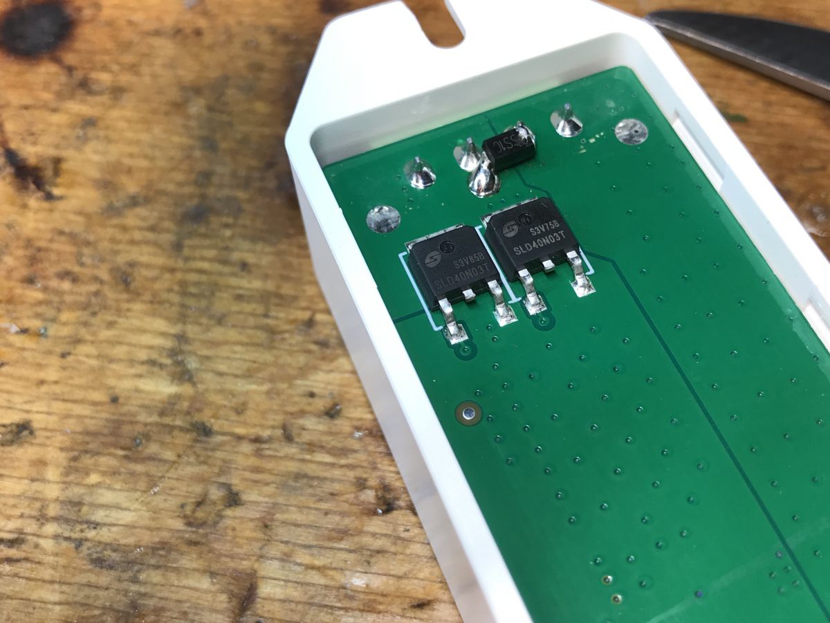

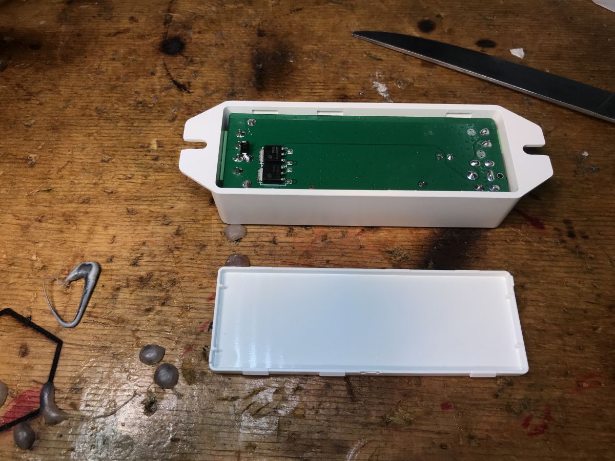

    I guess there is nothing to wait for and you can look inside the controller. Just lift the cover:
    FUT036 LED strip controller with open casing showing the interior

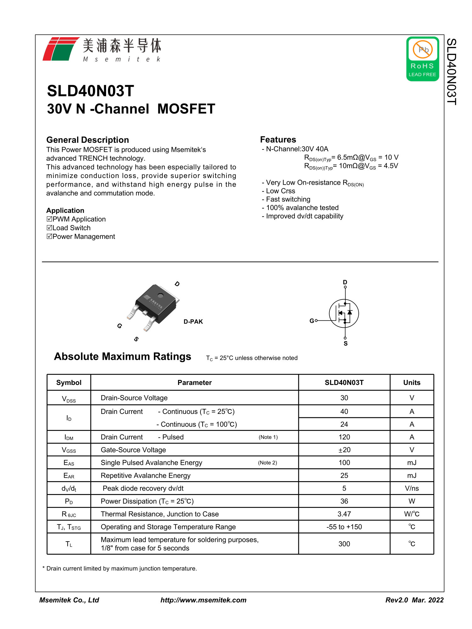

    In this version we have two transistors - SLD40N03T. There is no heatsink, the copper spouted PCB itself is in its role.
    Interior of the LED controller FUT036 with two SLD40N03T transistors on the PCB.
    Parameters of the SLD40N03T, this is a MOSFET for 40V 30A with quite low resistance in the conducting state:
    Specifications of the SLD40N03T transistor on a datasheet. Let's remove the whole PCB:

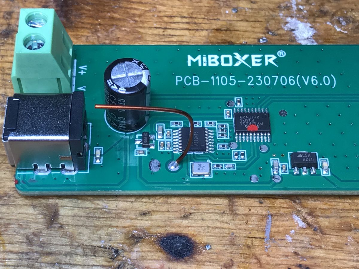

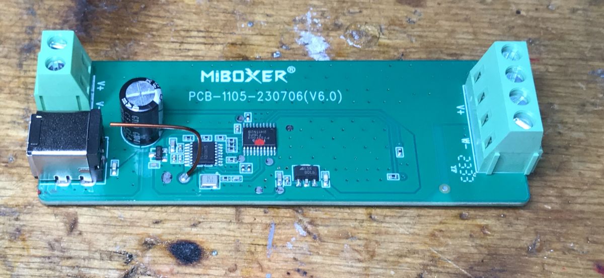

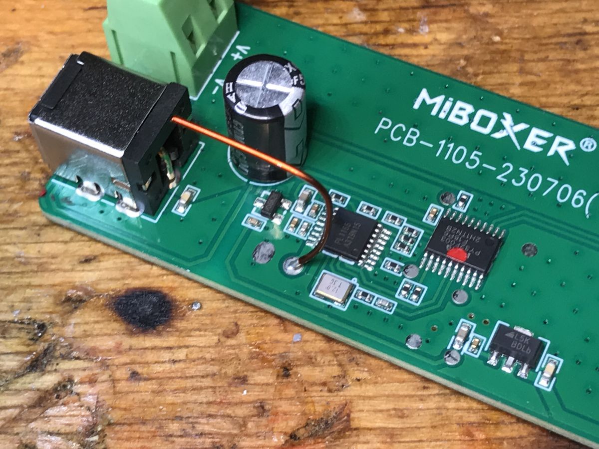

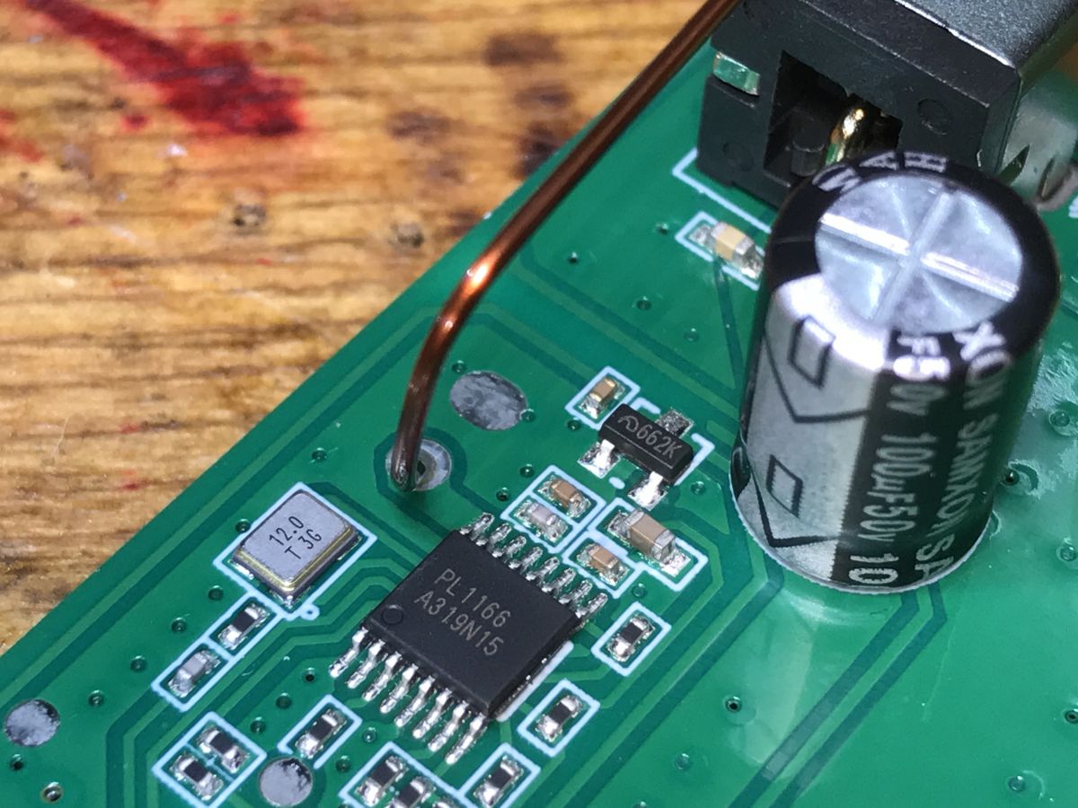

    Miboxer LED strip controller PCB without WiFi
    Close-up of the interior of a MiBoxer LED controller without WiFi showcasing electronics.
    Close-up of the LED controller PCB Miboxer FUT036 with clearly visible electronic components. Close-up of the LED controller PCB showing integrated circuits. Close-up of the FUT036 LED controller PCB with electronic components. Close-up of the FUT036 LED controller PCB with visible electronic components.

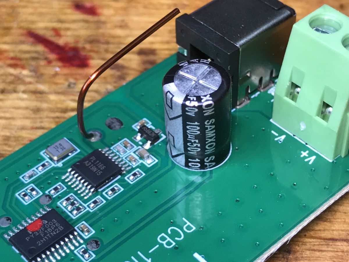

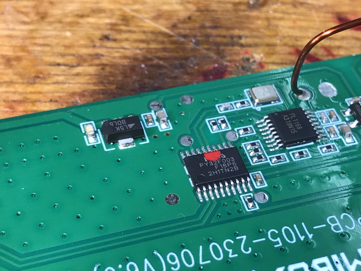

    Obviously we have MCU PY32F003 F18P6 here, and separately there is a radio chip - A319N15.
    PY32F003 is a 32-bit ARM® Cortex®-M0+ with 20KB of flash memory and 3KB of SRAM, clocked to 24MHz. It has integrated peripherals such as I2C, SPI, USART, one 12-bit ADC and several timers. It operates on a voltage of 1.7~5.5V.

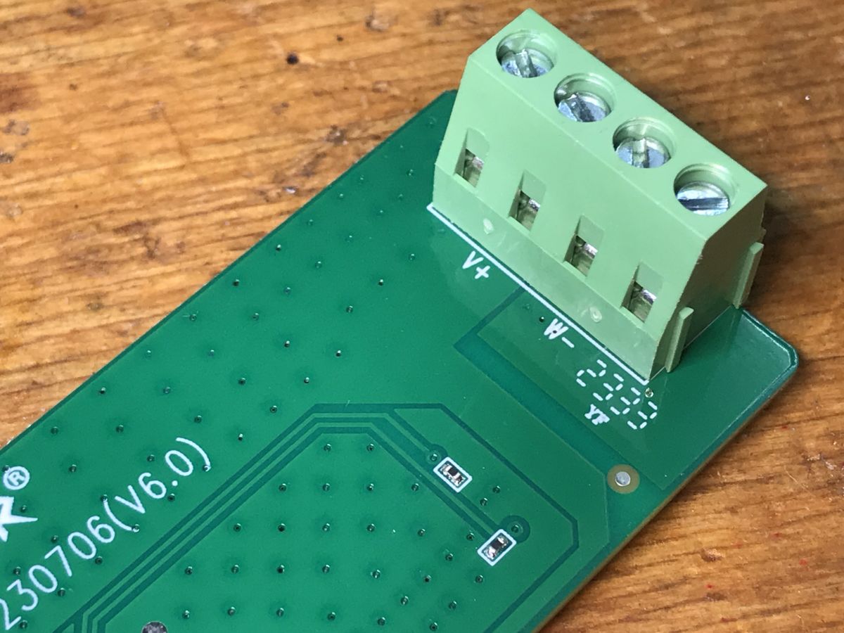

    There is quite a lot of free space on the PCB:
    Close-up of PCB with green screw terminal connector.

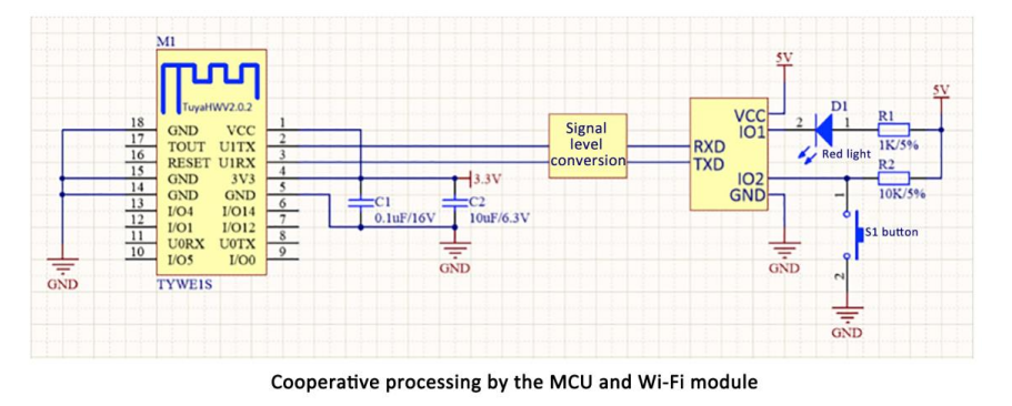

    Comparison with the WiFi version
    Pictures of the WiFi version are available at least in these topics:
    Non-iPhone LED strip controller Miboxer FUT037W+ with TuyaMCU - Communication Protocol, OpenBeken Miboxer FUT036w and CB3s Issues: Flashing Firmware, WiFi Connectivity, and Button Control The first thing that strikes me is that the WiFi version is somewhat of an "add-on" to what is without WiFi, i.e. The WiFi module is only responsible for communication, its PWMs are not used to control the LEDs, instead the chip uses the TuyaMCU protocol:

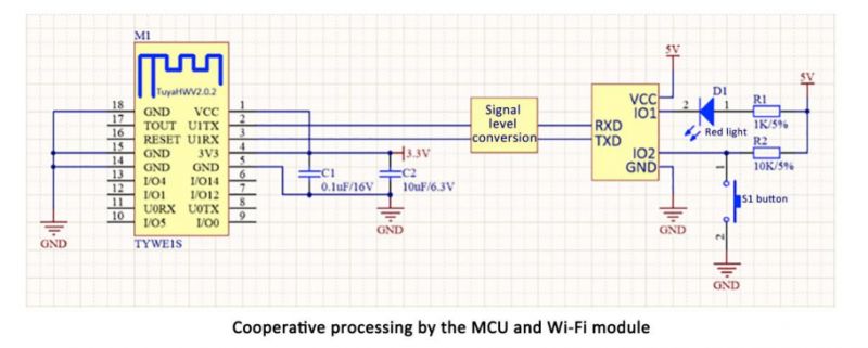

    Wiring diagram of the LED controller with a WiFi module.
    TuyaMCU protocol - communication between microcontroller and WiFi module That is, the WiFi version has as many as three separate chips - RF receiver, main MCU and WiFi module.
    When it comes to the main MCU, in the FUT037W+ discussed by me there was the Nuvoton MCU, and here it is Puya, but both of them have the same software (FUT037W+ only has it enriched with TuyaMCU communication).

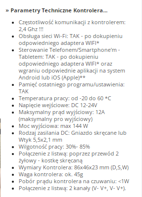

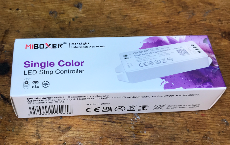

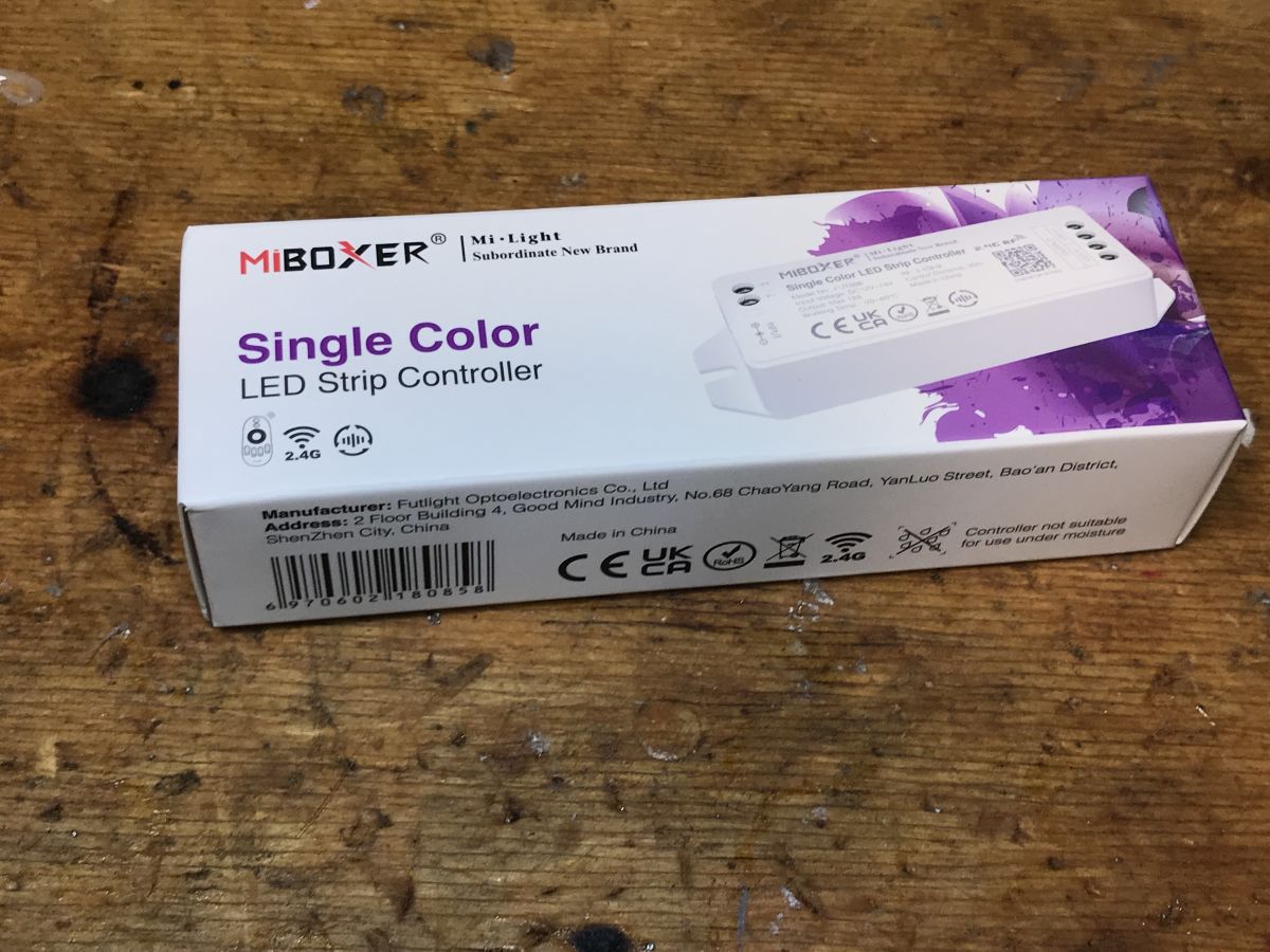

    Note when ordering! Finally, I still wanted to point out a minor not-so-positive practice that I see in shops. Some online shops advertise the version with only RF as "WiFi with a star" (after buying an adapter), quote:
    Controller MONO "Dimmer" 144W RF 2,4 GHz WiFi* Reputable company MI-Light FUT036
    - For single-colour strips - MONO, possibility to dim, brighten, switch on, switch off LED strips etc...
    - 2.4GHz radio communication with Remotes FUT091, FUT093, FUT006, FUT007, FUT092, and Panels B1/T1, B2/T2, B4,T4
    - Controllable via Phone (smartphone) or tablet via WiFi adapter Milight iBox
    I don't like it very much, because there is a difference with the "WiFi with a star requiring an adapter" version and the "RF + WiFi (Tuya)" version, and if one under-reads the description one might be a bit surprised.
    Technical specifications of the LED controller FUT036.
    Their "WiFi adapter" itself will be tested in a separate topic.
