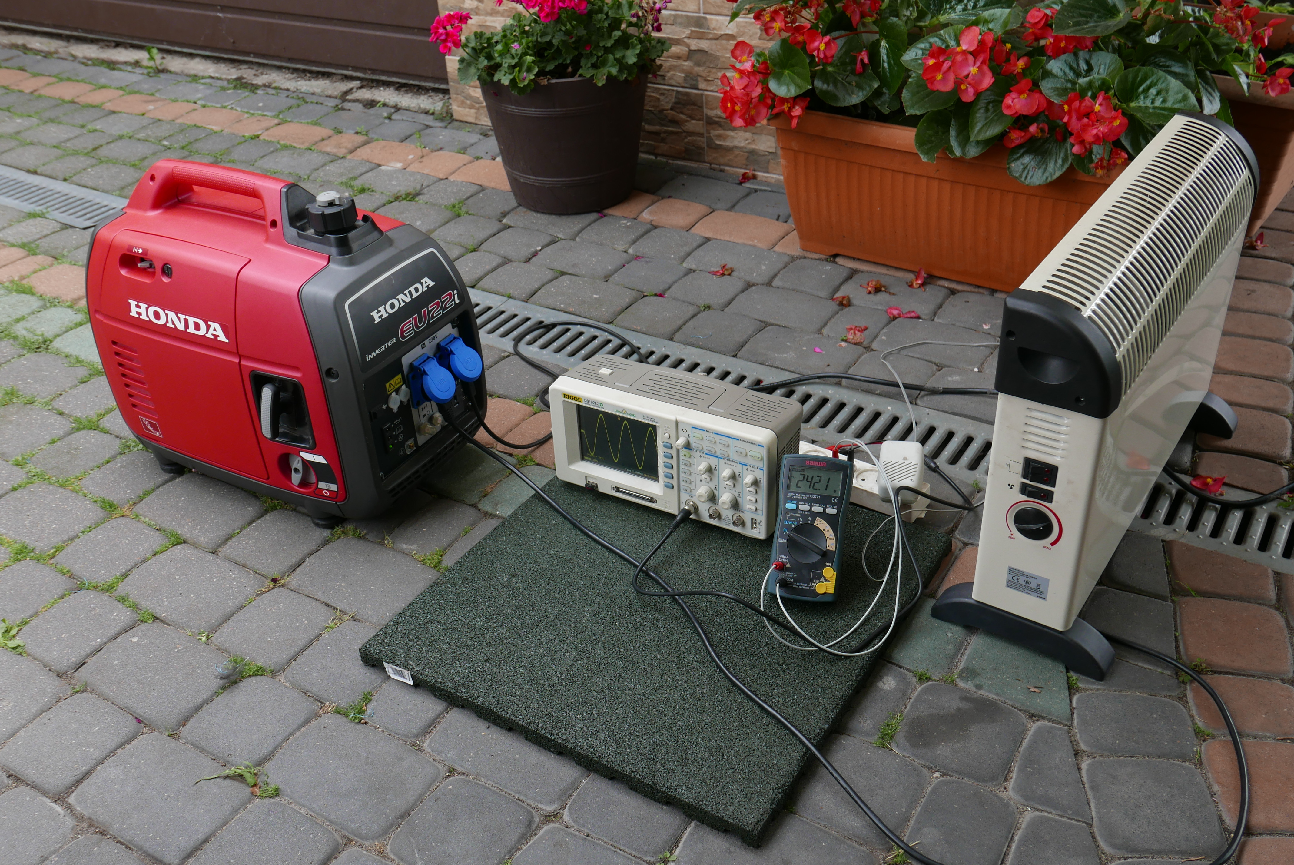

Hello, something other than microcontrollers this time. I decided to test two 1800W 'suitcase' generators from both ends of the price range.
A Honda at around PLN6000 and an AIVOLT at PLN1099. Honda purchased in early 2020. AIVOLT this month.
Testing the Honda EU22i generator in a garden setting. AIVOLT SC2300i-0 generator, oscilloscope, and heater on paving stones.

<spanclass="notranslate"> LOAD TESTS: .
Load: 700W / 1200W / 1900W heater.
Fuel: E10, 95 octane
Oil: 10W30
Due to the lack of a 100x probe, I connected the oscilloscope via a 100:1 transformer (I unwound some coils).
