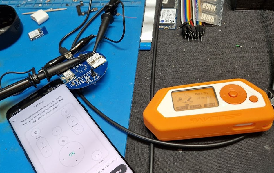

Let us perhaps leave these repositories of codes captured by other users and try to catch some signal ourselves. We just happened to have a "Smart IR Remote" from Tuya, a WiFi-controlled gadget capable of sending and receiving various IR signals. As a test, we decided to send something from it to the Flipper:
Laboratory with electronic devices, an oscilloscope, and a Flipper Zero on the table. .
Flipper Zero on a desk with electronic devices and a smartphone. .
After saving the received signal on Flipper, we received such a file:
type: raw
frequency: 38000
duty_cycle: 0.330000
data: 3190 1291 951 502 902 1292 903 546 901 640 902 545 903 548 900 545 902 641 901 546 902 546 901 546 902 639 903 1294 901 65009 2376 549 903 1293 1007 1283 901 640 902 1294 901 546 902 546 902 545 902 640 902 546 901 639 903 546 901 639 903 546 902 546 901 1293 902
It is now time to see what the same signal looks like on an oscilloscope. The trigger function was used to capture the data, i.e. triggering the capture with the edge of the signal.

The first is the frequency used (usually around 30-60kHz) and the second is the fill cycle.
What's left is the raw format data. These are not bytes, but times in microseconds:
Simply plot their values on the oscillogram and we can already see that everything agrees:
Oscilloscope screenshot showing infrared signal. .
These numbers are the times of the high and low states sequentially, so that the raw format is able to reflect the different signals, regardless of the coding used further down in them.
