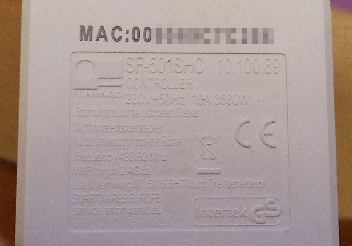

  • Intertek (Smartwares) Flamingo SF-501SHC is a socket working in Wi-Fi and 433MHz modes, with app and remote control support.
  • It can also act as a control panel for four additional SF-501PFR 433MHz sockets, which remain controllable independently by the remote control.
  • Inside sits a Lierda LSD4WF-2MD05102 microcontroller, and disassembly only needs a Y bit because the cover opens to full electronics access.
  • The socket cost less than PLN 10, but no alternative software is known, which limits its usefulness for tinkering.
  • Producer : Intertek (Smartwares)
    Model : Flamingo SF-501SHC
    Socket operating in two modes - Wifi and 433MHz (control via the application and remote control), which can act as a control panel for 4 additional 433MHz sockets (model SF-501PFR) to be able to control them also from Wifi. Additional sockets can also be controlled independently by the remote control. Bought many years ago in a shop with Chinese things for less than PLN 10 (later I bought additional sockets). Unfortunately, I do not know any alternative software, which is a pity, because it is a very interesting solution. Disassembly requires a Y bit, but it is relatively easy, because after opening the cover there is access to all electronics.
    teardown

    Microcontroller : Lierda LSD4WF-2MD05102
